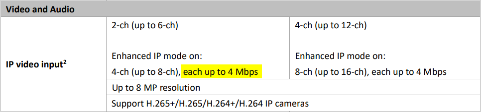

Despite the DVR stating you can connect IP cameras to it, the bandwidth capability stated in the datasheet does not look like it will be enough for this camera, as we advise allowing for around 15Mbps for these:
It may work OK for one IP camera - hopefully, somebody with more experience with hybrid DVRs can advise.

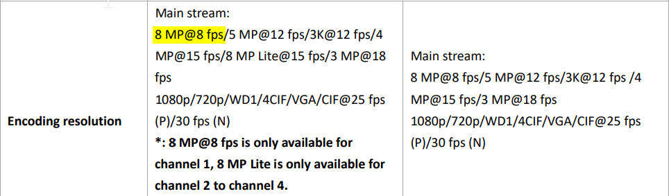

But, if the camera is set to 8MP, then the NVR will also only be able to record in 8fps:

So am guessing the camera will work but just at 8MB with 8FPS live and recording.

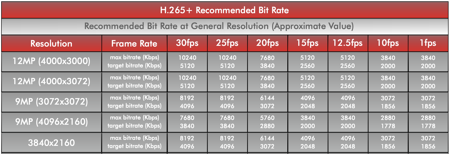

I'm not a fan of H265+ myself and always stick to H265. The recommended bit rate is shown below:
When I selected h.265+ the DVR selected 1440 rate default, this caused 1 of the 4 camera to be blacked out, but once lowered to 1024 it works fine and with play back, infact I think the picture is improved, less artifacts on each FPS, might not be the same for eveyone.
