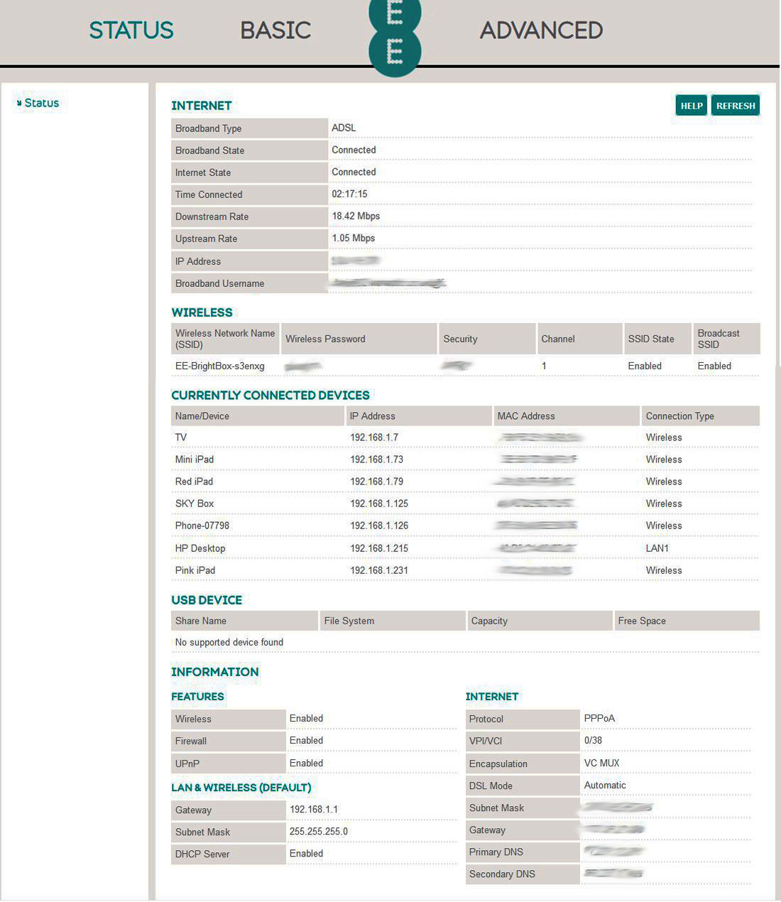

I have checked my router (EE Brightbox) and I can see that the iPads and another couple of devices are connected to it via Wi-Fi as and when they are being used and they are all working as they should with regard to gaining access to the Internet etc. but the iPads are not receiving the camera data. My desktop pc is connected to the router via cable and is named so I can see it. My NVR has a cable to the router so presumably it should also show as a LAN connected device to the router but it doesn’t.
Please see below a screen shot of the Status screen of my router. I have blurred some of the info. I am not sure what is sensitive information and what isn’t. Am I correct in thinking that the NVR should be showing as a LAN connected device and that if it was connected it would be able to transmit the images of my cameras to the iPads ? Thanks in advance to anyone who is able to help and/or advise me.
Yes the NVR should show as connected to the LAN in the currently connected devices. How is the NVR connected to the router? Directly by cable, using a WiFi extender/adaptor or by using plug in power line adaptors?

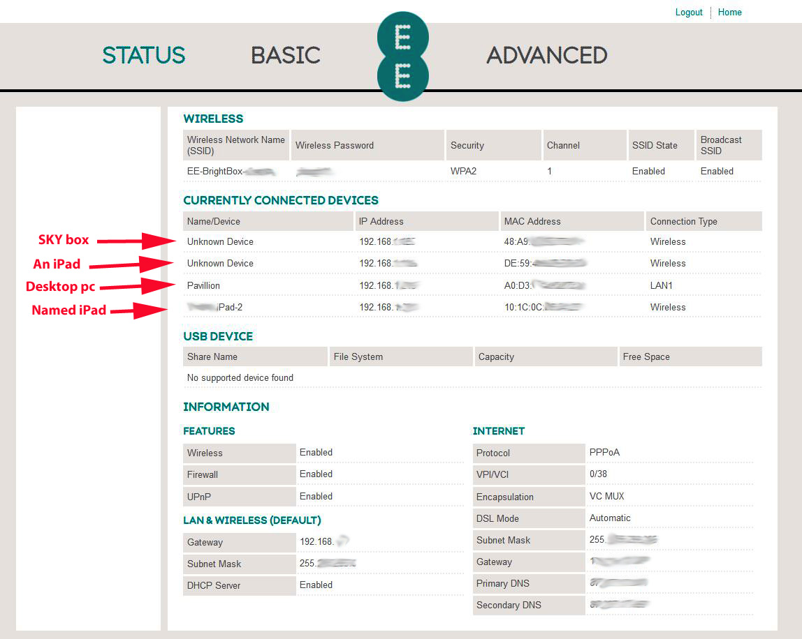

I have attached a screen shot of the router, taken this evening. I have still blurred some items out for fear of releasing sensitive information. If you need to see any of that information I presume I could PM it to you. I have learned how to name attached devices this evening which helps..

Back again. I have just swapped the new NVR/Router cable and am now using the one that worked O.K. with my old NVR but I still haven't got any lights on the relevant ports on either the NVR or the router. I changed over to a different port on the router but still no lights or connection. Nothing is showing on my router, please see the attached screen shot. I guess it's time to get into my NVR now, I think it must have been the power cuts that have corrupted something.
