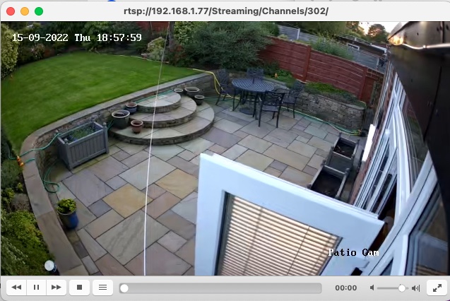

I've looked to try: rtsp://192.168.1.77/Streaming/Channels/302/ in VLC, which should be the 3rd camera, secondary (small) video stream. I get prompted for logon credentials. I run through the various ones I've got, and there we go!
The third camera (patio) showing a small video stream. So we have at last validated the RTSP streams :) Many many thanks for your input.

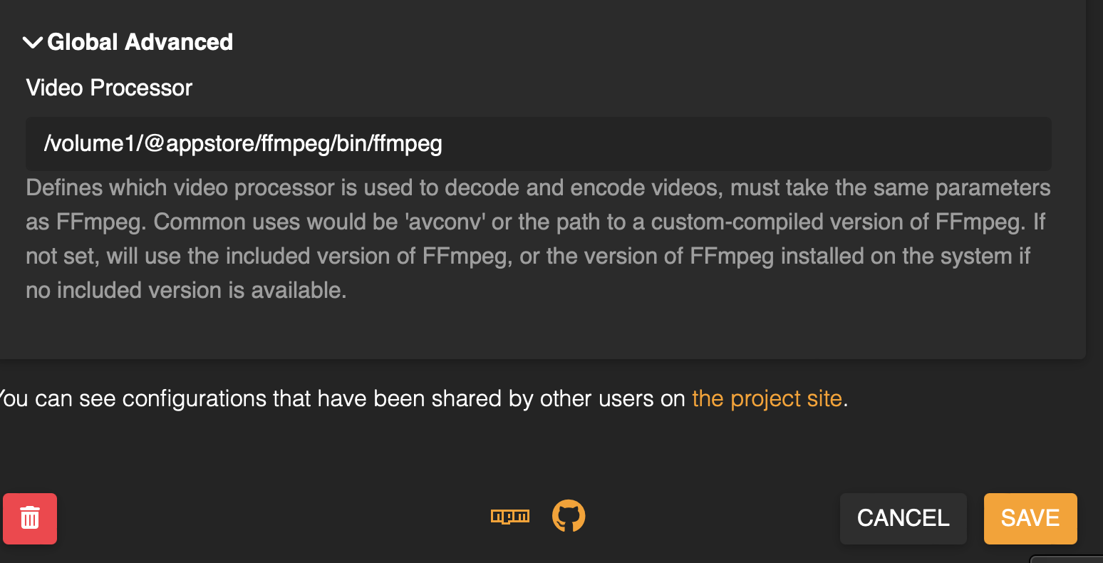

The key change which helped to make it all work was adding ffmpeg to the video decoder setting.
Installed ffmpeg from https://packages.synocommunity.com/ - This seemed to work better than the default ffmpeg in Synology Packages. This will be added to the Community Apps. You can add the community repo by going into the Package Manager Settings, and choose Package Sources and adding Synocommunity as a name and the above URL.
Then in the Homebridge FFMPeg settings / Advanced change the ffmpeg to point to the new ffmpeg Video processor.

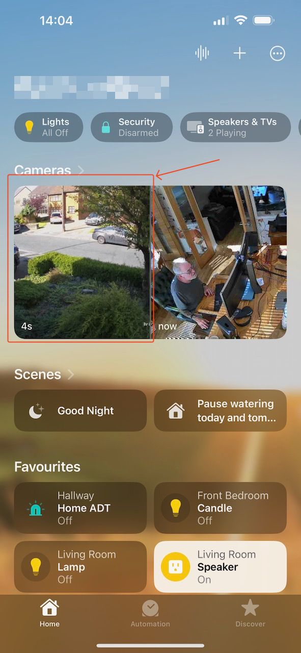

RTSP sources for me followed the following formats Direct to Camera or NVR (did not need :544 or :6500x).
-i rtsp://admin:password@192.168.x.x/Streaming/Channels/102/
the 102 works better than 101 as it seems to be more Homekit friendly :)
I also changed the resolutions and framerates to 0 so it uses the origin sizes.
I now have Ring and Hikvision on the same Cameras panel in HomeKit.

Very well pleased—the key for getting it working for myself on the native homebridge package was the video processor change in advanced settings. So I'm now runing without the overhead of having to run Docker.

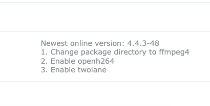

Not good news this morning there was a package update out which included a note saying:
So of course I did the update and changed the setting to:
"videoProcessor": "/volume1/@appstore/ffmpeg/bin/ffmpeg4",
And now the cameras have no video feed......... still images work but no video. Any ideas?
