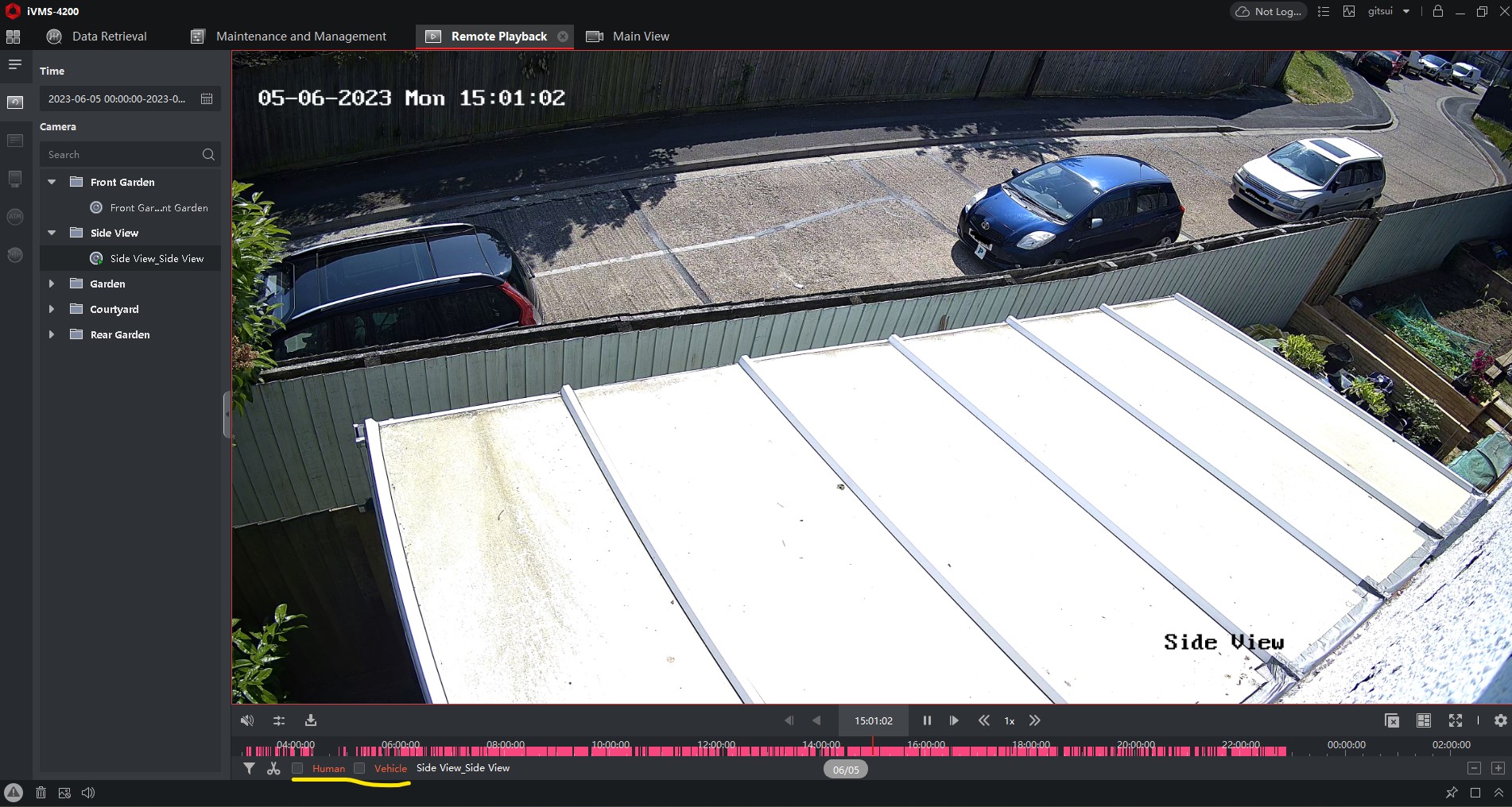

I recently had a professional install a Hikvision CCTV system a couple of months ago. He said he has installed a few but that I am the only customer that seems interested in getting the preferences set up. I have tried to work with him but wasn't really getting anywhere and resorted to my own experimentation and online research with little success. I have 4 cameras set up via a switch into my router, so I can view on my laptop on iVMS-4200 or phone. I don't have a NVR. Basically where smart events capture recordings throughout the day I want to filter these by human or vehicle but the Remote Playback options on iVMS-4200 are red and I can't use them. Does anyone know how I can get the cameras 2046G2 to filter by these events so I can view them on iVMS-4200?

Hi, I am reading off local SD cards only and can do a playback as per the picture attached, however the human/vehicle options don't work.

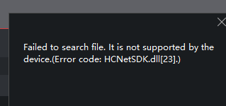

I have looked at the youtube video you supplied and when I go into event playback on my iVMS, nothing appears under motion or VCA detection. When I do try and click search in the bottom right an error message appears stating:

I think this may be a limitation of recording to microSD cards on certain cameras - could you let me know which firmware version is installed on your mini bullets, please?
I'm testing a DS-2CD2386G2-IU which is recording both to a microSD card and an NVR, with the same event configuration, and the Human/Vehicle works for the NVR but is greyed out like you're seeing for the recordings on the microSD card.
I'm going to ask Hikvision to confirm that this is correct and test some other versions of iVMS-4200 as well as other AcuSense cameras to see if this is the case with all of them, so I'll let you know what I find...

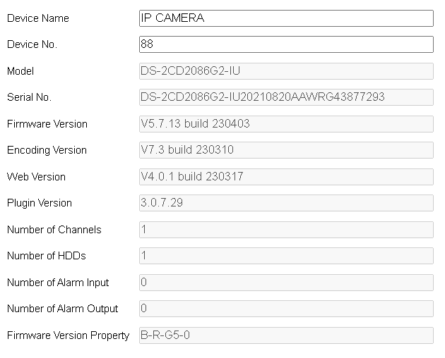

Hi, the attached should contain all relevant info, let me know if you need anything further. I appreciate you looking into this, as if it it turns out I need a NVR I will be annoyed with the fitter!
Thanks for the screenshot, it's greyed out for me on that same firmware, as well as on other Acusense cameras, and on multiple versions of iVMS-4200.
I'm still waiting to hear back from Hikvision, but my guess is that this filter only works on NVRs.
Hikvision has confirmed that the human and vehicle filtering during playback only works on NVRs in iVMS-4200, sorry to bring bad news!

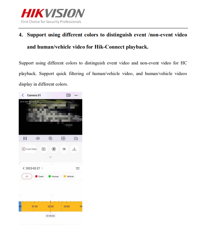

Yesterday i found that my NVR has a new firmware release - V4.74.200 build 230522. I have updated the NVR.
The one thing that i love the most from the release notes is the following:
"4. Support using different colors to distinguish event /non-event video
and human/vehicle video for Hik-Connect playback.
Support using different colors to distinguish event video and non-event video for HC
playback. Support quick filtering of human/vehicle video, and human/vehicle videos
display in different colors. "
Unfortunately i have checked my events and there is no such filter as it is shown in the release notes screenshot.
Not sure what should i do add it.
When i am locally and checking the events from the NVR i can filter - human/vehicle events( they are with different colors as well).
But when i open the Hik-Connect app playback there is no such filter.

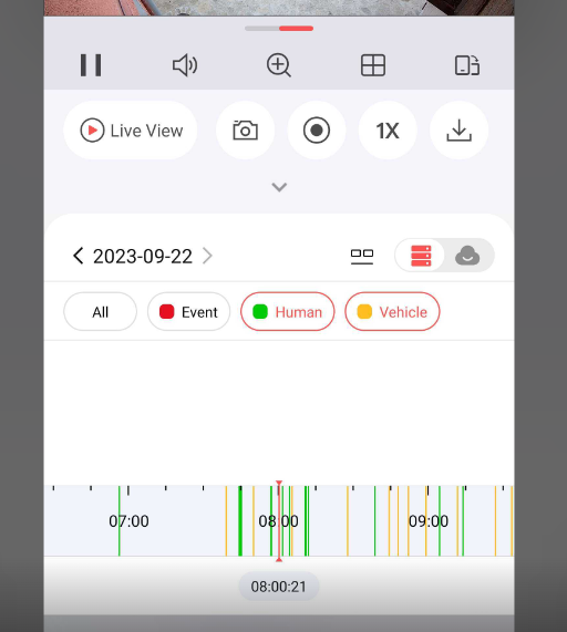

Just an update. I have downloaded the latest Hik-connect version from the official website of Hikvision and installed in on the phone - Version: 5.3.2.0822. Still the same. No changes.
An update to all who are following this. I have updated my Hik-connect to Version: 5.4.0.0911 a few days ago and today when i woke up i looked at some playback and there it is. The feature was released:
