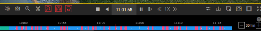

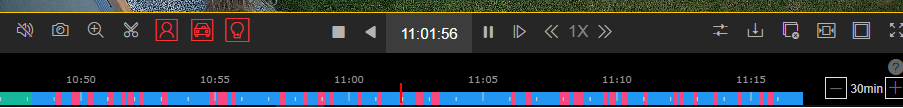

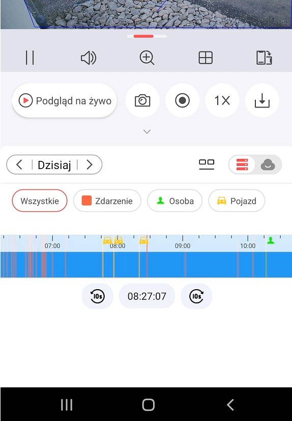

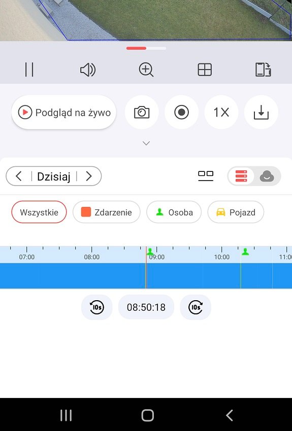

I updated my 2347g2-l camera to the latest firmware. In the HikConnect app, the camera no longer highlights the movement of non-human objects on the timeline (the old firmware worked correctly). The human is highlighted in green, but there are no red lines, such as for cats or deer. The 2347g2h-lisu/sl have the same firmware and everything is set up identically. The timeline is blue, the image change movement is red, the human is green, and the vehicle is yellow. The latest firmware is available, V5.7.19_241207.
Can anyone help me?
photos for comparison

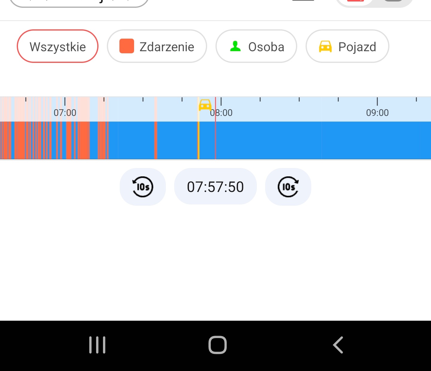

It works in both the NVR and Hikconnect. The previous software worked a bit differently. If I set up AcuSearch, dual VCA, and the VCA smart event configuration, if REGULAR events were also enabled, they were automatically excluded and disabled. The new software doesn't work that way. If VCA smart motion detection is enabled, the DYNAMIC MOTION ANALYSIS detection in the "Events and Detection" section must be set to off. Otherwise, neither the NVR nor Hikconnect will mark events other than people or cars.
Now, rain, squirrels, car lights and movement, and birds are marked as OTHER events. In my case, only people and vehicles trigger an alarm and are also marked.
