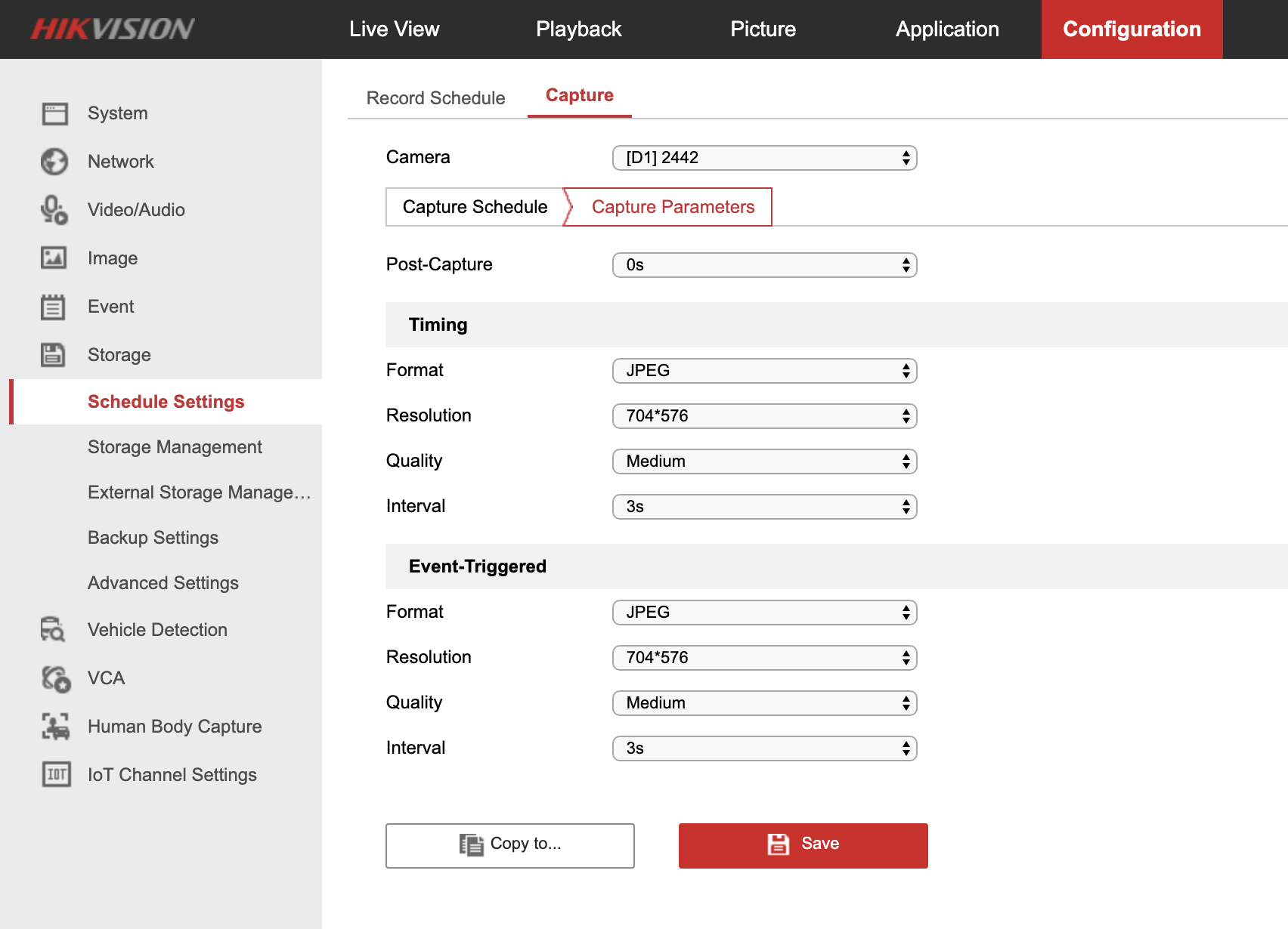

In the mean time would it be possible to reduce the snapshot size? ... I've had a look and can't see where this is set.
