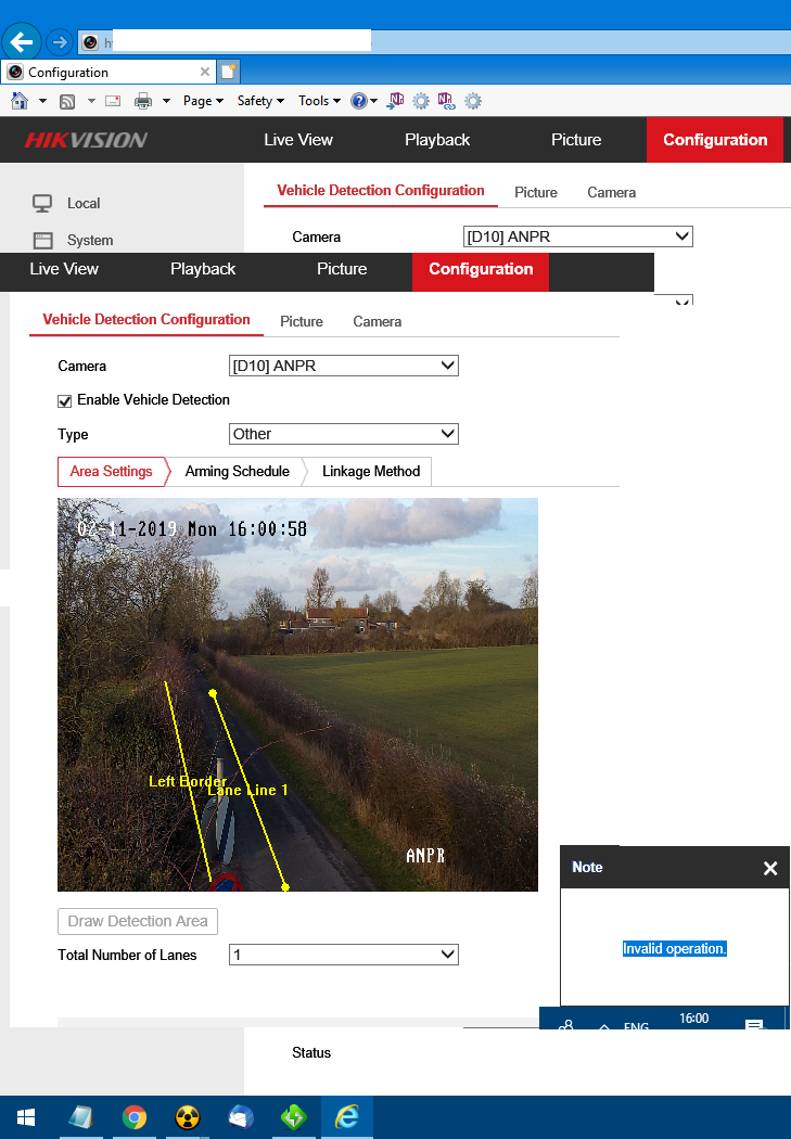

One last question please. It doesn't seem to link into my NVR 7732 very good. I can edit stuff directly on the camera (But i have no SD card in it) So its not actually saving when i enable vehicle detection.
When i edit the Road Trafic on the NVR it doesn't save and says error.

I've tried using Internet Explorer connecting to the NVR when i set Road Traffic Detection on it just never saves after clicking save.
I've tried internet explorer to the Virtual IP for Camera. Same problem.
Also I've IVMS-4200 client on windows 10. This gives error when clicking save.
NVR is on V4.1.54 build 180621
IPC Camera V5.4.5 build 170302

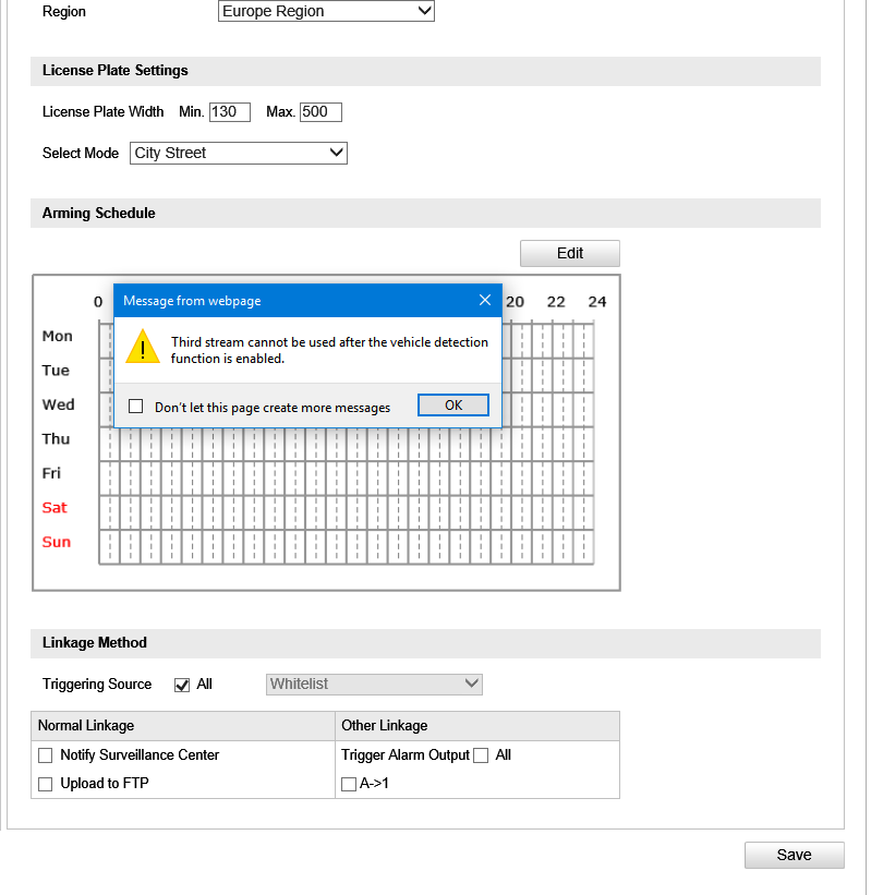

Just updated the firmware on the NVR to 4.1.64.
Using Internet Explorer Please see screen shots.
One is directly connected to the camera and the other is through the NVR
I do notice it says something about Third Stream but i can't find out how to turn that off.

Hi,
I'm sorry, I'm running out of day now.
A quick look at your scene, and you are not going to get on very well capturing number plates within that scene.
You need to adjust the camera to fill the screen with more of the oncoming vehicles.
Probably angle down and zoom-in:
It's just telling you that if you configure and use its ANPR capability, then you cannot also use a third video stream.
It's just notifying you.
