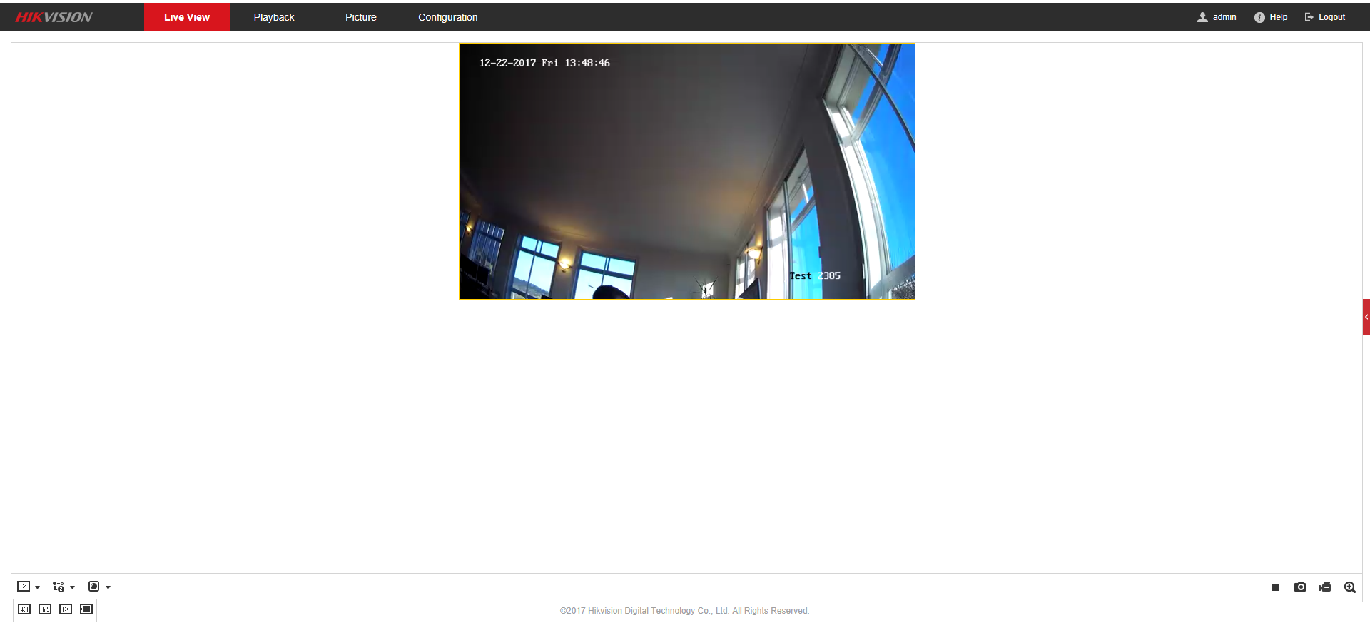

Hi, I'm not seeing this.
You might just be seeing the OSD scaled-up?
Your sub-stream image is probably pretty small by default - select the '1X' full-size view at the bottom left of your screen.

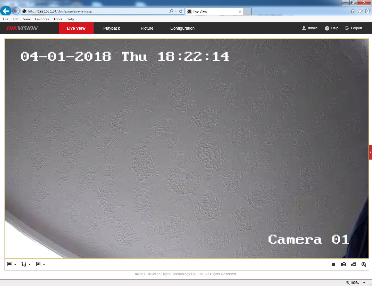

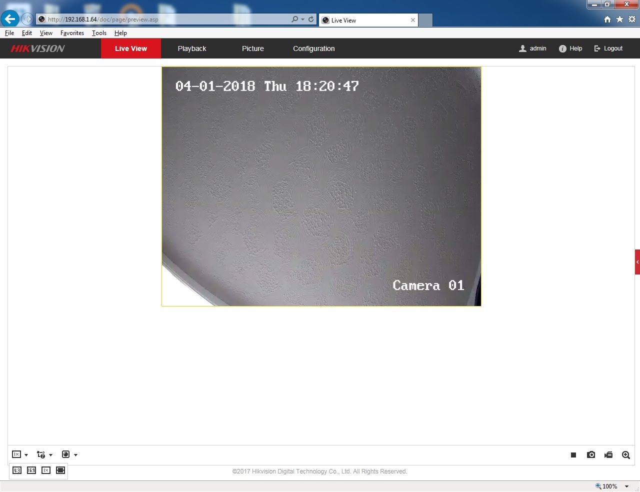

I've tried this on a brand new out of the box camera today. Not connected to an NVR just connecting to the camera directly. As soon as I changed the OSD date format to DD-MM-YY the sub-stream font went big. Even after doing a factory reset (from the menu not the onboard switch) the font remained large. I will have to downgrade to V5.5.0 in order to return the font to original size.

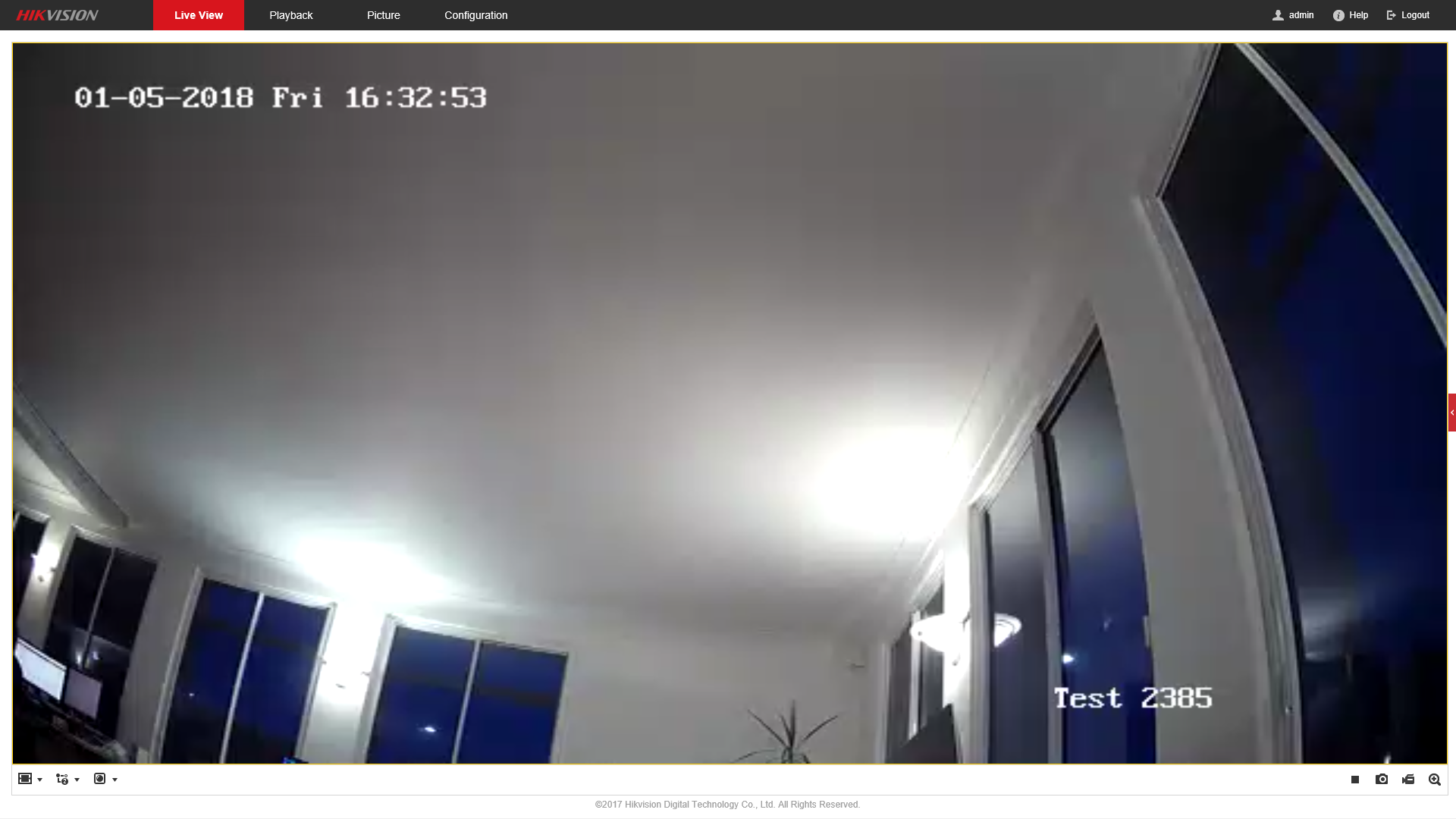

I'm sorry, I can't replicate this.
The below attached is the sub-stream from a 2385 turret running V5.5.3.
