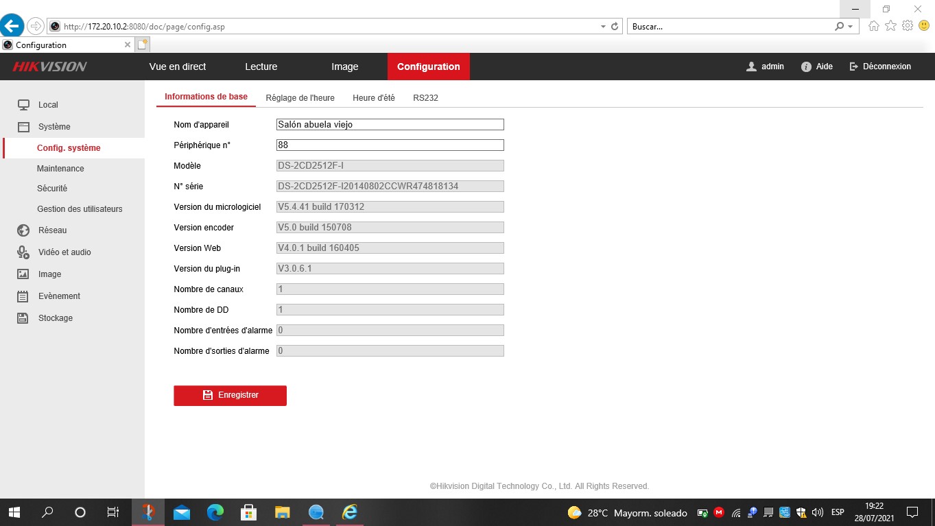

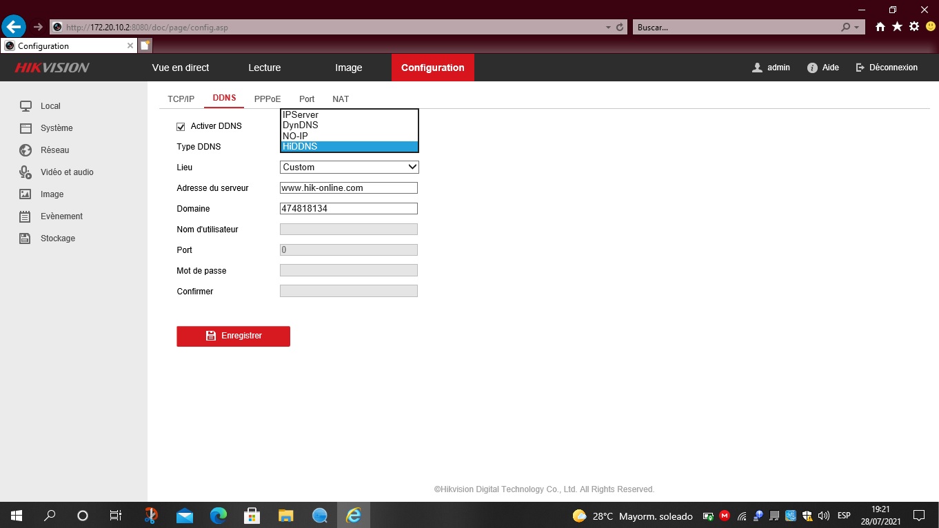

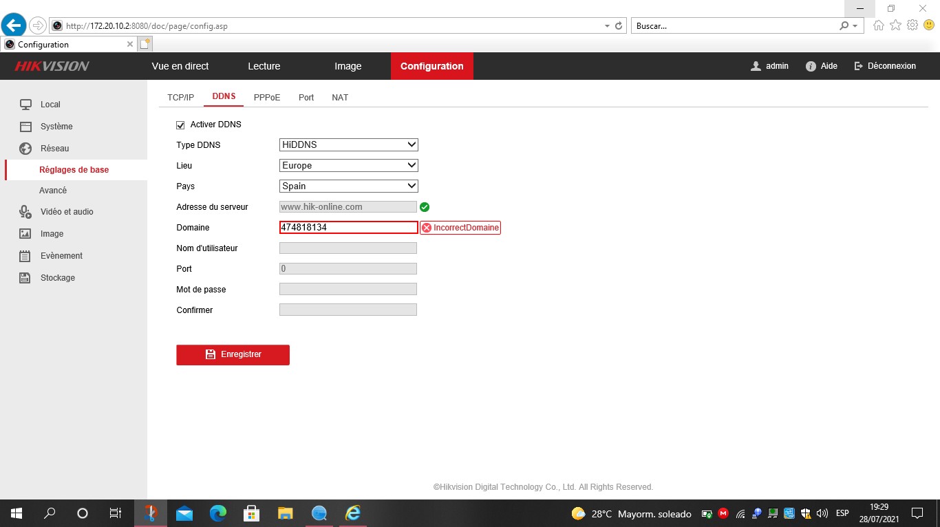

Hi! I upgraded the firmware to the lastest version wishing that I could enable Hik-Connect function. When I have done this, I still have the same issue. There's no Hik-connect option. So, I decided to enable HiDDNS and I couldn't. This camera is connected to a wireless repeater (the repeater repeats the signal from a mobile data phone Wi-Fi connection). What I want is to be able to watch the camera when I'm not at home. Here I'll attach you some screenshots. If you could help me It would be very good Thanks.

Hi @AntonioPS
Your camera is from an old range (2xx2F models date back to 2013) that stopped receiving updates/support before Hik-Connect became the go-to option for remote access.
For older cameras like this, we would recommend Port Forwarding as the simplest way to access your camera remotely.
