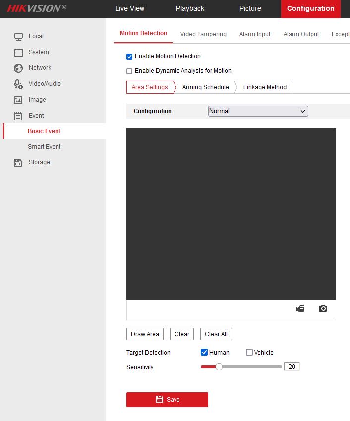

I have 3 of these cameras: DS-2CD2347G2-LSU/SL
So far I'm only using basic detection. I specify target detection to be human. Things were going well with the sensitivity set to 60 but then I noticed one day, the camera detected a bird (a magpie). So I reduced the sensitivity to 40 and realised it was still doing it, further reduced to 20 and it feels like it's getting worse not better!
This is a bit pants, it's clearly not detecting humans but a bird which is occupying probably <5% of the total camera image. Do I need to move on to Smart Events now? That would be a shame because I have several other models of Hikvision and they seem to be handling the "human" detection at threshold 60 just fine! Thoughts?

Thank you Kyle. Since then I have discovered that any Basic/Smart detection you configure via the Hik-Connect app is unreliable. There seems to be a difference in the way the detection algorithms are written to the device based on the configuration tool. I now configure everything directly via the web interface. So far perfect.

I rely purely on the built-in camera detection algorithms. These latest cameras seem to have a lot of onboard processing. Currenly no NVR. I was gonna go full hardcore with a Blue Iris set up but have since decided on local SD card recording (don't laugh, it all works wonderfully).
When I first bought them, I enrolled them into the app using the QR-Code (not as local devices). I then decided to configure all other settings via the web interface including Basic Events. At some stage I began to tinker with the drawn areas via the app. And that's when my issues began to occur.
I have since then disabled/deleted any area, sensitivity and notification definitions from within the app (of course, after that they no longer show via the web interface too). Thereafter, I have redefined the notifications, areas and sensitivities entirely from the web interface. They are still translated and displayed in the app but there are differences (for example, a 5 point shape drawn in the web interface shows up as a simple rectangle in the app). I can view but as long as I don't then EDIT anything in the app I'm good (seems the web defined stuff rules). I hope that all makes sense?

Local SD recording is great :) I only thought you may have been using an NVR because a quick look at your screenshot looks similar to the NVR web interface!
