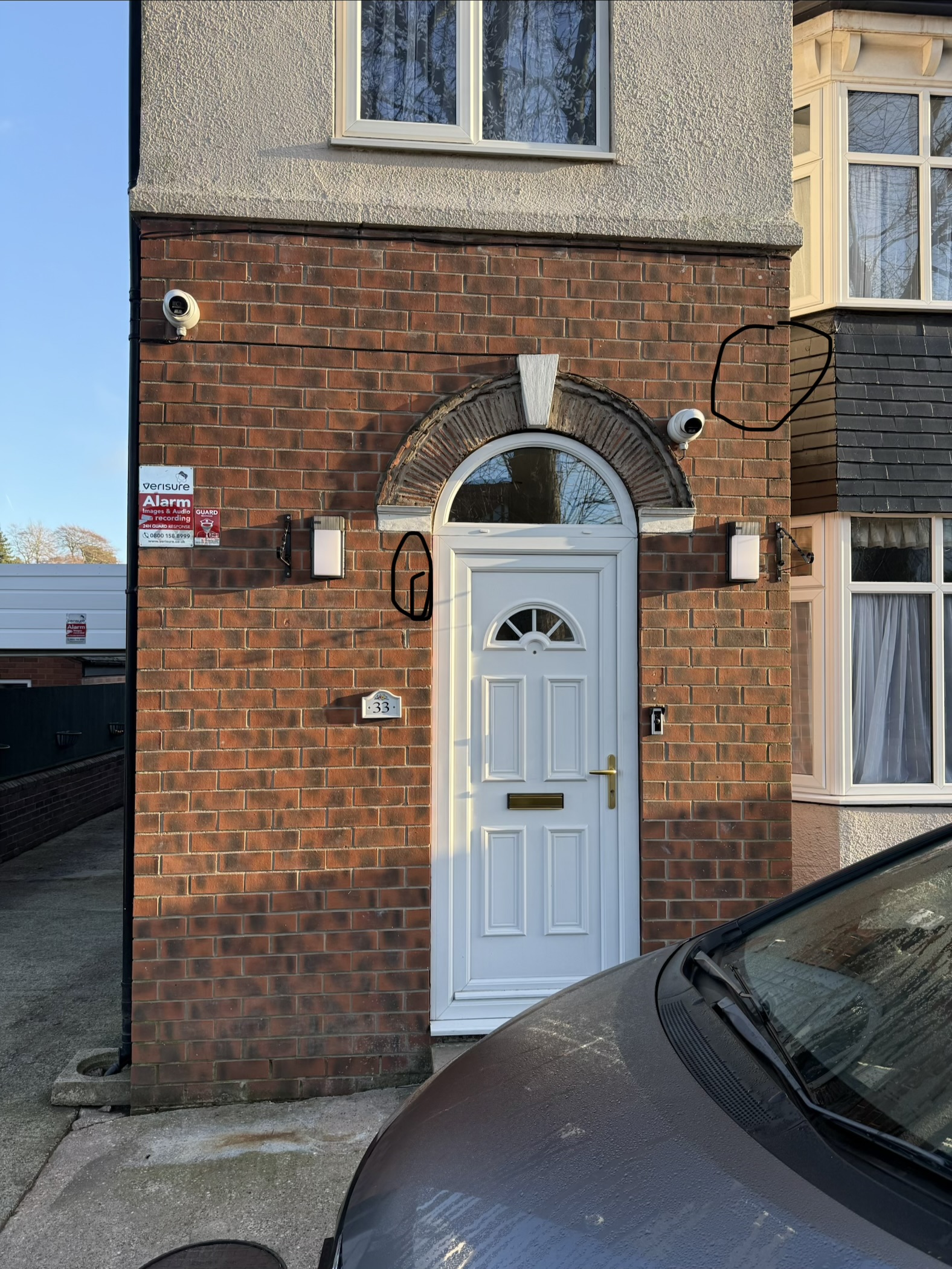

If you don’t mind I’ve attached a pic of my current camera set up at the front door. The low down camera on the right I had intended for it to focus on the front door. In reality it’s too high and probably the wrong focal lens im therefore mostly getting tops of heads. Or an image in one specific part in relation to the front door.
I’m thinking to change this per the picture attached and put the cameras where the circles are. Do you think it will work?
For the front door Im planning to go with a DS-2CD2H87G3-LIZS2UY (Black) which I think is a 8mp colour vu motorised varifocal black camera.
And for the top right another 2.8mm 8mp colurvu to match the one on the left
I think varifocal will work well for the front door so I can dial in the focal to exactly what I need.

When you're so close to the front door you shouldn't need a vari-focal; it's the one time I'd usually use a 2.8mm over a 4mm.
One thing regarding your installation...If you're mounting directly to brickwork like you have there, remove and throw away the big ugly compression gland from the bottom, replacing it with the blank that's in the back of the box. If you then mount the box so that it's over a horizontal mortar line, it's usually concave enough for the CAT5E to pass behind the box without squishing it. If not you can just scrape a little mortar out under the box - it looks neater.

Regarding the front door camera where I have it now it’s a 2.8mm and people see far away. That was my thinking for going varifocal.
I also plan to lower it so I capture faces as people come on tk my property
I meant to say with the current 2.8mm people seem far away. To get good detail you have to zoom in but because it’s digital zoom the quality gets lost
That's just lens perspective. Wide angle lenses will make objects appear smaller and more distant to one another whereas a narrower angle will compress that perspective. If you're installing a camera and want to see a person fully when stood at your door you need a 2.8mm lens. The side effect is that they'll look tiny at the edge of the driveway. There's nothing you can do about that. If you get a varifocal, you'll probably end up using it fully wide so it'll be a waste.

2.8mm is what I’ll go for then.
I plan to have 2 cameras high up that will give me a full view of the drive.
In terms of a front door camera, how high do you recommend mounting them? I’m not that bothered if it could be tampered with. Should that happen I’ve got the other 2 cameras watching
2.8mm is what you'll likely need for the front door if you're wanting to see someone stood at the door.
Those wouldn't need to be 2.8mm. A 4mm gives a 95 degree horizontal field of view so will capture everything. Perhaps consider a vari-focal there if you're wanting to see something larger in view (at the expense of 'a full view'). A wide view you're going to capture everything but it's going to look small. A narrow view you're going to see things larger but you're not going to see it all (decide what you need)
Wherever suits, probably about 8'. You don't want the camera to be looking straight out without any tilt. If you get the sky in view you'll have times of day when glare will cause issues indoor image. You may be restricted by the position of your lights as they could cause glare if they're in the cameras view.
