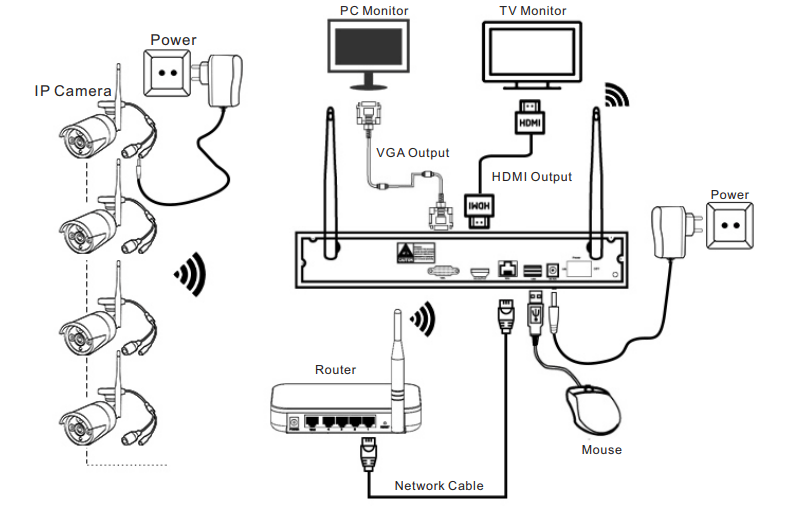

The DVR is in a tight spot to get a photo but here is the photo from the manual, which is identical to what I have:
Following Dan's instructions, the main problem I have is that I don't know whether I am finding the cameras though WIFI or ethernet when I add it again. I wish the software made it clearer!
J

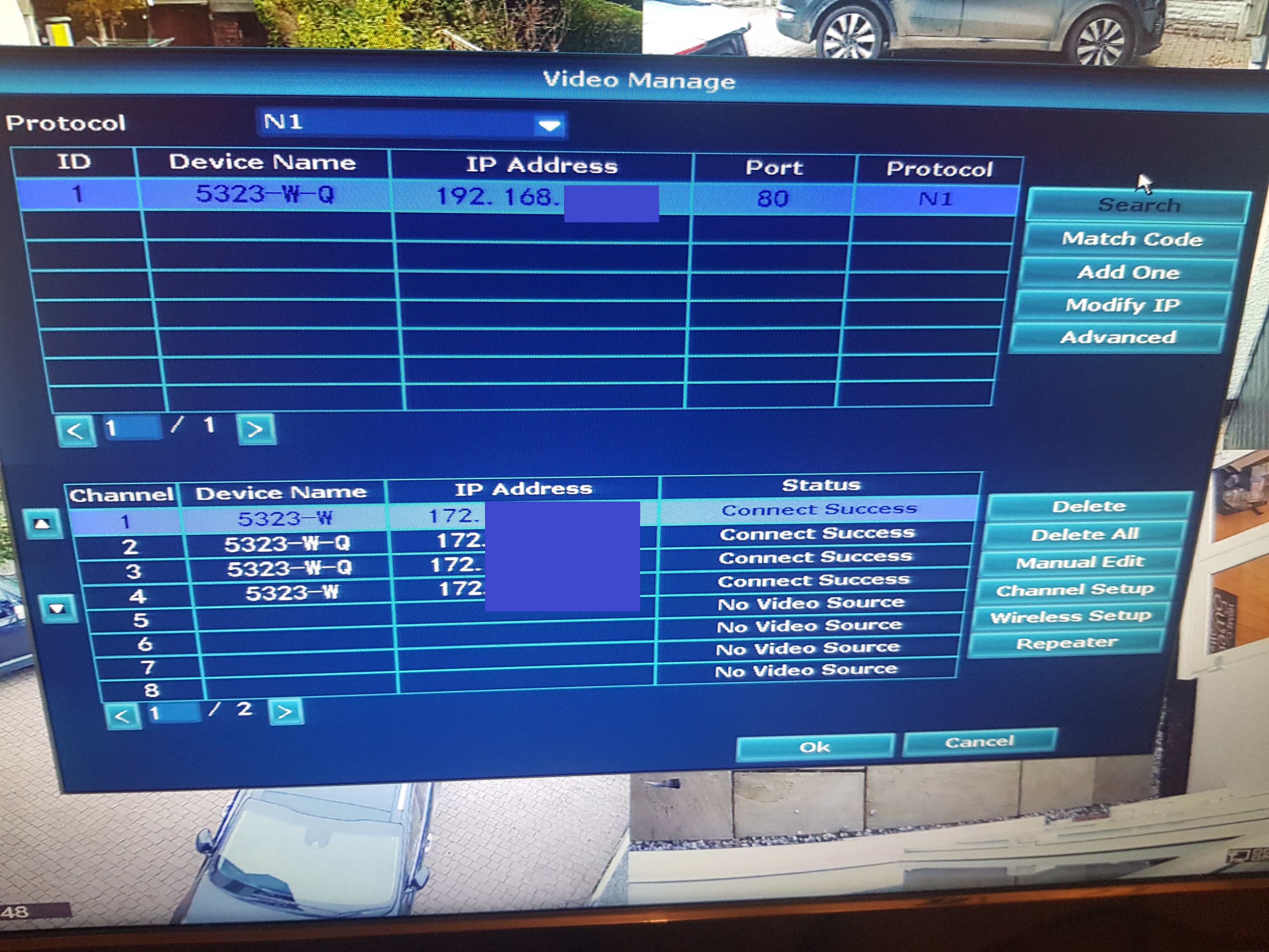

Could you post a screenshot of the NVR camera connection setup page?

David, the router is a Sky Q Hub SR203UK. I've connected only one of the cameras to it via ethernet now. Removing or reconnecting them seems to make no difference to the NVR page, the only thing that makes them disconnect is turning off the camera's power supply.
Here's the NVR set up page:

If the camera is still connected to the NVR wifi network and your router ethernet port there may be a port conflict within the camera. For testing I would factory reset one camera or find a way to disconnect it from the NVR wifi network.
on the 172.nnn IP address what is the nnn number?
What is the full 192.168. IP address? This address is private to your local network.

Sorry for the delayed reply. I have managed to fix it by fluke.
When I was re-adding the camera I noticed and unchecked 'don't show duplicate hardware' in the advanced settings and then I could see the camera twice.
Then after a bit of trial and error unplugging the ethernet cable etc... I managed to work out which was the WiFi and which was wired. I could have kept both but this seemed like a waste of storage.
