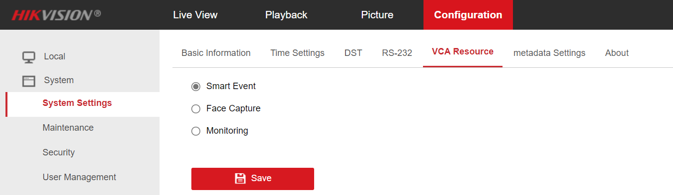

What is the full model number of your NVR please? If it's a Deepinmind model with "face recognition", it will do this, and that technology is built into the NVR, so you should also be able to use the camera's intrusion detection (you may need to log into it directly and change the "VCA resource" to "Smart Event").

Then, you should be able to use facial recognition by using the NVR's built-in analytics, and the line crossing using the smart event capabilities built into the camera:
  1. In a web browser, go to Configuration>System>VCA Configuration>Engine Configuration, and make sure the Mode is set to Facial Recognition.
  2. Set up the facial recognition on the camera.
  3. Go to your smart event settings, and make sure that Enable AI by Device is disabled, which means that the camera's built-in AI will be used - this should allow you to set up the smart events.

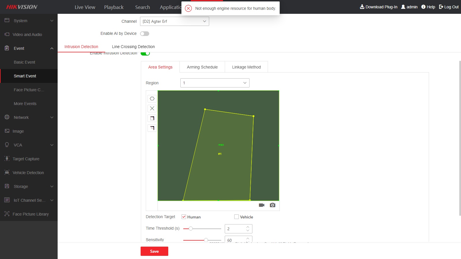

Hi Kyle,
Thanks for the help but I am still stuck. I have attached a screenshot of the error that I am receiving. As I understand it there is no resources on the camera to determine between human or not, and on the basic event motion there is also no tick box for human detection.
Please help as this nvr is making me crazy, I even tried changing the engine mode to perimeter protection and then i enabled the ai by device but still i am getting false alarms of dogs and sheep and not only human.
