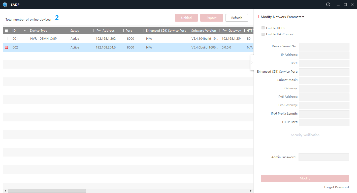

I have been using a program called IP camera viewer 4.09. It doesn't normally have any problem in finding the IP camera. However, ever since I plugged the IP camera into my HiLook DVR and then back into my POE adapter I can't get the camera to work. I plugged the camera back into the DVR last night and it's working perfectly okay. I put it back into the adapter this morning, no picture. I'm no computer expert but I'm wondering if the DVR has somehow messed around with the IP address.If you look at the screenshot both the DVR and the camera appeared to be on the same port. I'm sure this isn't right
I've included a screenshot as requested

The problem is that when you connect the device remotely to PoE switch the camera is on your local network but as you can see from the above screenshot your camera is still using a subnet IP address (192.168.254.xxx) which cannot be accessed from your local network range. (192.168.1.xxx)
You need to select the device in SADP by ticking the box on the left, then tick Enable DHCP on the right and enter the admin password before clicking Modify. Once it says that modification is successful you should see the IP address of the device change to match the network range and if it does then you can untick DHCP and click modify again. (doing this makes IP address fixed and stops it changing using DHCP when the device reboots or shuts down)

You won't be able to share the individual camera feeds of cameras that are directly connected. If you reconnect the camera to your local network using a PoE Injector or Switch and you can see it SADP you should be able to manually change the IP address in SADP using the password it was assigned when you first plugged it into the DVR. (This will be the old DVR password, not the new one you have just set) If you change the cameras IP address to one that is within your local range (e.g. 192.168.1.200 / 192.168.1.180 / etc...) and then you can enter that new IP address into a browser to login to the device.
If you don't know the old DVR password and thus don't know the password to change the cameras IP address your only option would be to find a way to hard reset that camera back to factory settings, doing this should default the camera to inactive and give it a generic IP address on your local range. (This option will only be possible if the camera supports a hard reset button)
