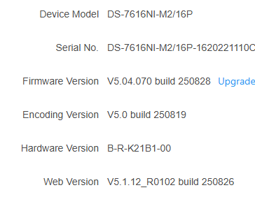

New firmware is available on Global EN and UK&IE EN DS-7616NI-M2/16P product pages (not on USA EN). No release notes.
DS-7616NI-M2/16P

So I've upgraded from V5.04.066 build 250620 to v5.04.070 to 250828 and through both chrome and IE I was struggling to see the live view - IE did open a camera but complained about memory issues. Could be a the web services plug in that needs an update.

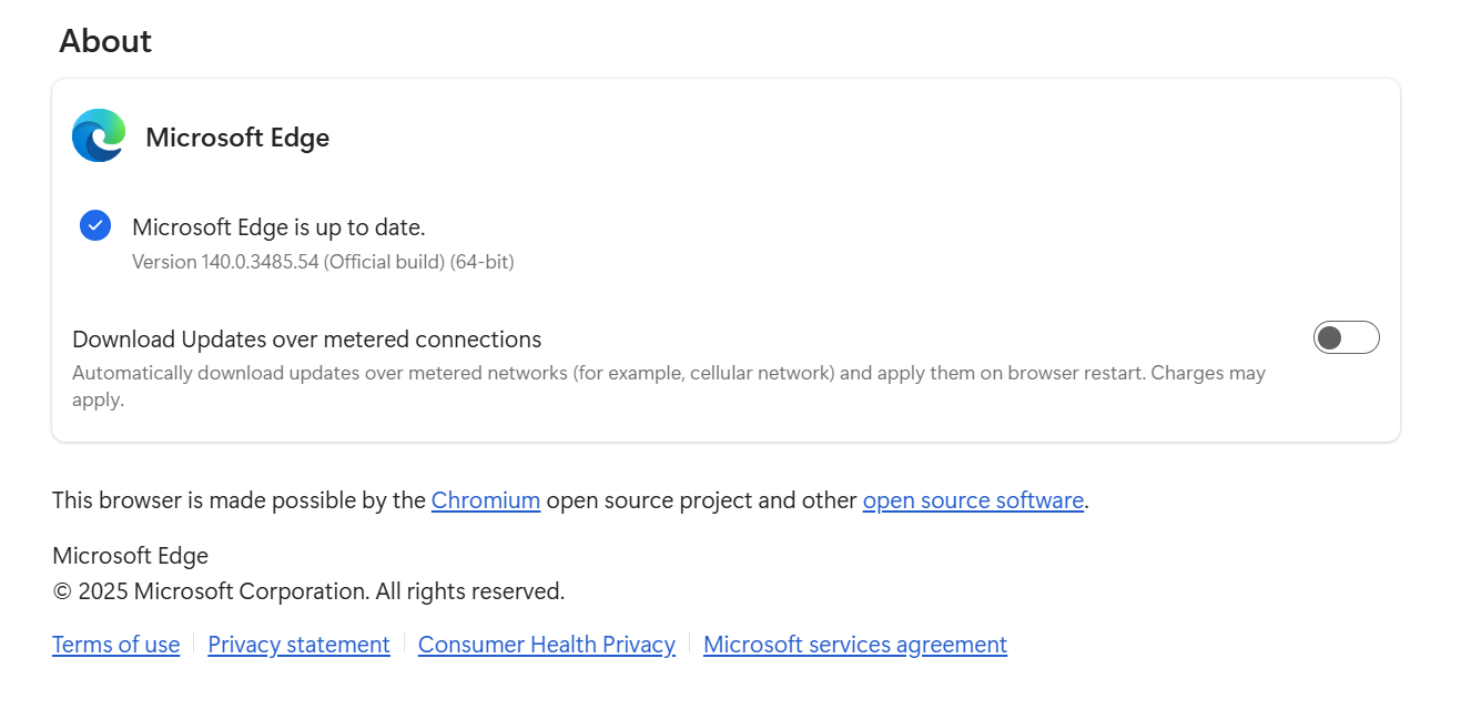

I'm certain that when I installed the new firmware last Wednesday (5 days ago) the live view in the Edge browser I have been using still worked... have been gone for a few days, seen this thread, checked, and I now have the same problem... no live view in Edge browser... I notice that I also cannot view each camera's live view (direct on camera web page) in the browser either (again this was working after I initially updated the NVR firmware) ...
I did notice that my Edge browser installed an update while I gone... I wonder if that had something to do with this?

I don't think it was the M-series firmware update that caused this... I think it was the Edge update that caused this? But I can't seem to find a page that shows MS Edge update history?

I have a DS-7608NI-M2/8P firmware V5.03.000 build 250210 and also just lost live view/playback/event view on Edge. Internet explorer mode in Edge still works. I think it's an MS Edge browser update that caused it. Not sure how Hik will fix this if Microsoft's update is correct/expected. It will likely have resulted in most M series NVR's not able to function correctly on Edge.
That pretty much confirms for us that it was the MS Edge browser update that caused this issue... I was able to get Edge working again by reloading "Local Service Control" and "Web Plugin Components", but that has not worked for @busterboy ...

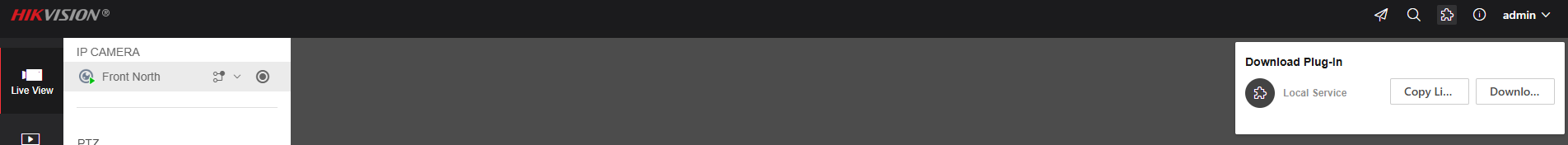

I think that is when the NVR GUI live view started working, but the individual camera GUI live views (though virtual host) were still not working until I used "Download plugin " on one of the cameras here:
