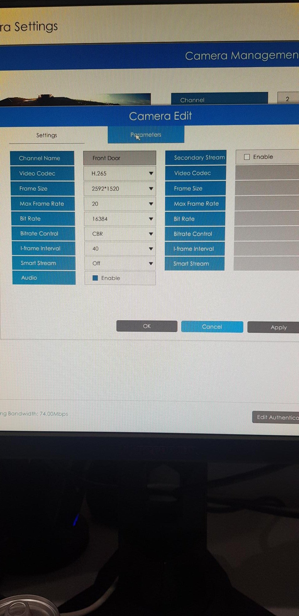

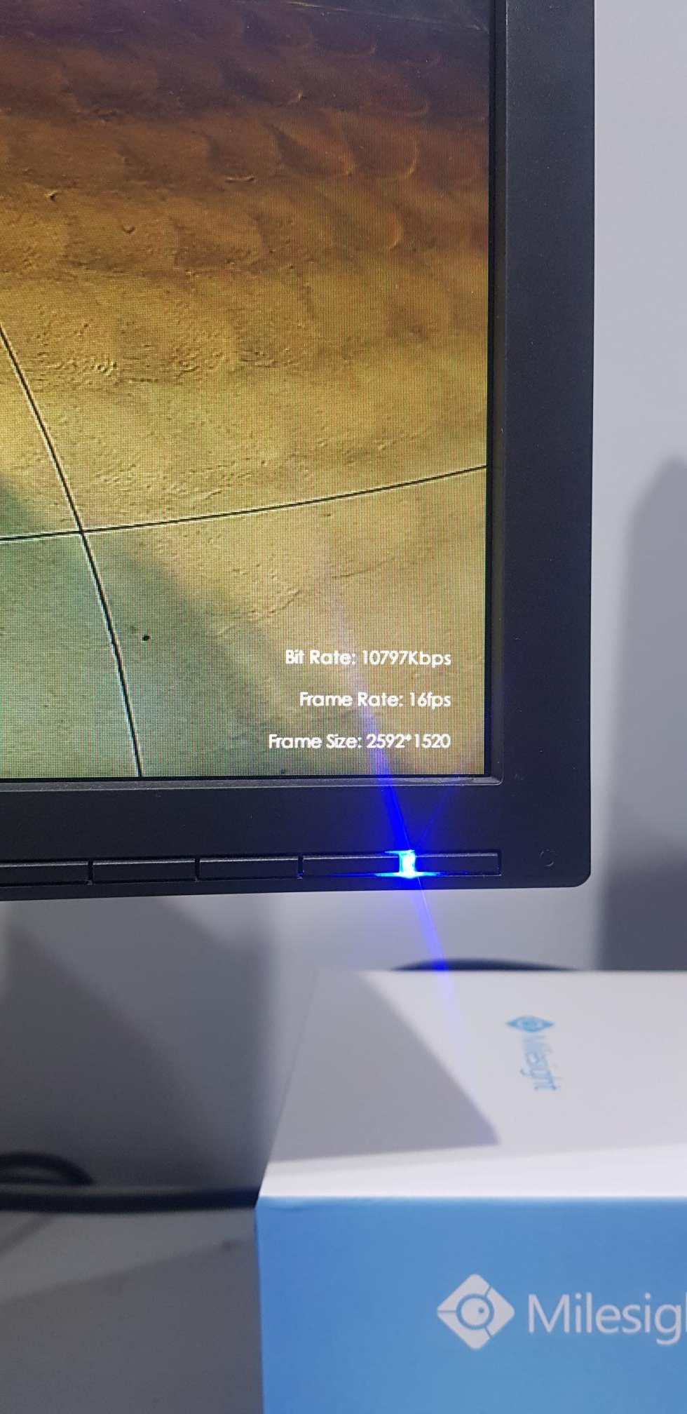

How the camera has stutter. When I look at my NVR directly and my 1 camera the feed stutters. I can't figure out why?
The photos of my settings are attached. It looks like the FPS drops.
I have tried lowering my bit rate and MP and there is still a stutter also in the recorded footage when I look back.

I have seen some unpredictability in the frame rates. 16 fps should be running smooth. Perhaps there is still some configurations to be done in your network.

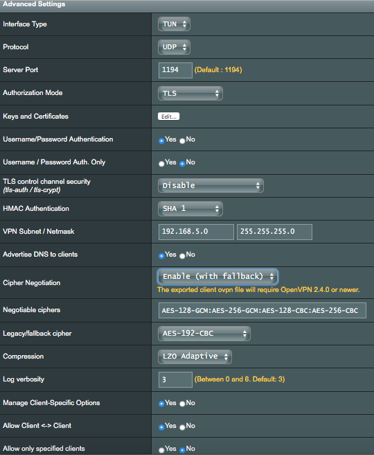

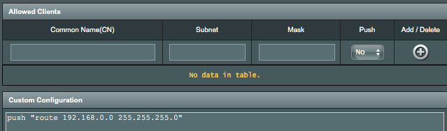

Wow - you chose a piece of the future. AX is beyond my current experience. However - most of the connecting devices today use AC and N standards so it could be better to configure it as an AC router. Seeing it supported by Merlin gives some guarantee of maturity. (some earlier models with their standard firmwares often needed a couple of upgrades after initial releases before OpenVPN was free of bugs)
You did not yet describe the client setup on the phone. As far as I know, e.g. Android and IOS don't have native support for OpenVPN. OpenVPN Connect works in both environments.
If you have all settings correctly in place then you should be able to create the VPN tunnel from the phone via the cellular network and access your cameras etc. at the same local addresses as you use while being logged into your home network.
Be prepared for some experimentation with the settings.
Here are my settings as an example. The version of Merlin is 384.8_2.
