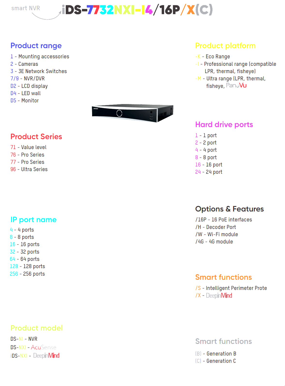

You'd be best downloading the data sheets for the models or using the compare tool on Hikvision's website, as unlike the cameras, the NVR model lettering doesn't tell you everything. That being said, a few pointers:
- NI or NXI - The NXI models have AcuSense processing in the recorder. It's not as flexible as it is on the cameras, but allows you to use AcuSense on older camera that don't have it. If you'll be using all AcuSense cameras, you won't need it; however it's now standard on some ranges and unavailable without it
- /xP - PoE model - x denotes the number of PoE ports
- The number after the K, I, or Q (1,2 or 4) is the number of SATA interfaces/how many disks you can install inside the unit
- The 7708 is a higher range than the 7608
- (C) - is just hardware revision. The hardware (and firmware) has changed but the model number remains the same.
- K, I, Q - the model series. The I series would be the best of those. The Q series is newer than the K, but I can't comment on performance etc as it's not available in our market (UK)
This may also help:
Thank you!
Reading topics from the forum and datasheets from Hikvision, I'm slowly getting into the subject of video surveillance :)
