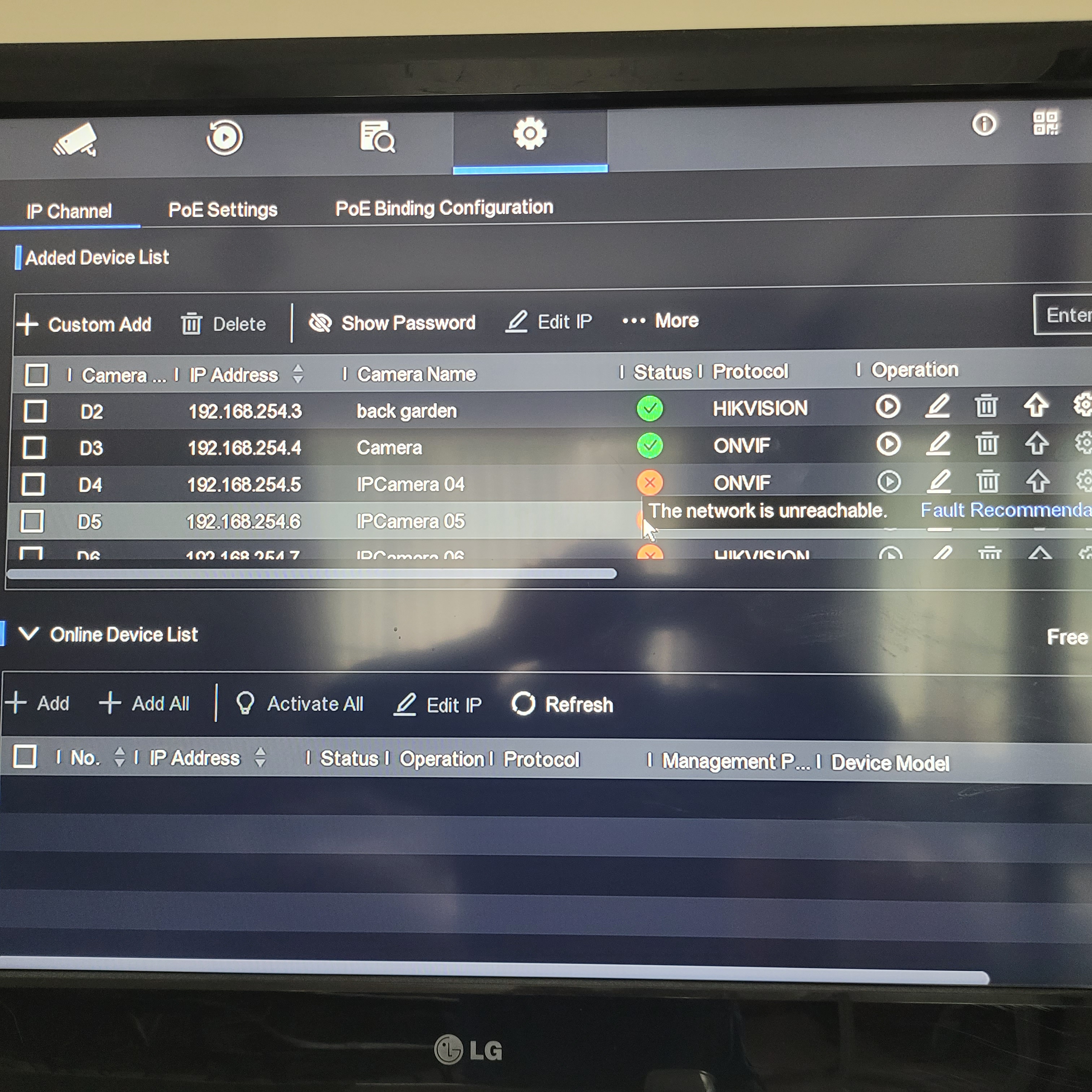

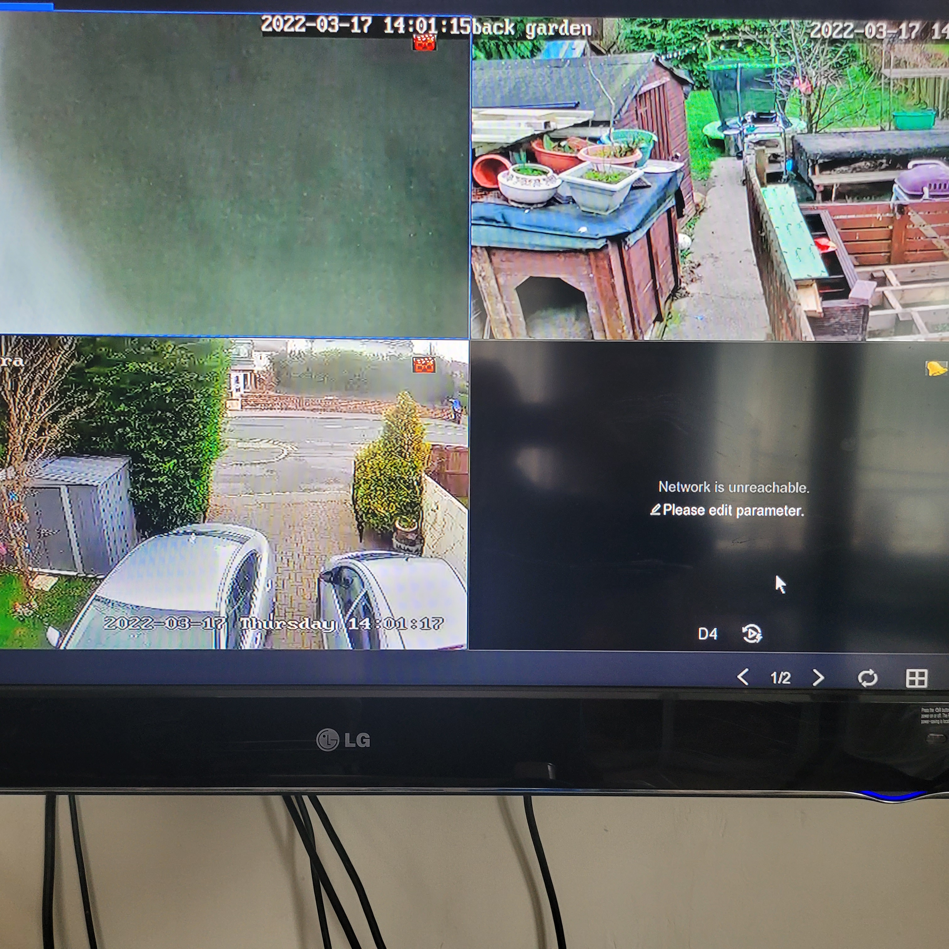

Since changing my NVR I can only access the two new cameras, the 3 I had previously my new NVR picks them up but with a message saying network is unreachable please edit parameter . However when them 3 are plugged back into the old NVR they work and pick up fine.

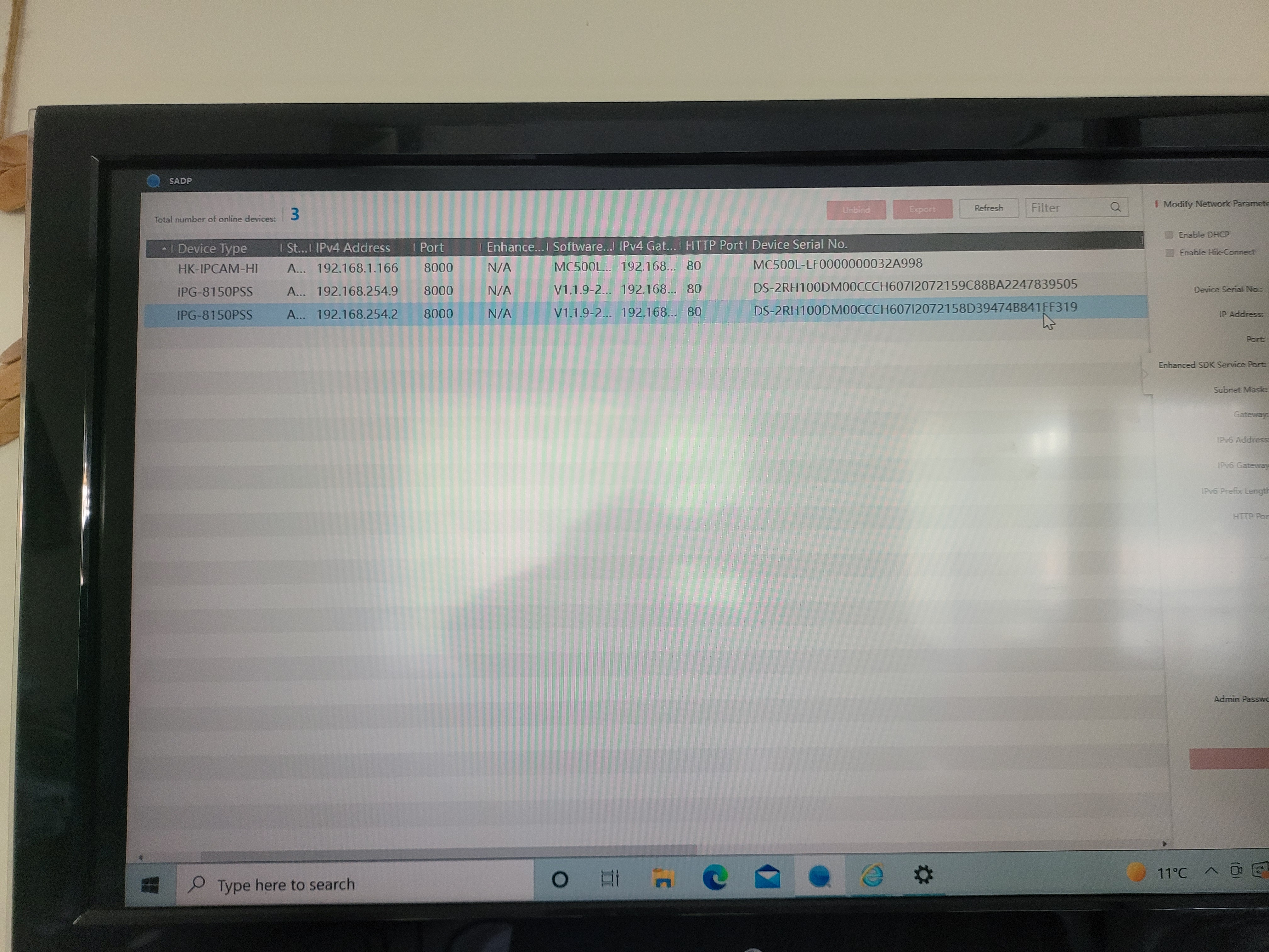

on the old nvr i used a poe injector (4 ports) for 3 cameras then a cat 6 cable to the nvr, with network cable to nvr, on the new nvr i connected the 3 old and 2 new cameras to ports on the nvr and network cable to nvr , they all said connected but only the 2 new cameras had a video, attached is a photo when i connected 2old cameras and 2 new cameras to poe injector the adress192.168.1.166 is one of the old cameras the other 2 are new cameras i have tried to change the 2new camera addresses but get message saying timed out, the2 new cameras won't connect to the web 20220315_100129.jpg

Ok, you had a very strange setup with the previous NVR but I think I understand what is going on.
Somehow you had the 3 old cameras connected directly to the NVR via a PoE switch but set to your local network IP range (192.168.1.xxx), I assume you probably did this by plugging the switch into the NVR LAN port rather than the PoE ports.
But now on the new NVR, you want to plug all the cameras directly into PoE ports. When plugged into the PoE ports on the NVR the cameras need to use the NVRs subnet IP range (192.168.254.xxx), this IP range is not visible outside of the NVR which is why you can't log in to the 2 new cameras from your local network. (If you enable Virtual Host in the NVR settings you can log in to the directly connected cameras)
For the 3 old cameras I would recommend that disconnect them from the NVR, plug the PoE switch that you used previously directly into your local network (e.g. straight into the router or another network access point, not the NVR), and then plug the 3 old cameras into that PoE switch.
If you then open SADP on a device that is also on the local network you should see all 3 cameras and then you can change each camera's network details to the subnet range of the NVR (e.g. change 192.168.1.166 to 192.168.254.10 and its gateway to 192.168.254.1 / assuming the 2 new cameras are the only ones that have been assigned subnet addresses you should be fine to assign the 3 old cameras as 254.10 / 254.11 /254.12)
Once you have changed the IP details of all 3 old cameras you should be able to reconnect them to the NVR and then you will need to go into the NVR settings, select the corresponding channel (e.g. PoE port 1 is D1), click edit, switch the channel from plug & play to manual, and then manually enter the cameras IP address, user name, and password before saving the settings.
Shortly after you change the channel settings the camera should connect and live view should be visible.

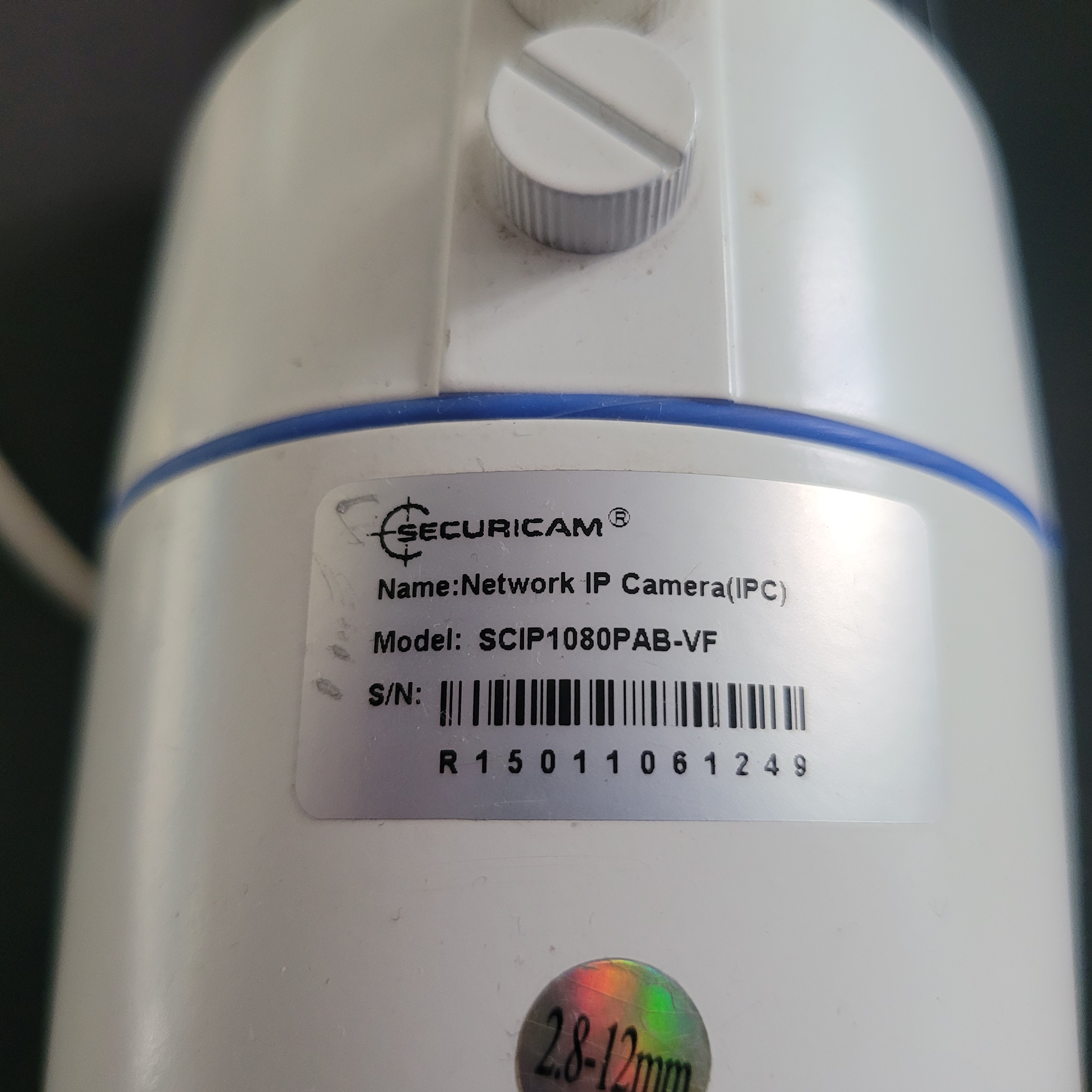

last night i managed to get one of the old cameras (jennov ptz) connected to the hikvision nvr. the other 2 cameras are securicam bullet cameras (see photo )

Are these the 2 cameras that are not showing in SADP?
If it is then it is likely because these are not Hikvision or Hikvision OEM cameras so the Hikvision SADP Tool won't be able to display them.
If you have a mix of 3rd-party cameras you will be best off using a 3rd-party IP tool like IP Scanner to look for all devices on your local network, using a tool like this you should be able to identify the IP addresses of these 3rd-party cameras, you can then login to each of these cameras by putting the IP address into a browser, and then in the camera network settings, you can change the network details to the NVR subnet range as described above.

attached is a 2 photos of present settings. the top 2 are the same make and model (new cameras) 3rd is jennov 4th is bullet camera the 1. 2. 3. 4. is for both photos

So you have 3 of the 5 cameras streaming to the NVR, it is likely the case that the remaining 2 still have network/IP address issues.
As I said above with such a mix of 3rd-party cameras and with the desire to use camera-specific settings like audio, smart events, advanced PTZ settings, etc... you would be better off keeping all the cameras on a separate PoE switch with their own dedicated IP addresses to access them directly.
