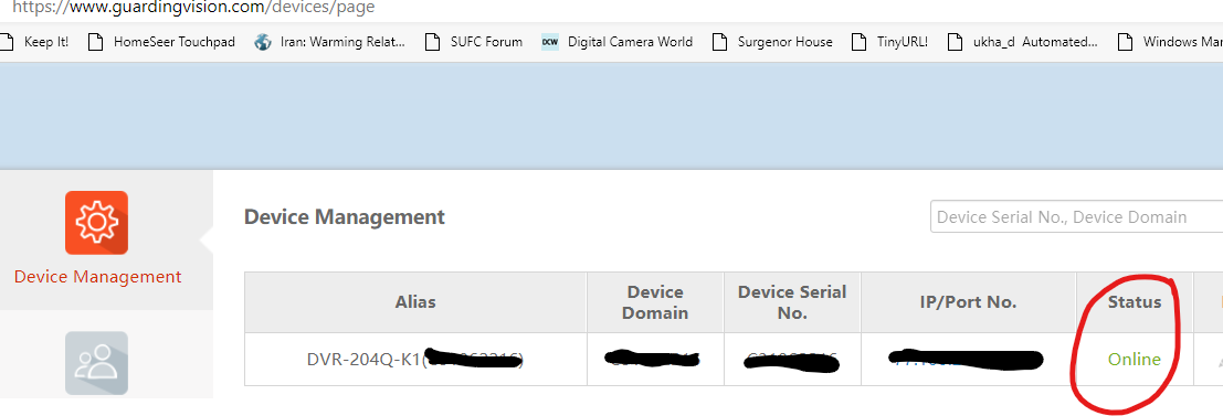

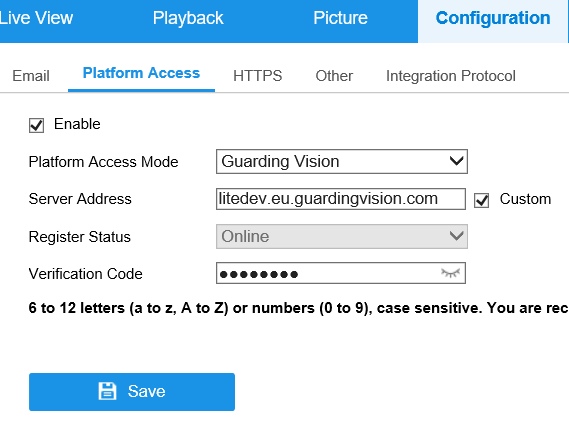

I then read that Hik-Connect didn't need port forwarding (?) so I tried that. Whilst again that worked internally I couldn't get it to connect externally. In setting that up, the instructions advised setting the Platform Access Mode on the DVR to Hik-Connect. That option wasn't available to me. The only option on the drop-down menu was Guarding Vision. I believe though that this has been set up correctly? See screenshot -it's showing online.

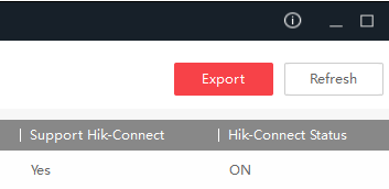

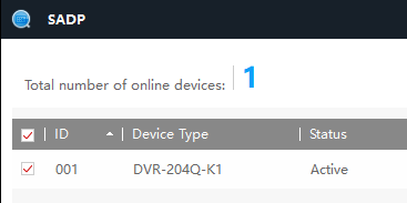

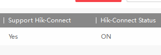

I can't recall now where I saw it but there was a link somewhere that you could put in your DVR model number to check if it was Hik-Connect compatible - mines was. Also SADP shows...
If I ignore the Guarding Vision PAM and put the Hik-Connect server name in it never shows as online.

As per original post a Hik-connect option isn't available to me in the Platform Access Mode drop down. However if I put a Hik-connect server address in anyway and click custom it never shows as online ( whereas the GV address does).

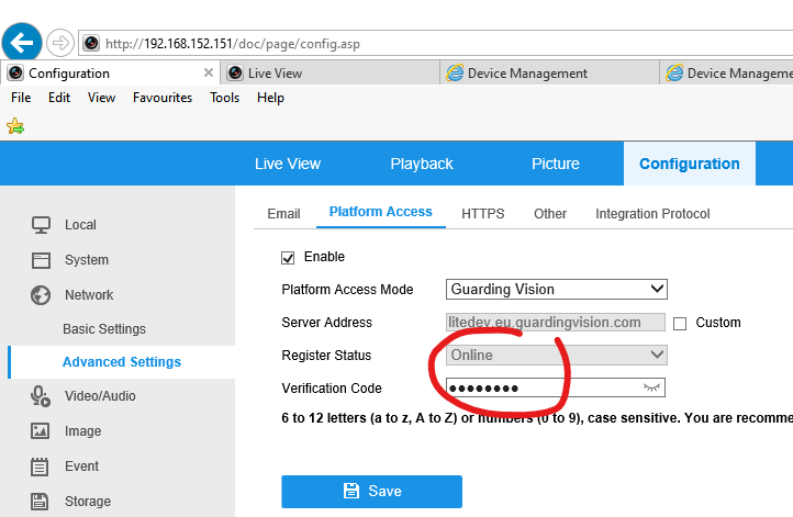

It's frustrating when my NVR is telling me it can see and is connected to the Guarding Vision site- see below.

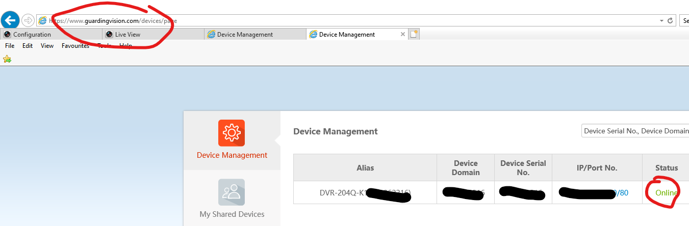

...and that the GuardingVision.com site, when I logon (externally), is telling me it can see my NVR.
I struggle to understand why the apps (either Guarding Vision; Hik-Connect or HiLook) can't connect.
