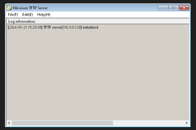

here is picture of how the software looks when both devices are connected together and after rebooting the dvr it seems as if nothing happens as if the dvr is not attempting to connect with the tftp server
I've never used the hikvision tftp server software, here are some suggestions.
Your tftp server is initialised but is not seeing any connect requests from the DVR.
make sure your wifi is disabled.
the firmware file (digicap.dav) should be in the same folder as the tftp.exe file. Make sure you have the right firmware file, uploading the wrong file could permanently brick your DVR.
laptop antivirus could be blocking the tftp protocol, temporarily disable it.
I found this YouTube video that may help you. Keep the direct cable connection.
Let me know how you get on.

yes my wifi is disabled i did exact same thing in the video and yes the digicap.dav is in the same folder
also i am running the program in compatibility mode windows xp
i also tried this on a different pc that had windows 7 but same issue the tftp server seems to not be getting the request from the dvr or something
i don't know what im missing
is there an alternative to the tftp software that hikvision uses?
