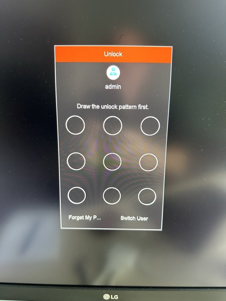

Hi guys,
I tried going from 3.4.93 to 3.4.103, once it rebooted it said to enter a new password, It wouldn't let me enter a user so I left user blank and entered a new password, then it said to draw pattern, when I try to do anything it asks for the admin pattern, the pattern I set doesn't work and I keep loosing trys, I tried forget my pattern and it seems I am back in a loop as there is no user and when entering the password nothing happens.
Hi
Seems that only way to bypass is the Hard Reset option by Pressing and holding the motherboard reset button(if exists beside the small battery).
You must remove the box cover and access the board
There are many how to videos in Youtube.
Call or take advice from an experiensed technician
You will lose all your previous settings but this could be the solution
