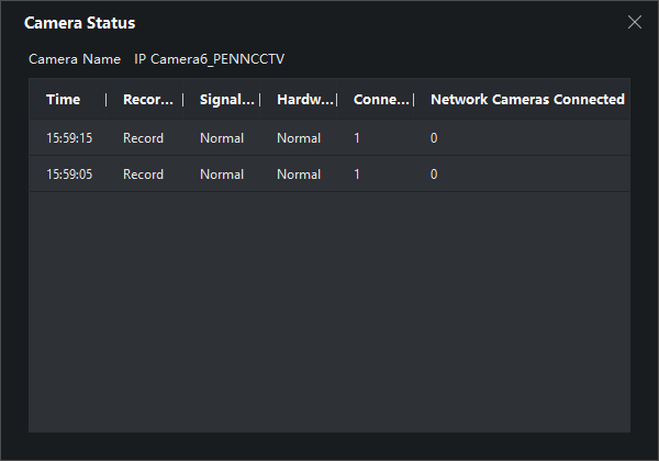

The problem I've got is it's one of those little mini HD IP cameras that fit in a bird box. There may be a reset button on the camera but I can't get to it at the moment because I'm disabled and can't get anyone here to do it. Also, I can't go taking the bird box down because the birds have finished building their nest and there might even be eggs in there at the moment. When I look in iVMS 4200 and go to the camera status there is a zero under connection number and network camera connected. So the DVR is definitely not seeing the camera for some reason.
As you can see, there is a 0 under network cameras connected when I click on the bird box camera.
One thing that is puzzling is that if I disconnect any of my IP cameras I get a message on the screen saying "not connected", or something that indicates there is no camera plugged into that particular port. However, all I've got is a blank black screen where this IP camera in the bird box is plugged into.
