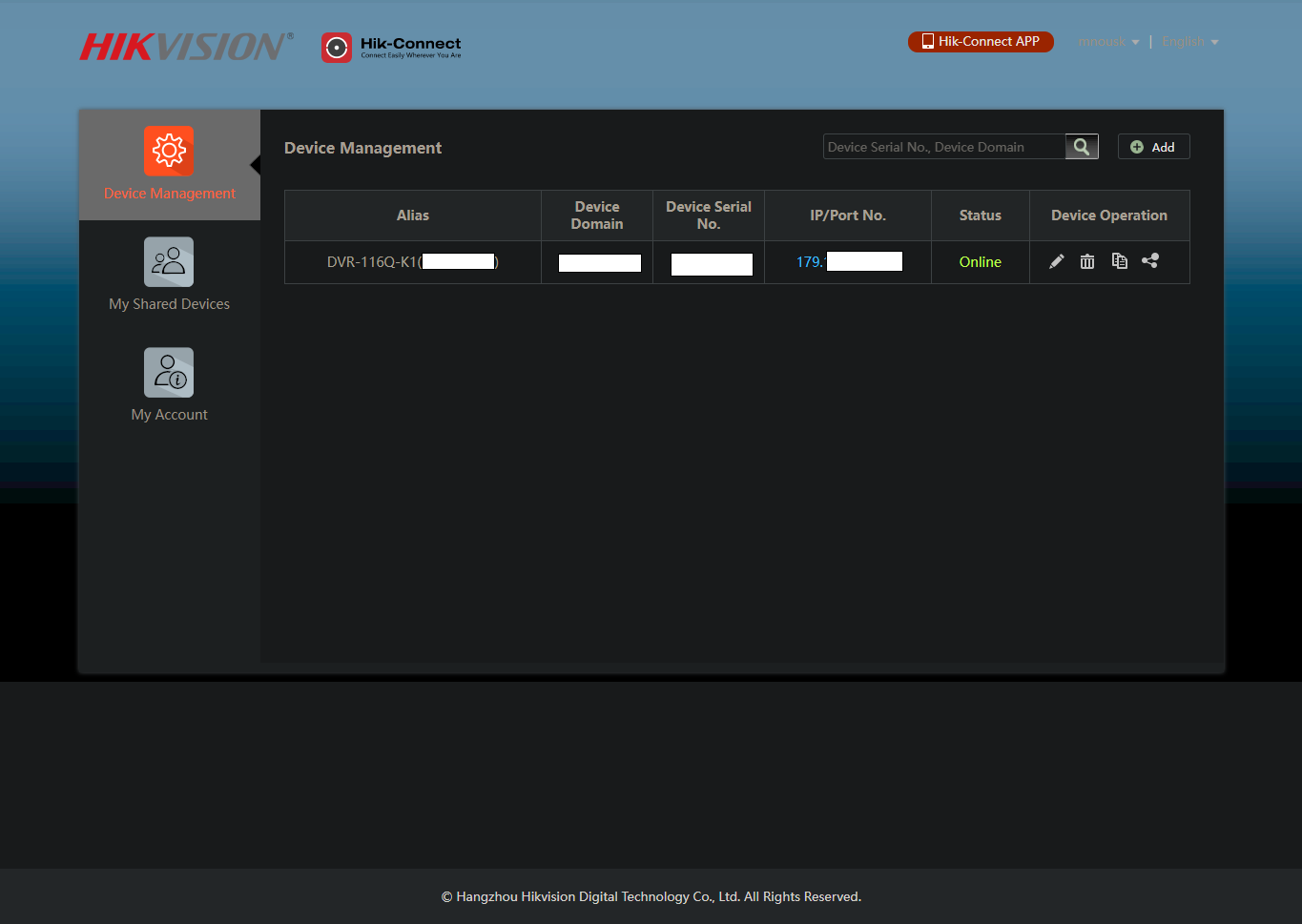

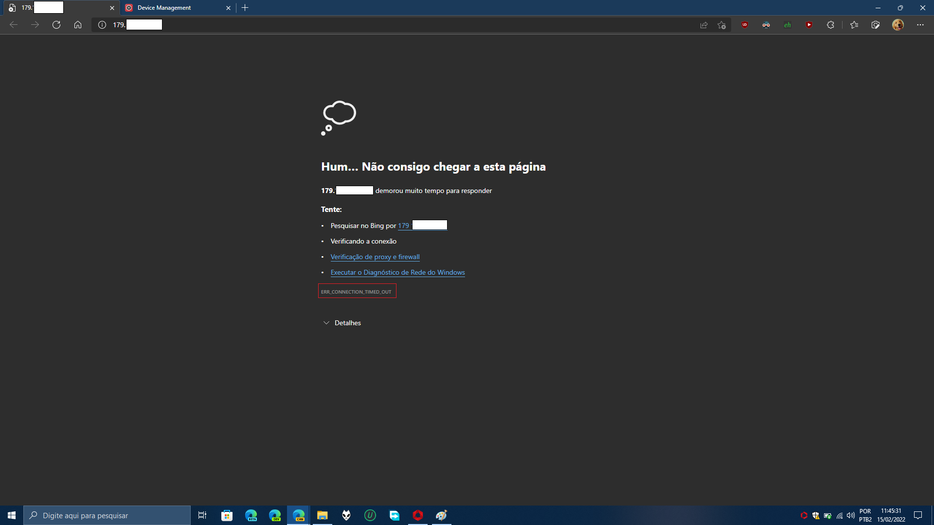

Randomly, I can't access my HiLook DVR menu through a browser, throwing me a ERR_CONNECTION_TIMED_OUT error, while it's working fine on iVMS-4200. The device
status is online on Hik-Connect, I click the IP but it won't connnect. Tried adding common HTTP ports like 80 and 8080 at the end of the address, but no luck.

The IP address link shown in the Hik-Connect Portal has not worked for many years.
If you need to access the DVR with a browser on your local network you will need to install the Hikvision SADP Tool to identify the local network IP address that the DVR is using and then you use that IP address in your browser to access the DVR.

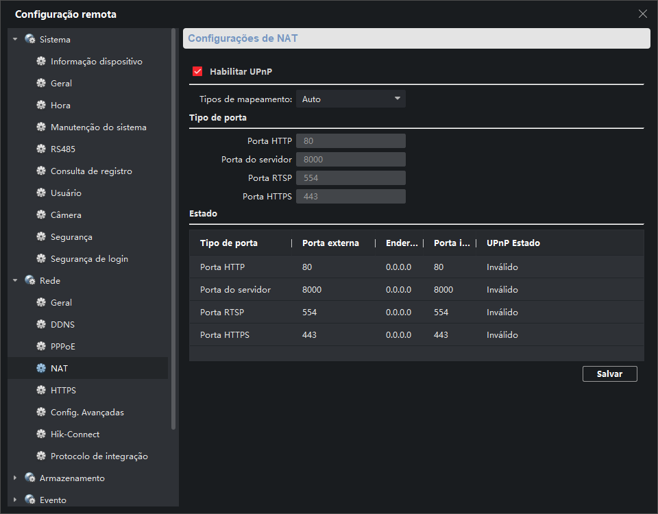

Guess the issue is the DVR UPnP isn't working, as all ports are open on router:
Like I expected, I can access the DVR through browser via local IP (192.168.15.2) while within the same local network. I checked NAT menu, all ports status are "Not valid", I just don't know why.

No problem, it's better to concentrate the issue in a single thread. I don't think it's caused by any change made by the user, I didn't mess with anything and all ports are invalid now. The issue is with the DVR UPnP feature, it's buggy and not doing what it should. I don't even know if there's a proper solution, I think the only things left to do are rebooting the equipment or updating the firmware.
@jonnystuartuk Good news, the issue has been fixed by itself without having to reboot the DVR, now all ports are valid and I can access the interface through browser again. Pretty sure the UPnP feature started worked again after the public IP was renewed. Anyway, I appreciate your feedback, we can only hope it won't bug out for a while.
