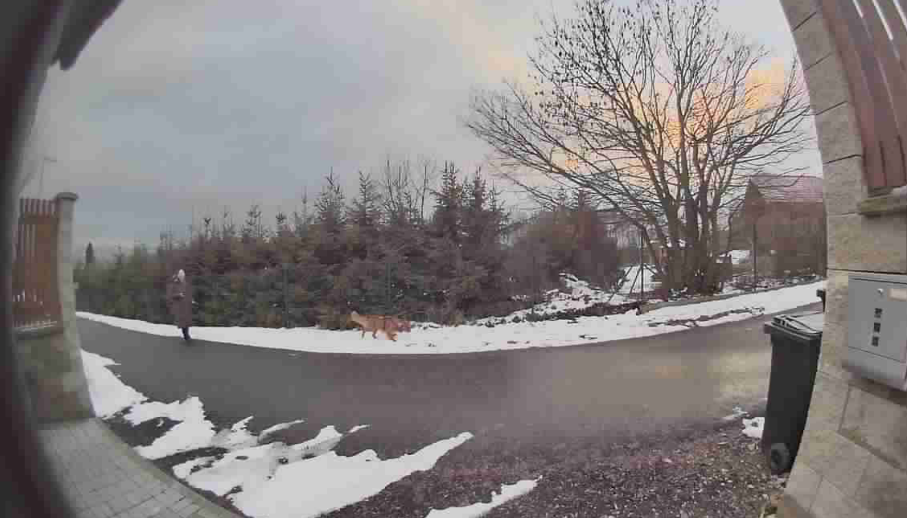

I have DS-KD8003 connected to IVMS-4200 when is motion detection on KD8003 than is sended picture to IVMS-4200, but the picture resolution very poor. It is possible setup better picture?

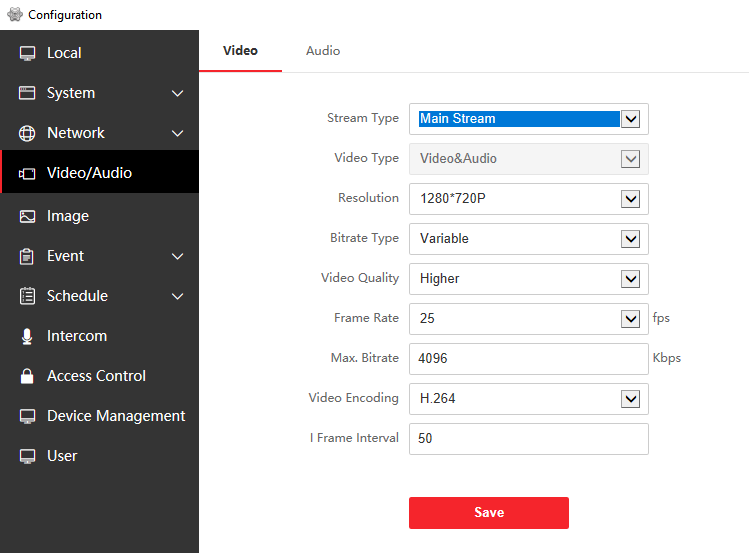

Check that you have set the highest resolution option for all streams as well:

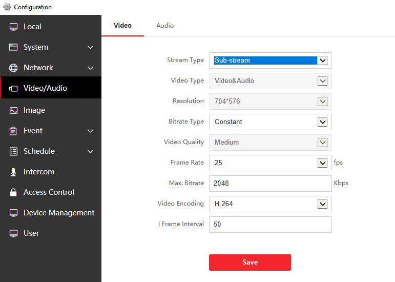

In iVMS-4200, go to the device management page, and click on settings (the cog button) for the KD8003, and then go to Video/Audio>Video.

I can't see any other setting to improve the quality of the pictures that are sent, so I think you are receiving 2MP pictures but these just seem poor quality compared to the higher-resolutions that are more common now.
Are you able to share an example picture to show the quality of the picture you are seeing?
Sorry, ignore me, I didn't see your third attachment in post #3, which is what I meant.
It looks like it's taking the picture from the substream.

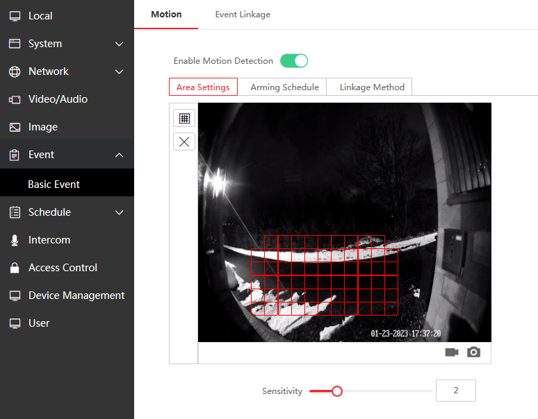

Can you show me where you set the motion detection up to send the picture in iVMS-4200, please?

In configuration of KD-8003 I cannot change resolution of sub-stream, like as @pemen shows in post #3.
