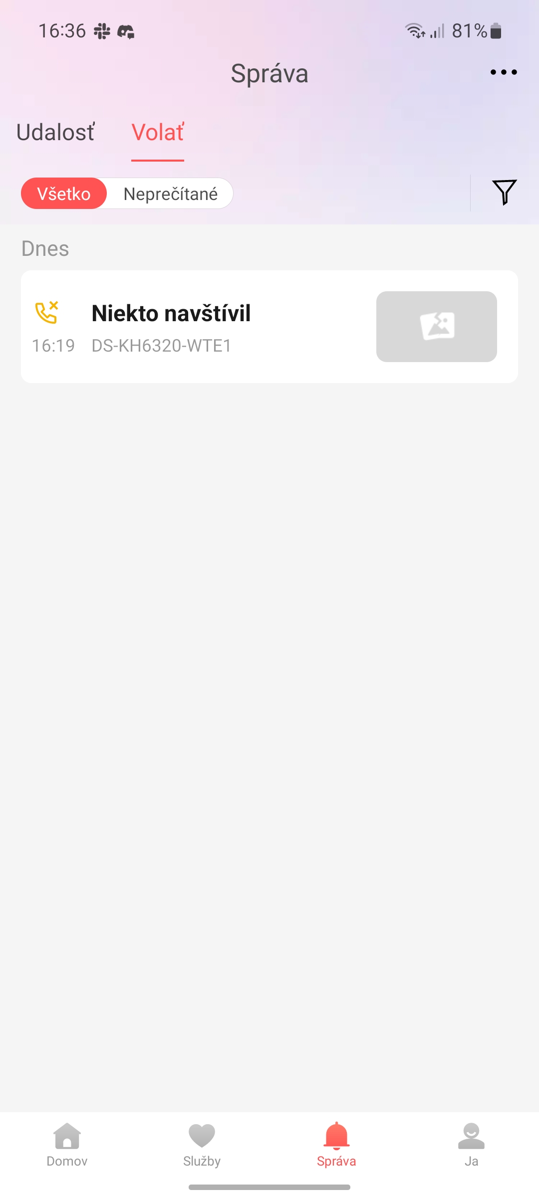

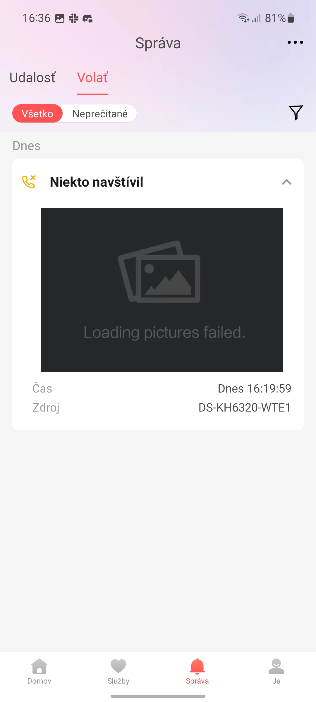

Hi,
after recent update of my HikVision DS-KD8003-IME1/S to version V2.2.62 build 230204 and DS-KH6320-WTE1 to version V2.2.20 build 23061 I am unable to see snapshots of people who pressed the outdoor doorbell button. I can see the images in the indoor station (SD card works fine) but not in the HikConnect app (v5.3.2.0822). In the app, it says: "Loading pictures failed." when I try to see the picture. Is there some bug in latest firmware? Previously it worked fine but it stopped working after firmware update. I am getting notifications and calls into the app but I am unable to see the actual picture of the person who pressed the button. See screenshots.

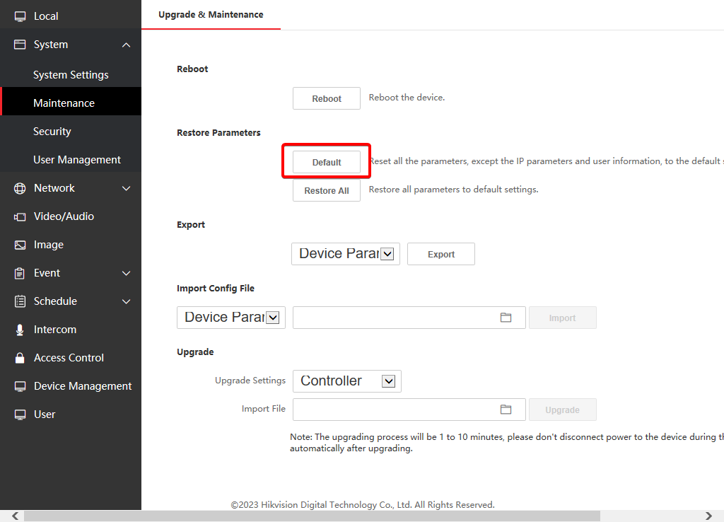

You'll need to add both devices to iVMS-4200 so that you can access their config menus (click on their cog button found on the Device Management page).
Then, go to the Maintenance menu and use the Default reset option circled below.
If you like, you can export the existing config file for both the indoor and main door stations before you reset them, using the "export device parameters" button on the same page, and then import them again to restore all of the previous settings for both devices following the resets:

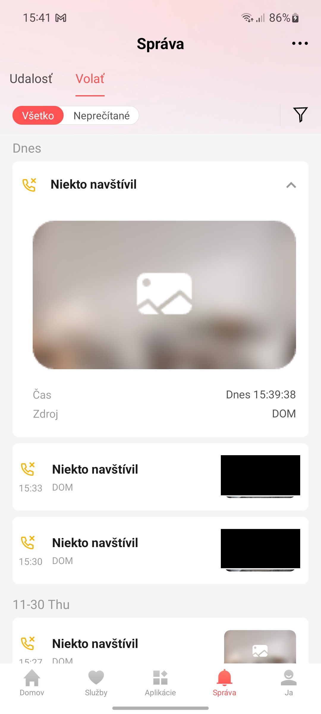

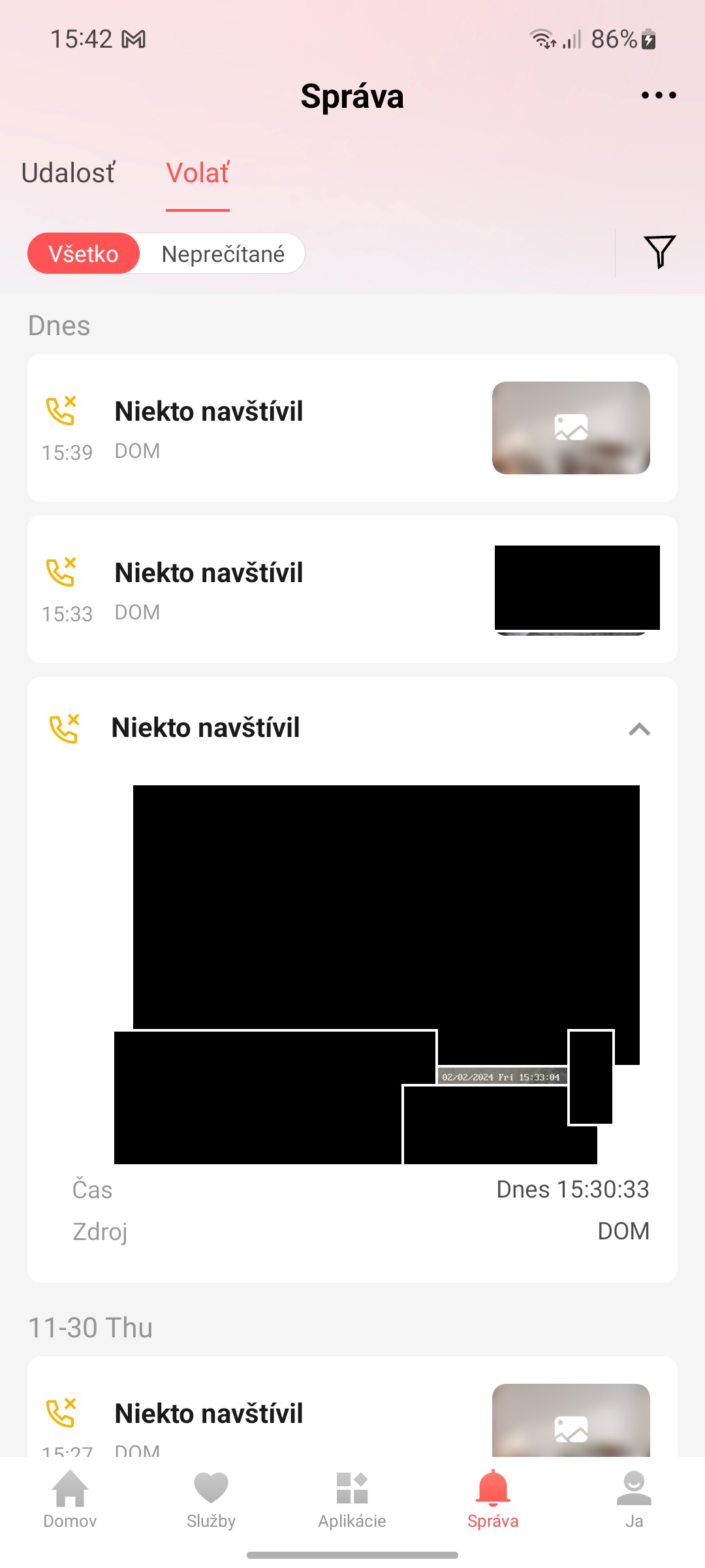

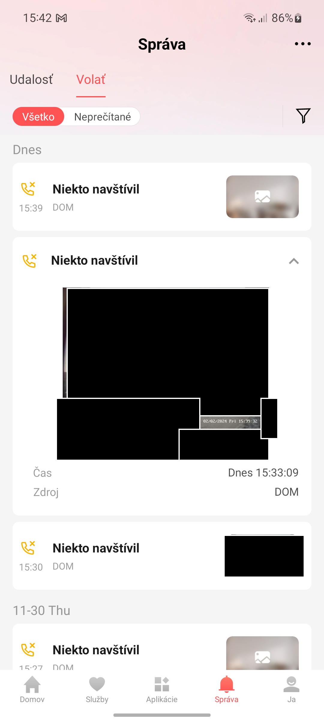

Ok. I did Restore - Default on both outdoor and indoor station. Reimported exported settings. Rebooted. Set the time correctly (also tried NTP but it has like no effect when I set NTP - only changing Time zone will change hour but minutes are wrong.)
Check the photos of hikconnect app. Something weird happens and I had already observed this in the past. The recent call doesn't show the picture but the next call will update the previous thumbnail and show it. It doesn't always happen (I think only if the time is not too much out of sync).

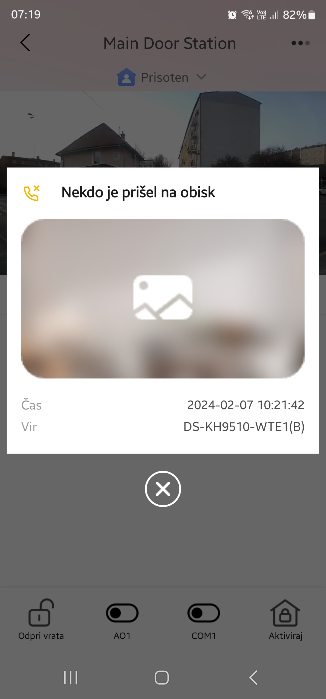

Hi!
I also have the same problem. I have:
* DS-KD8003-IME1(B), V2.2.75 build 231213
* DS-KH9510-WTE1(B), V2.26 build 230830
* iDS-7208HUHI-M1/E, V4.70.181 build 22062 (can't find newer upgrade?)
After upgrading and using the SD-card (additional 3 apps) - I can see the images in the indoor station (SD card works fine) but not in the HikConnect app (v6.1.30.0118).
Im asking for help!
