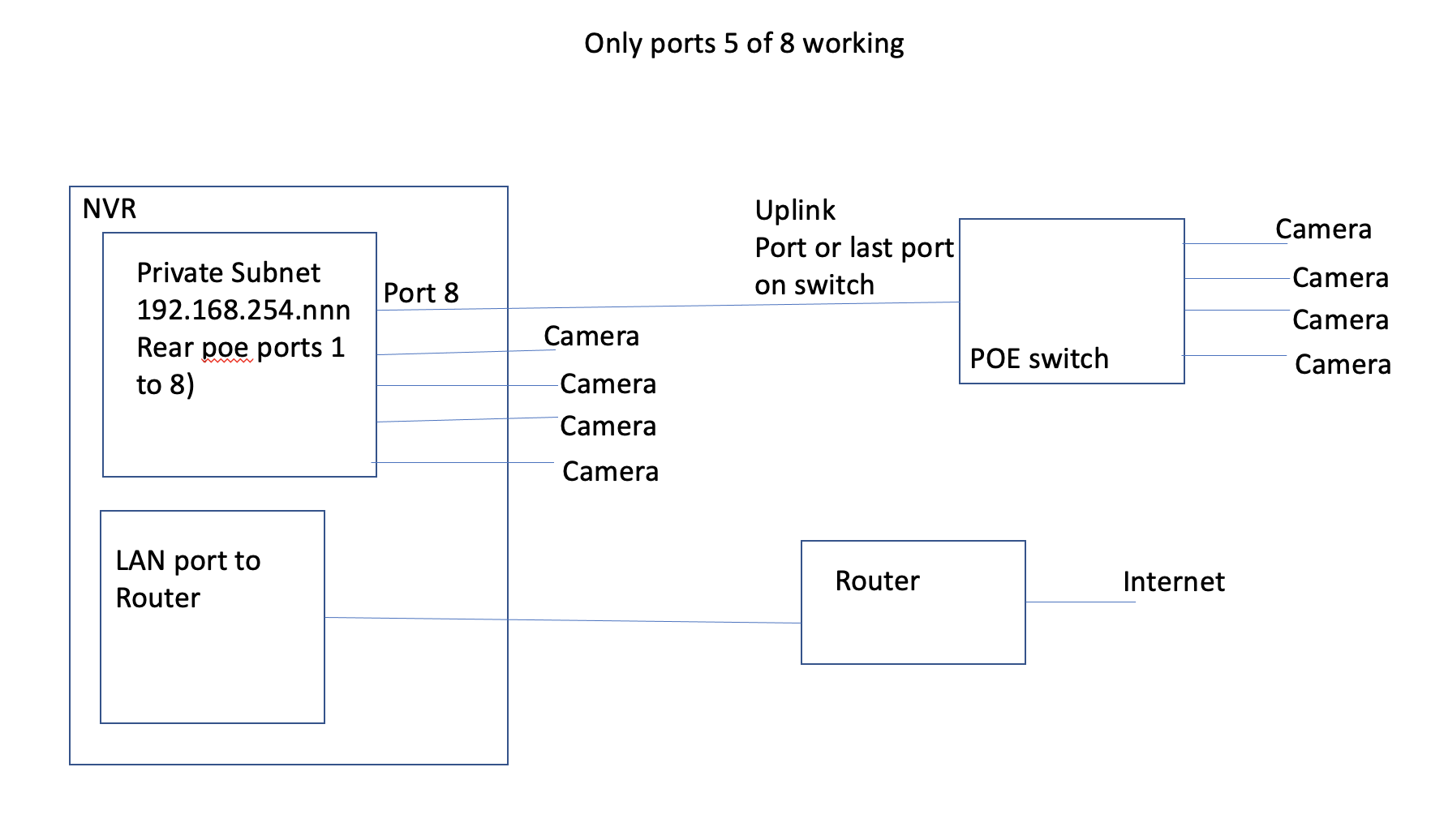

Any chance of posting a photo of a hand drawing showing how the NVR / Switch / cameras are connected?

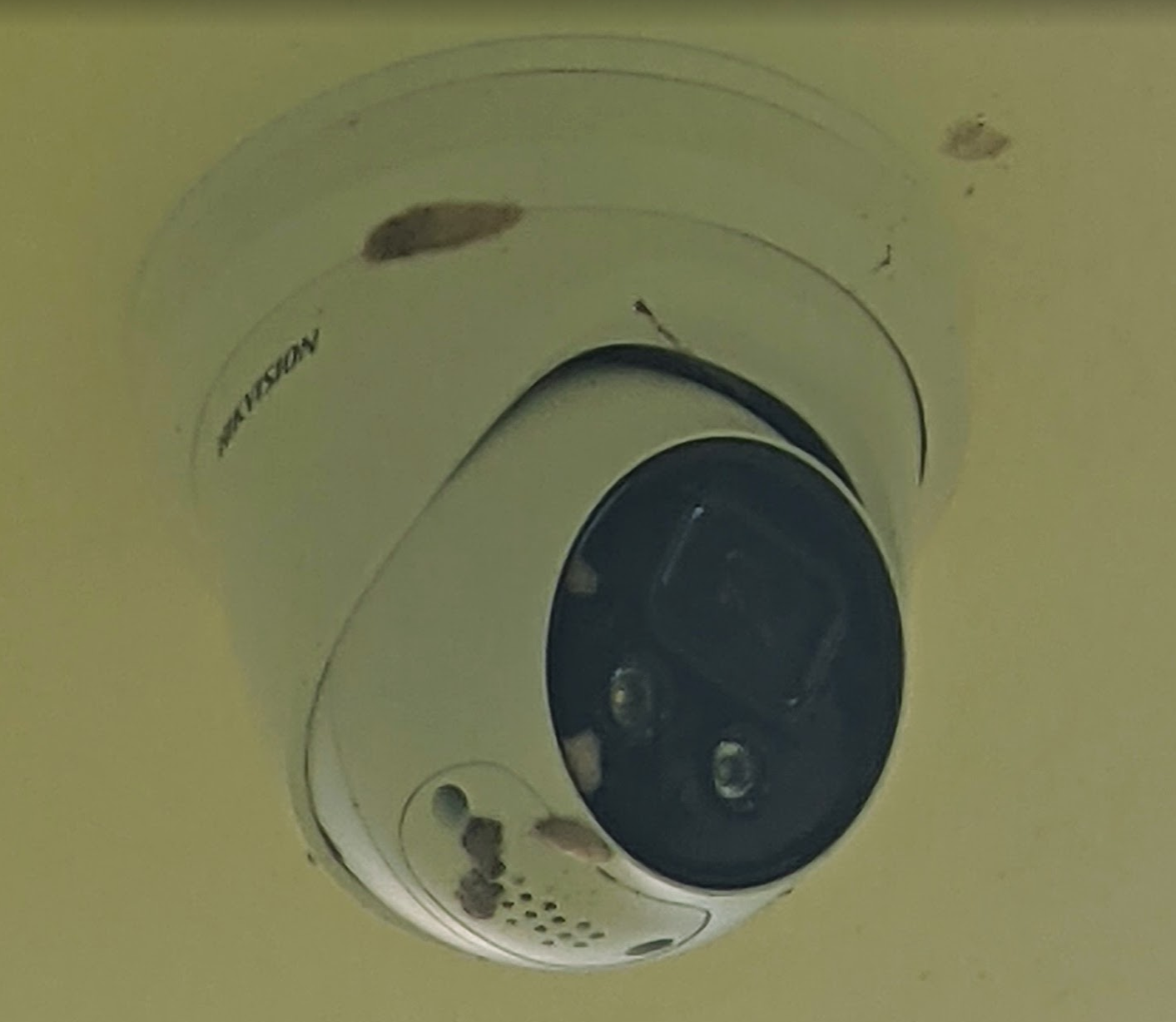

I can't get to the cameras easily so I've attached a photo.
(Edit. I think it's this: DS-2CE72DF0T-F)
How the solution at the box end should be cabled is part of my question I guess. Because I'm thinking the cables might have been moved around when the electrician changed things. Here's 3 options I've tried below and the outcome. Assuming the ports on the back of the Hikvision Box are labelled 1234 on the top row and 5678 on the bottom. Ports 5,6 and 7 do not work with any cameras. But all cameras work with the other ports.
* With no switch, cameras into ports 1,2,3,4 and 8. Cable from router into Hikvision LAN port. 5 cameras work. If I plug into the other ports the cameras don't appear and the indicator lights on the port show no traffic.
* Cable from router into Hikvision switch. From the switch one cable to to the LAN port on the Hikvision Box and another to port 8 on the Hikvision box. Result is only 4 cameras.
* Cable from router into Hikvision LAN port. Cable from port 8 of the Hikvision box into the switch. Remaining 3 cameras cabled into the switch. Result is only 4 cameras.

When the new switch arrives let us know. connect it as per the picture I posted earlier.

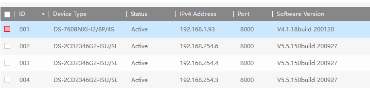

we'll be able to see what the ip addresses and model / firmware numbers are.
If you can connect all the cameras and NVR (LAN port) to the switch. Connect the switch uplink port to your router.
Run SADP and take a screenshot of the display. Edit the screenshot to black out all the serial numbers (they can be used to gain remote access) and save as a JPG file. I'm happy to give you my email address if you want to send it direct, let me know.
Send the LAN IP address and subnet mask of your router as well.
OK, here's the NVR and the three additional cameras. The LAN is 192.168.1.XXX the subnet mask is 255.255.255.0.
