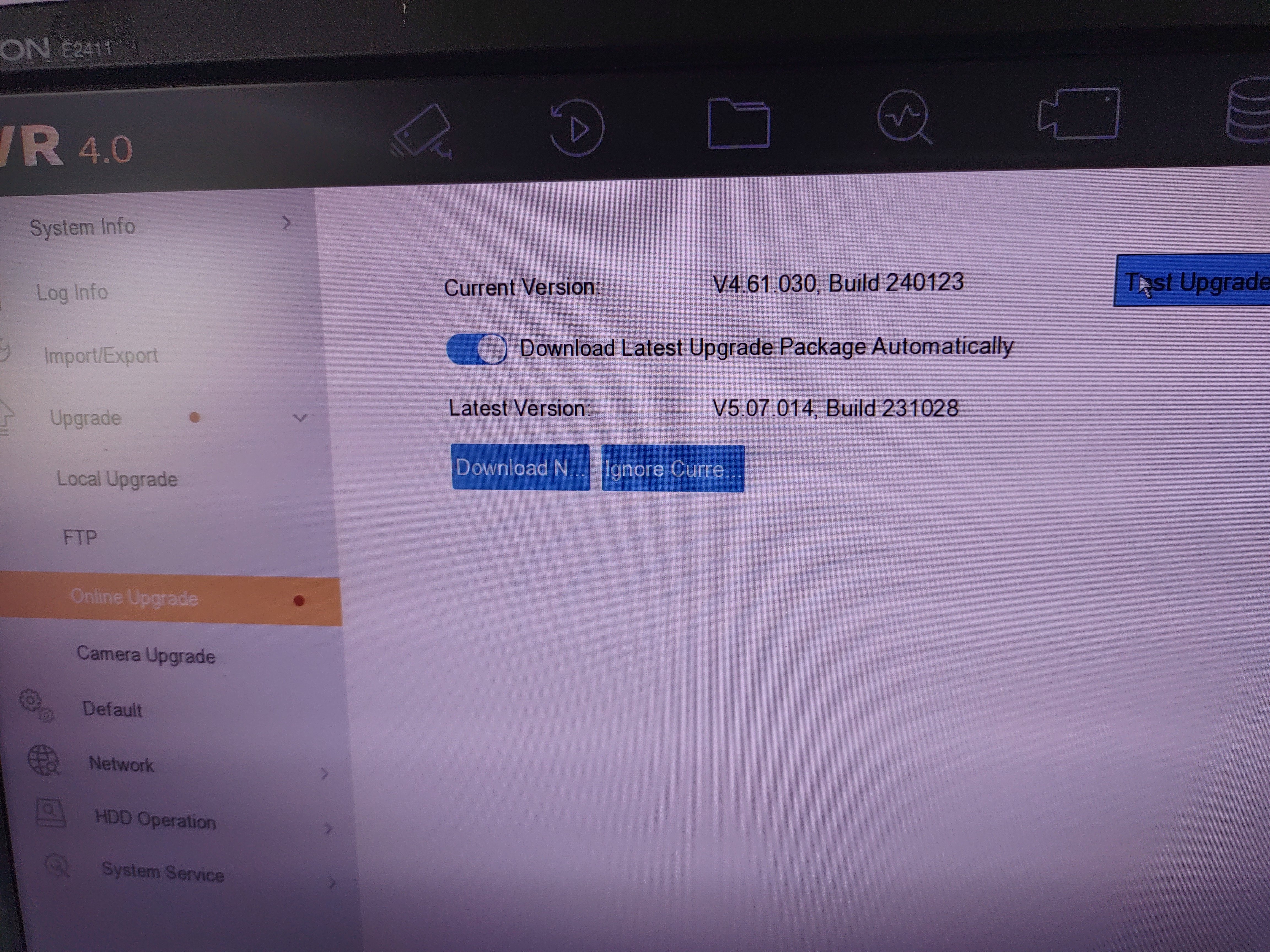

Hi Folks, my DS-7608NI-I2/8P (currently on V4.61.030 Build 240123) has just started prompting me to install Version 5 firmware, has anyone else had this or installed it?
Hi,
not for me. 5.07.014 with build date 231028 looks odd. all the known v5 NVR versions are from 2024..

I wonder if it's camera firmware. As the update has never worked properly, it isn't clear whether the NVR can update firmware for the connected cameras. 5.07.014 is the same as 5.7.14 and the corresponding 5.7.14 in G5 firmware has that same build date (231028). There's no reference to a version 5 firmware for the I series anywhere on the internet; 4.61.030 being the newest available
i like the thinking, makes a lot of sense. its a feature.. not a bug..
