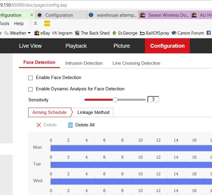

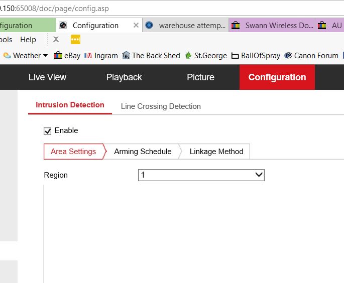

I have 10 identical camera, (1 not installed), and noticed that just one has Face Detection listed under the smart events.
All on 5.5.5 as of yesterday, & that's when I first noticed it & assumed the upgrade must have added it to all cameras.
Any ideas where it's come from on just that one camera?

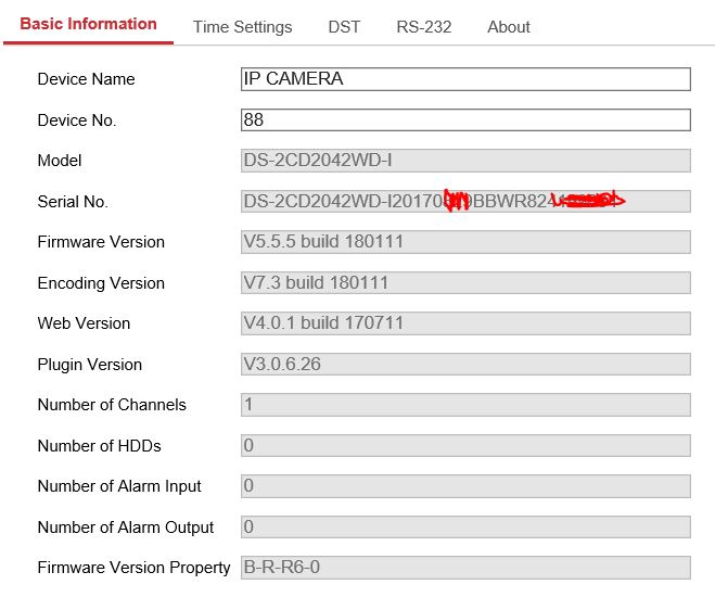

Serial numbers are the only thing different in basic information.

All the same model number?
Are they all 'Western Region'?
(WR in the serial number)
All Same Model#, All WR.
Looking at the above serial#, is the..WD-I2017xxxxBBWR a build date?
That is slightly different.

Got an answer over on Ipcamtalk.
If I disable H264+ for a given camera on the DVR, then Face Detection appears under the Smart events when you access the camera via the Virtual Host.
If you try & access Face detection from the DVR, it reports that the camera does not support it.
