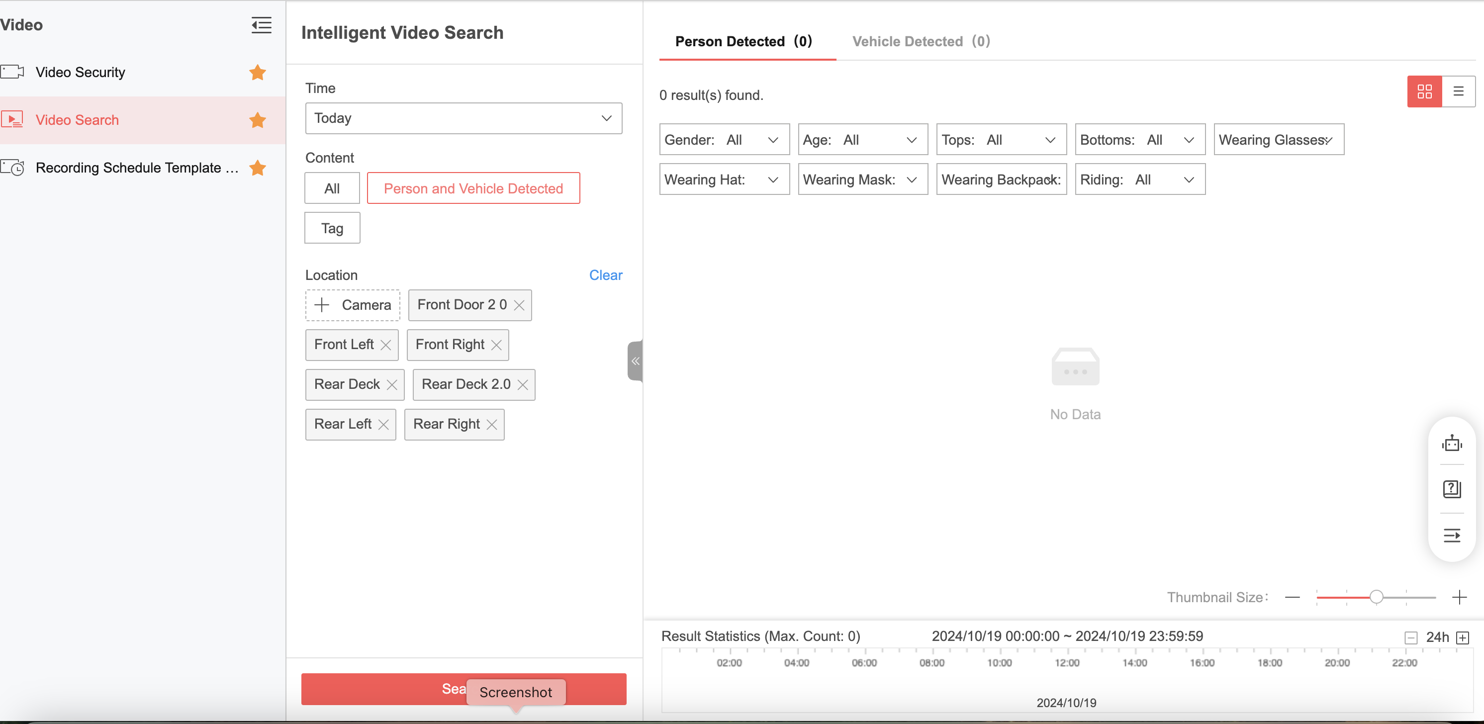

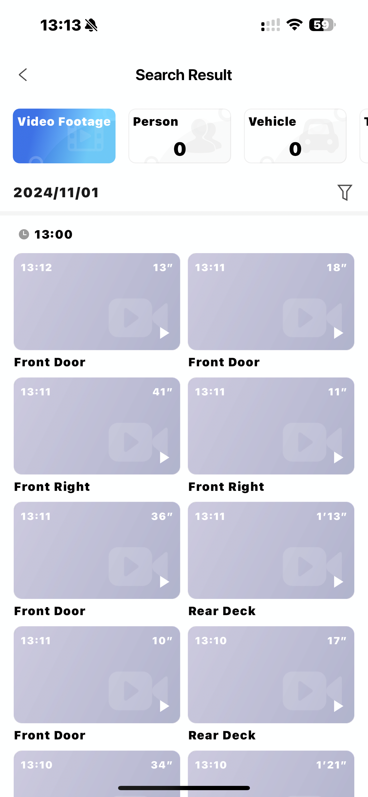

I cannot find content when searching using Hikvision's Intelligent Video Search online. It simply returns no data when searching for 'person and vehicle'. It will return all data if I don't apply a content filter,

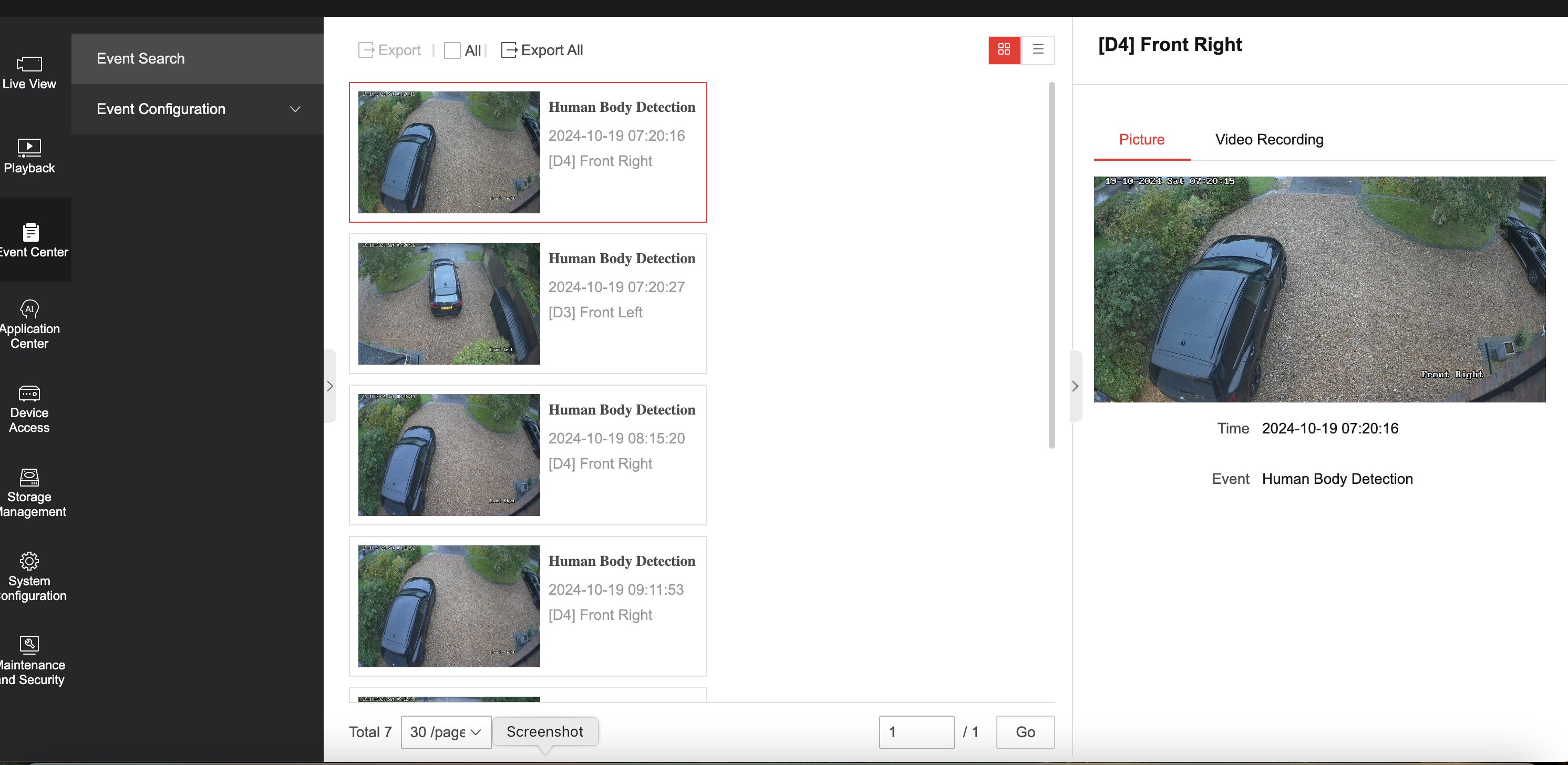

However, if I am on the NVR (Hikvision DS-9664NI-M8) locally in the Event Center, I have no problem searching content by event type. i.e. target event, human body or vehicle. Which makes me confident the hardware is fit for purpose and correctly configured.
What am I missing? What must you do to get Hik-Connect to surface the same data as the Event Center does when you are on the device locally? I can see the NVR, cameras, live feed and playback via Hik-Connect. The only issue is with searching the data for specific events. Almost like it doesn't have the metadata for the event types.

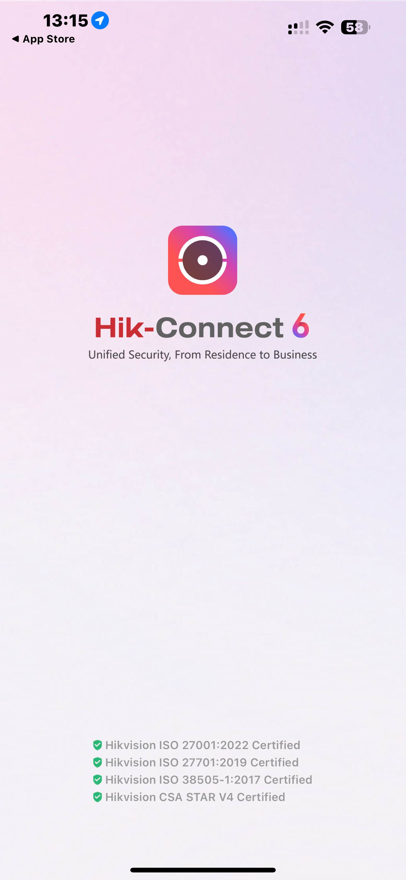

Android or IOS?
Are you running the latest version of the App?
As can be checked here - App Store
I do have an IOS device, but the issue is the same on Windows with Chrome or Edge.

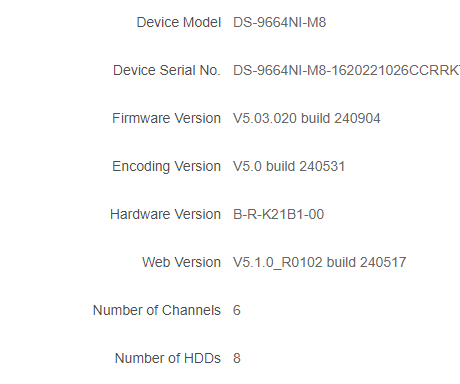

Thanks for the suggestion. I upgraded the firmware a few days back; please see the attached file. Sadly, it made no difference. Also, the search does work locally on the NVR. So the metadata for the events must be there. Suggesting the hardware is working. The issue is with Hik-Connnect surfacing the same results that are on the NVR.

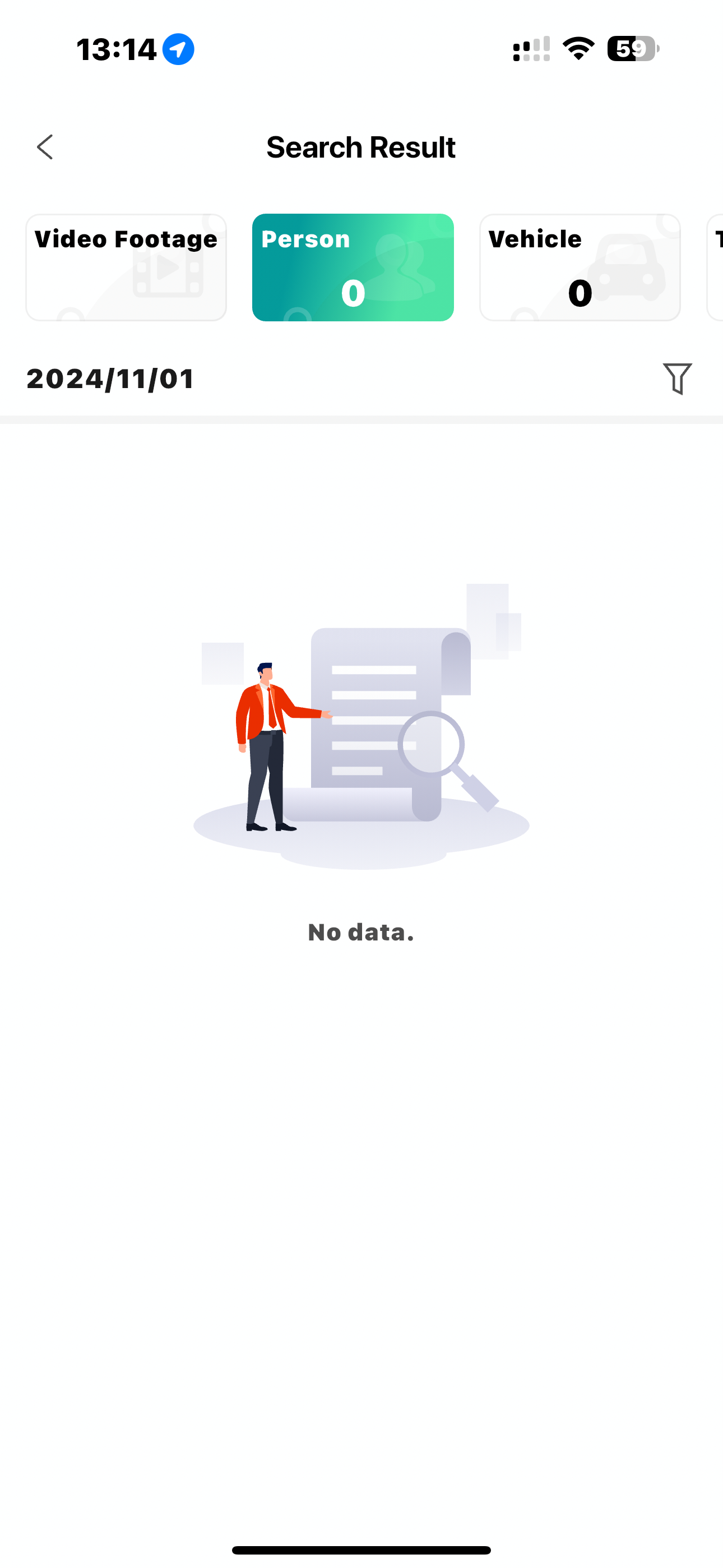

I am using Hi-Connect online and my mobile (6.6.420 for IOS). Neither surfaces the data.
The NVR was added using the QR code.

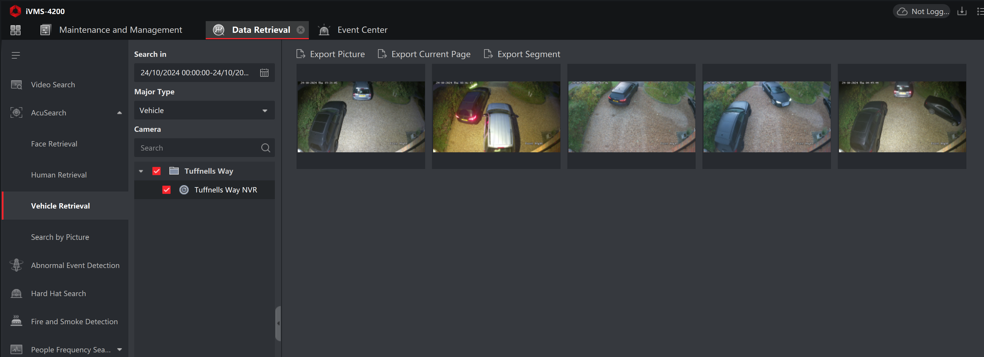

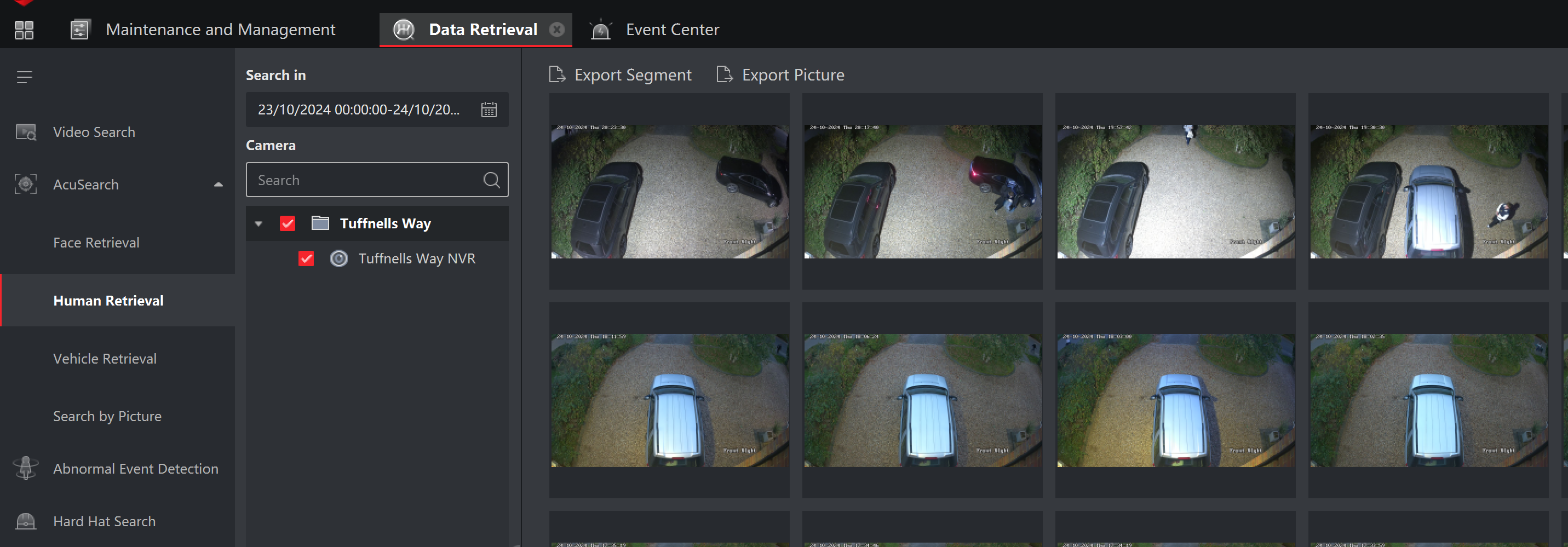

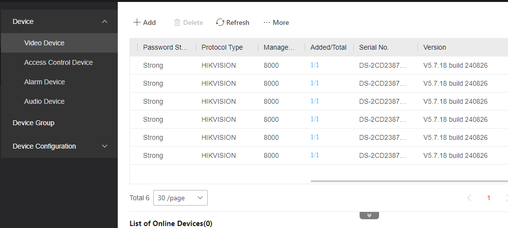

It works as expected when using iVMS. See attached.
I've tried Hik-Connet using Edge, Chrome and Safari. It will surface data but not when filtered Person and Vehicle.
