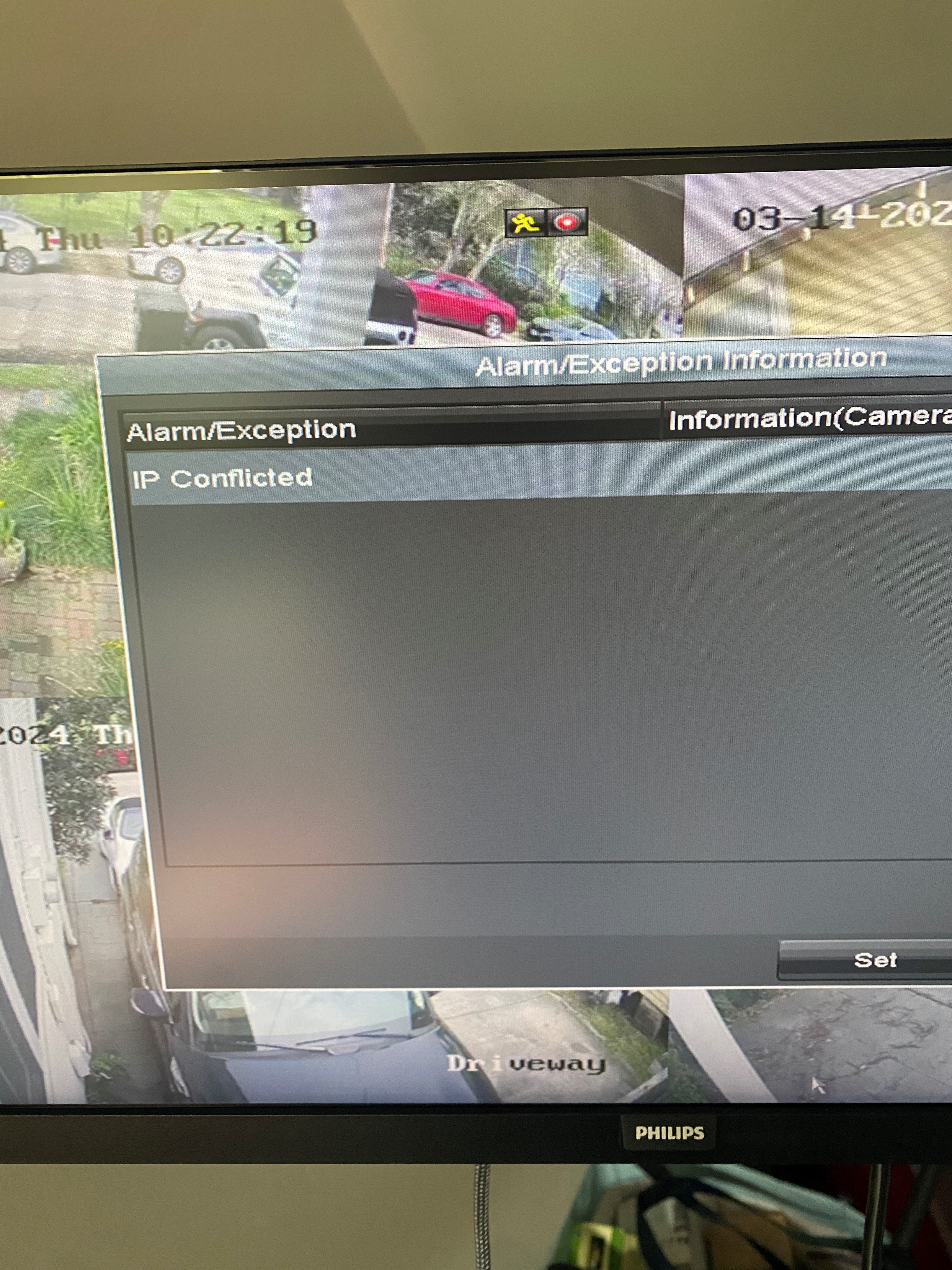

Can you please share a screenshot/photo of the "IP conflicted" error?

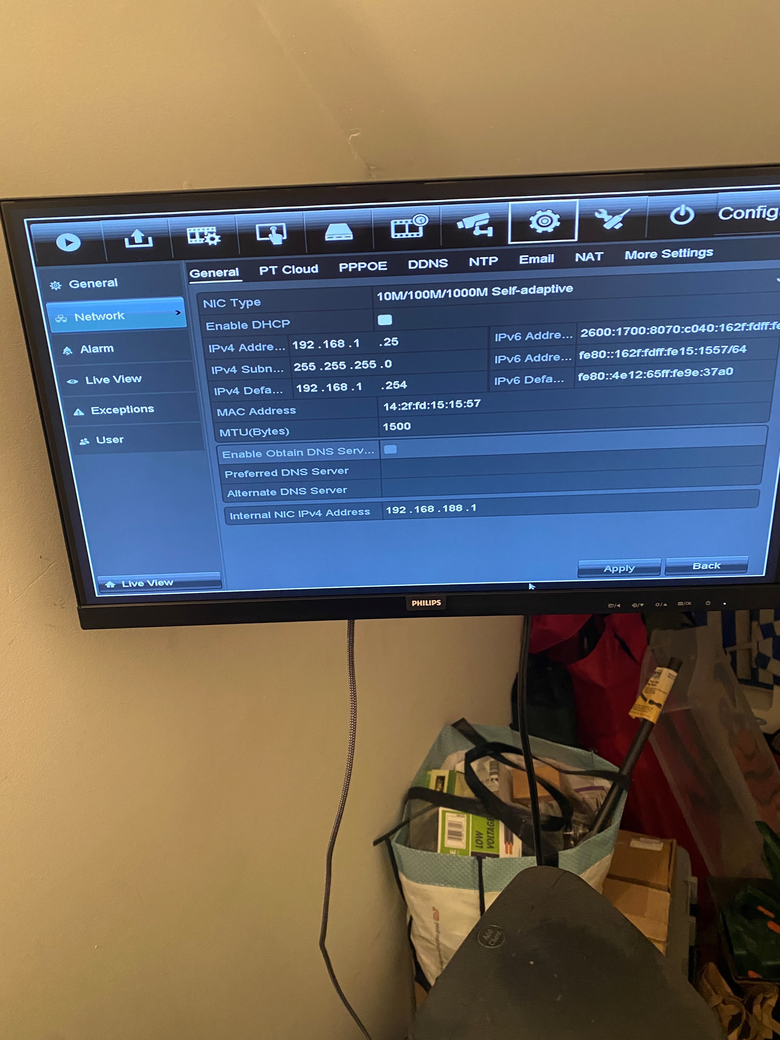

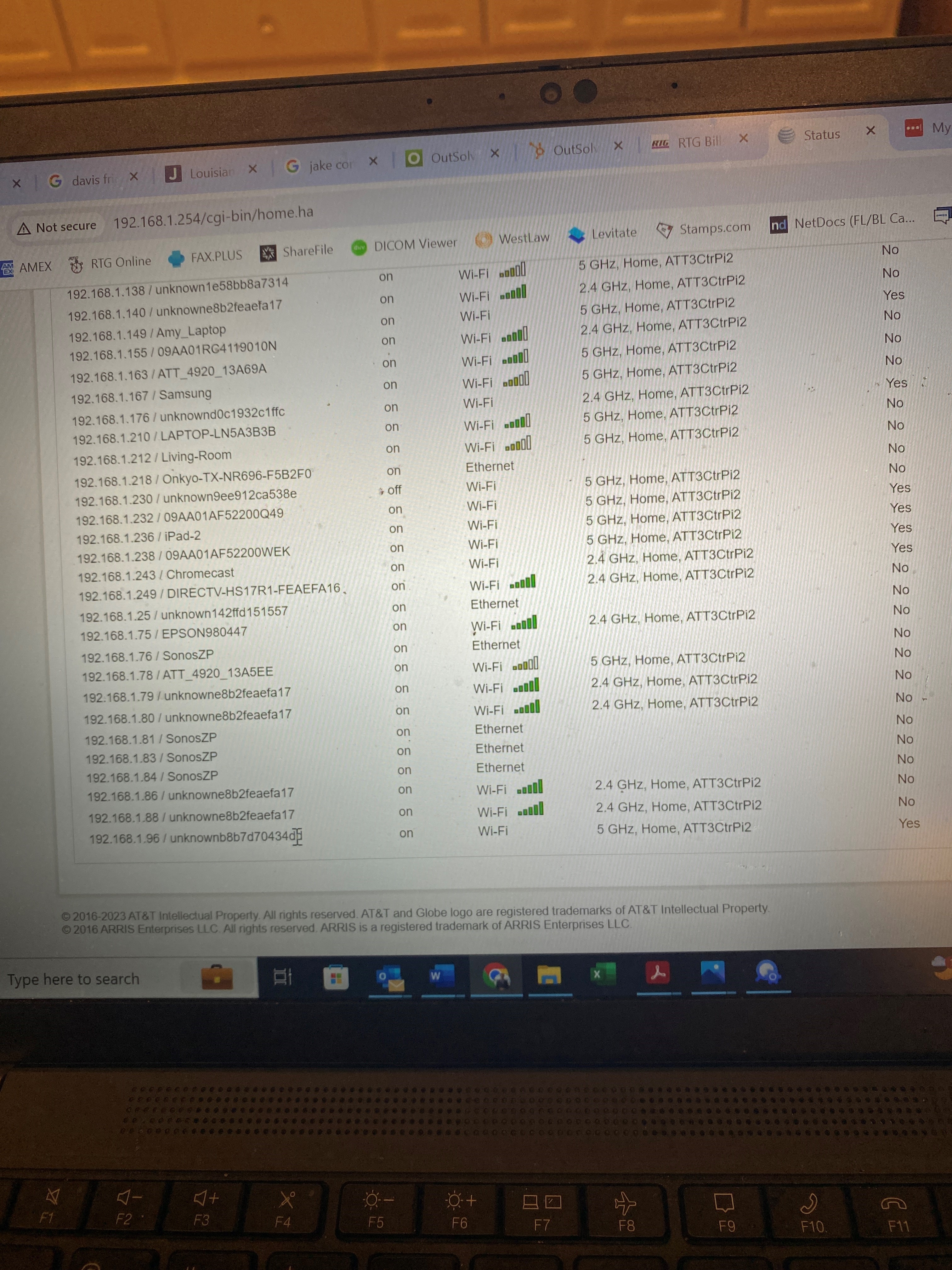

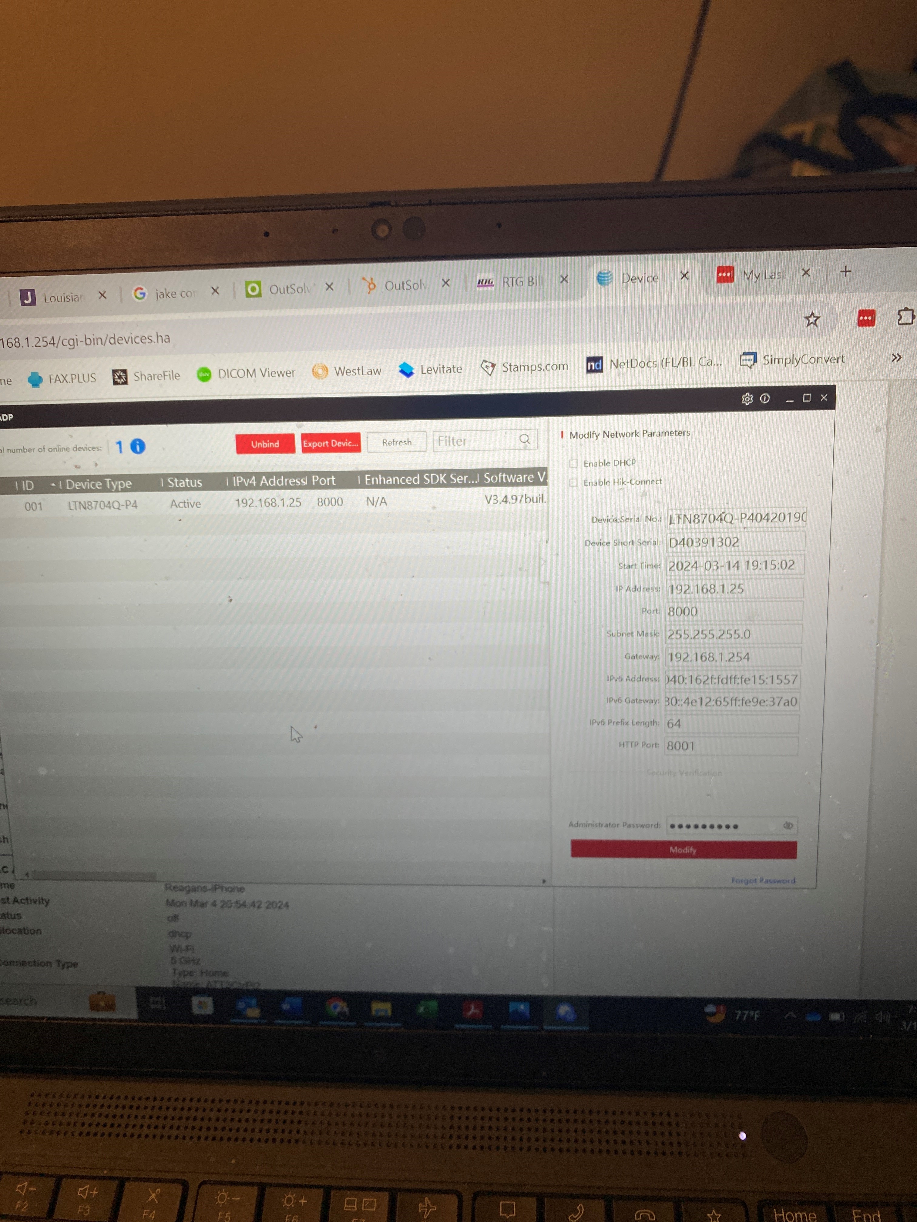

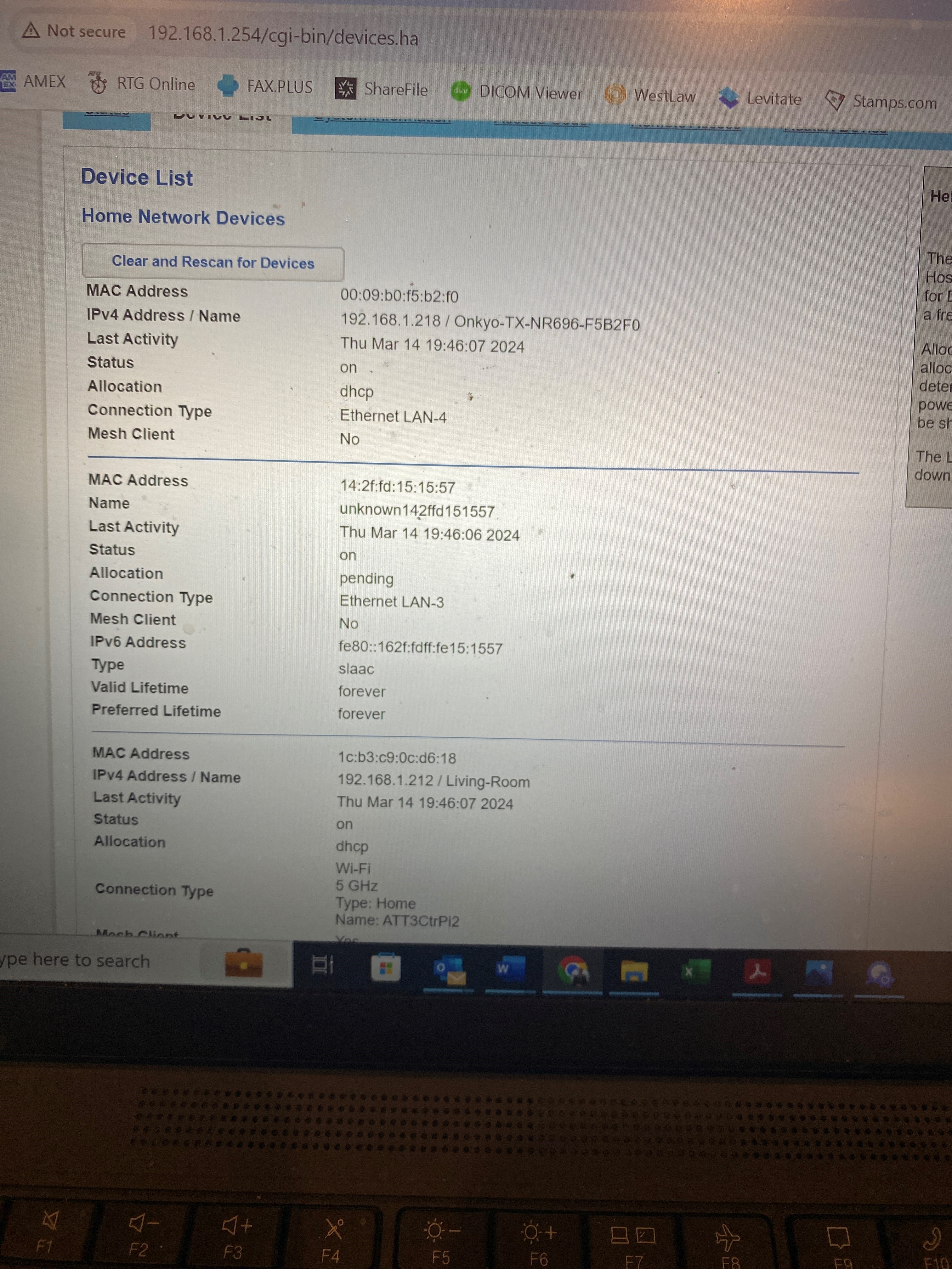

Dan, thanks for replying. Yes. All four cameras are hard wired into the ports on the NVR. I'm attaching some pics showing the error and the settings and status of the recorder (from the recorder's monitor, the SADP, and the router)
Also, when I chose the static IP ending in .25, I used a number outside of the range my router will randomly assign devices. The router has that range set to begin at .64; so, nothing should get assigned .25 without my setting something to that IP.
