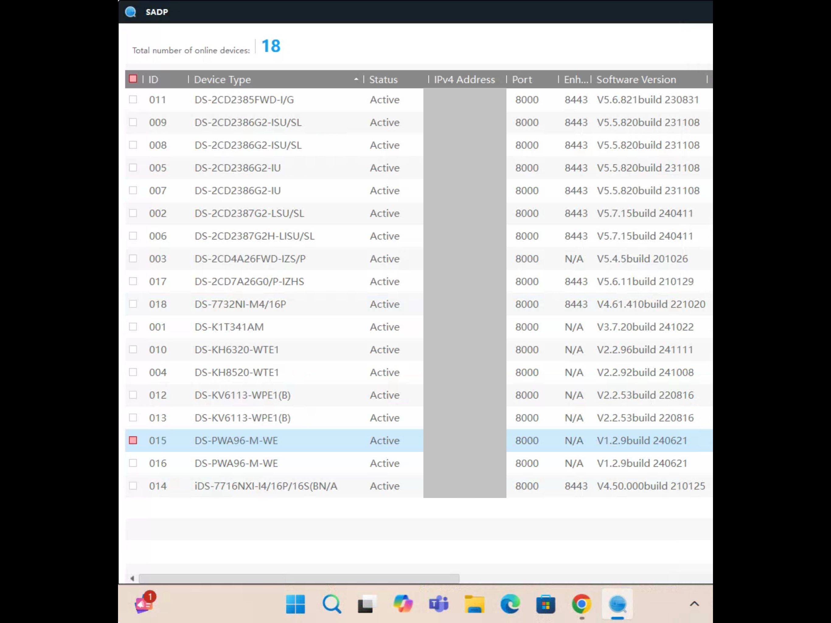

Hello after many years using trusted 7716NI-I4 and also my main IDS7716NXI-I4/16P/16S (B) I’ve decided to future proof myself and move to the dark side AKA M series as I’m upset after i got my IDS unit they made a different version and made mine EOL within months. Yes I’ve read the threads of how bad the software is, you cannot add villa stations, scroll wheel is backwards Bla Bla, but what is a weekend without loosing yourself down a rabbit hole for 2 days trying to get the system to work?
I’m now staring at my new DS7732NI-M4/16P, its out of the box software is 4.61.410 221020 so not even version 5 yet, i’ve added some more details so you can see my cameras on the screen shot below which are broadly
1x 2385 so no smart events
Some 2386’s G3’s (so annoyed they changed after I bought them)
Some 2387’s G5’s
4 Line ANPR
7 line ANPR i have face setup on the at the end of the drive and works perfectly with the ANPR feature and reports to my current IDS7716NXI-I4/16P/16S
Some Villa 6113 (B)’s
K1T341AM face recognition door station

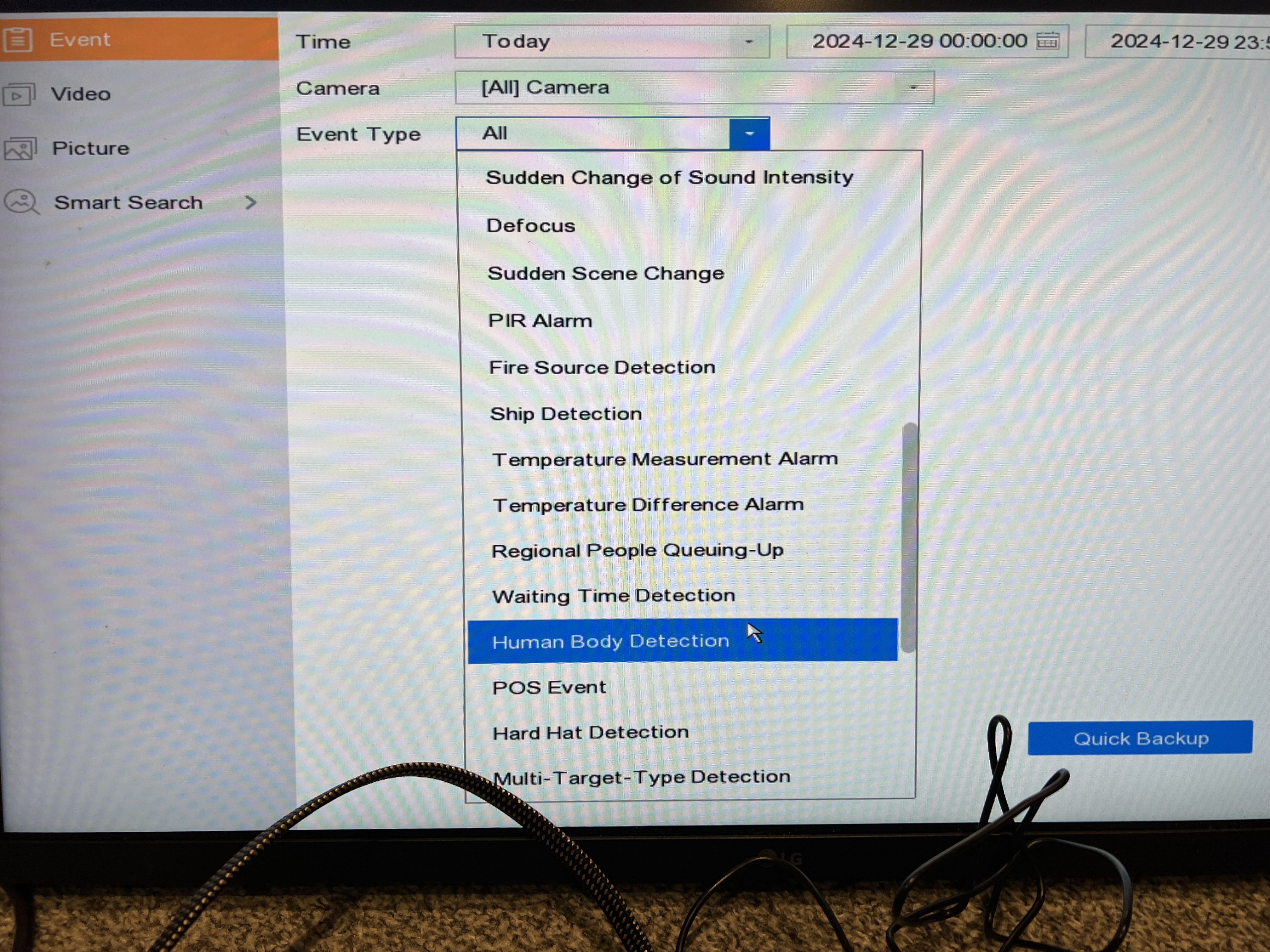

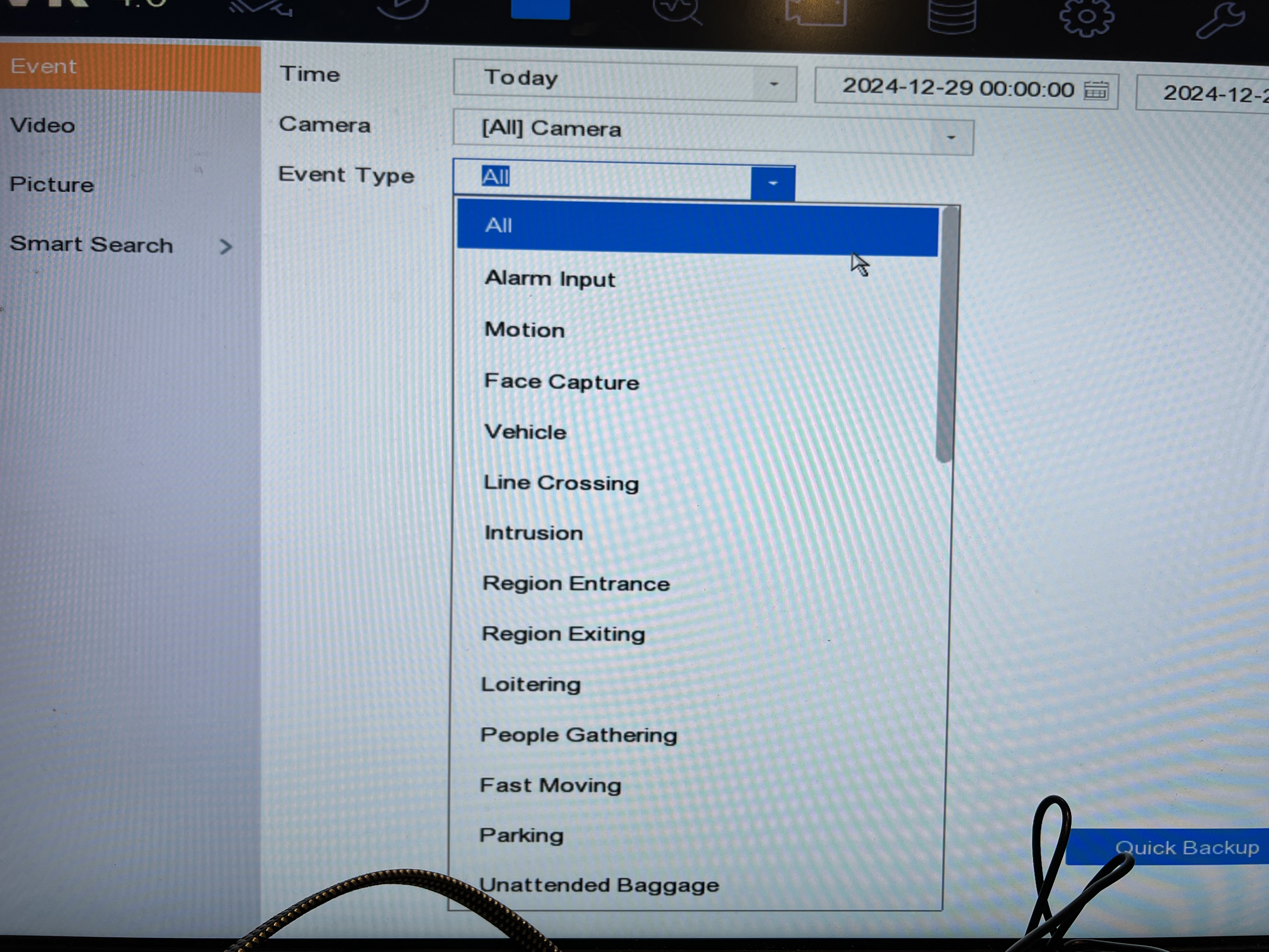

Question 1 So in the version 7732NI-M4 version 4.61.410 it has (as the screen shots) a drop down menu for Human, Vehicle, and face recognition in the search options which (face certainly I was surprised to see as i didn’t think M series could do face) my question is, as i upgrade does any of these 3 disappear from the search ability in the main GUI, as all 3 are important to me.
Answer 1 - The options in the search boxes will be there in the new firmware. What's actually usable is more to do with teh cameras capabilities and setup. IE you can't do search for faces unless you've a camera setup for face capture. You've an NI not an NXI so have no on NVR processing.

What threw me is, when you setup or search “face detection” in version 5 it’s actually called "target detection” it confused me so could find it, although when they show in the event centre, the event centre, it calls it ‘face detection"

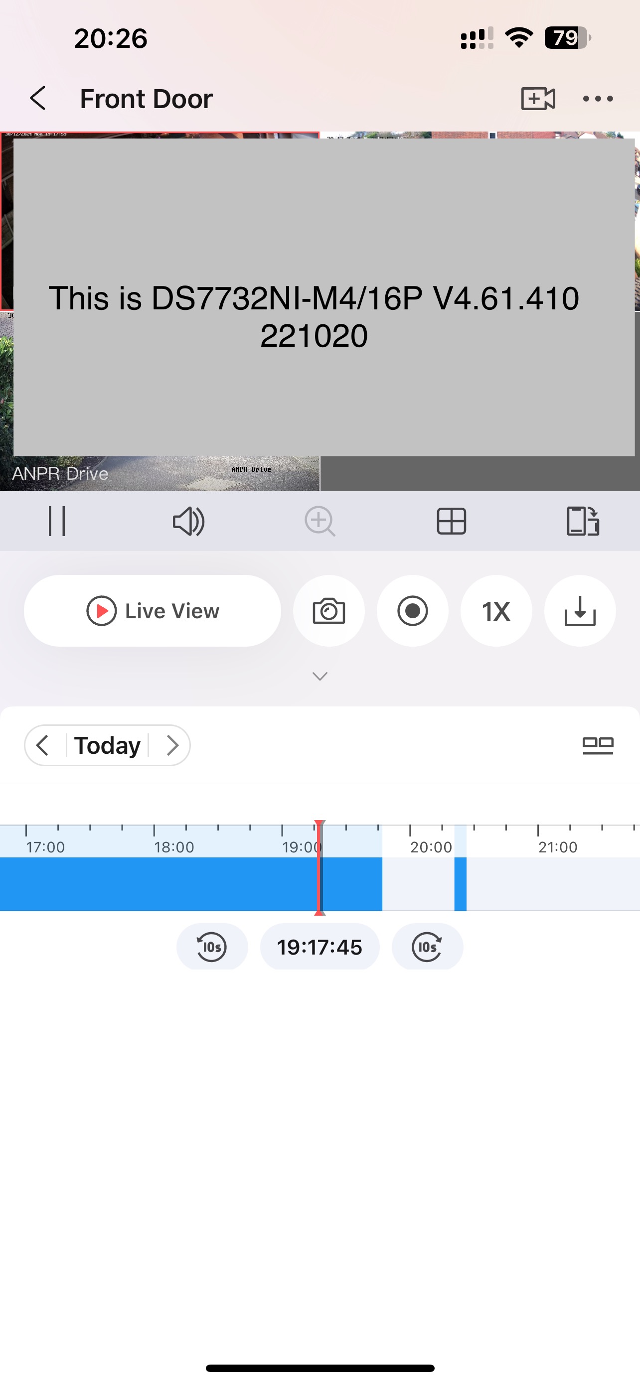

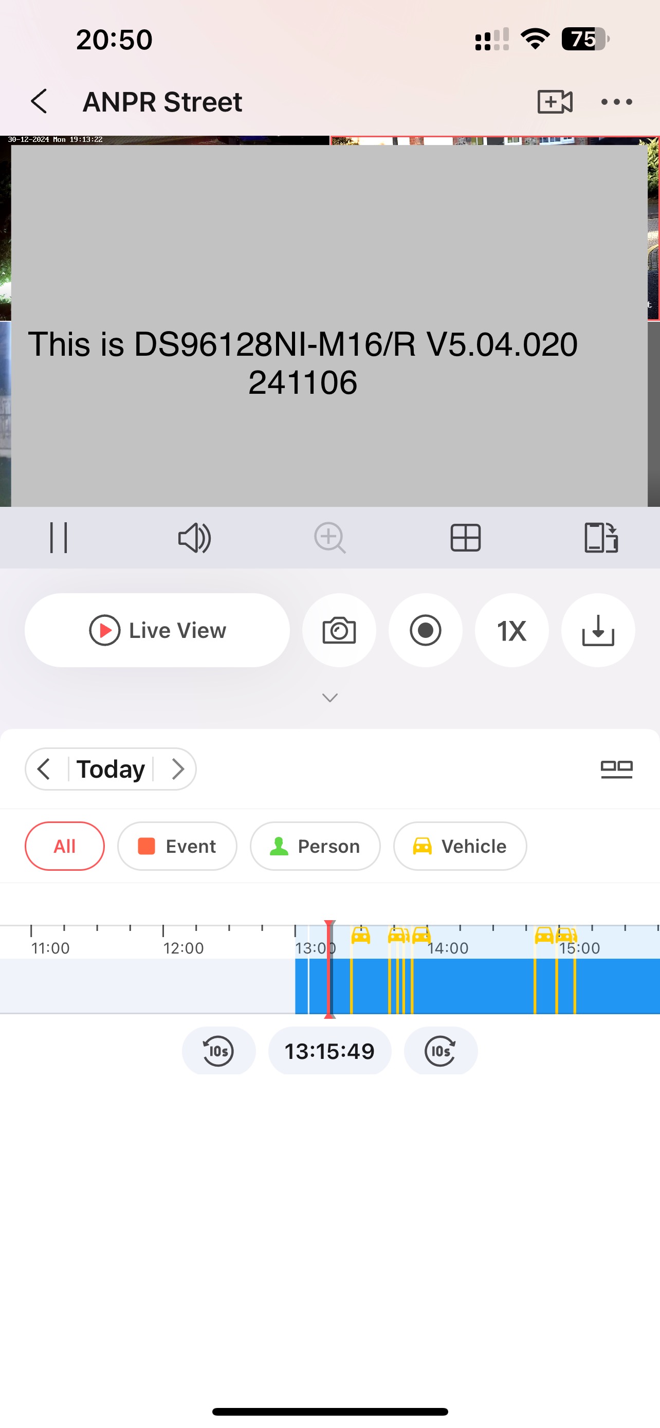

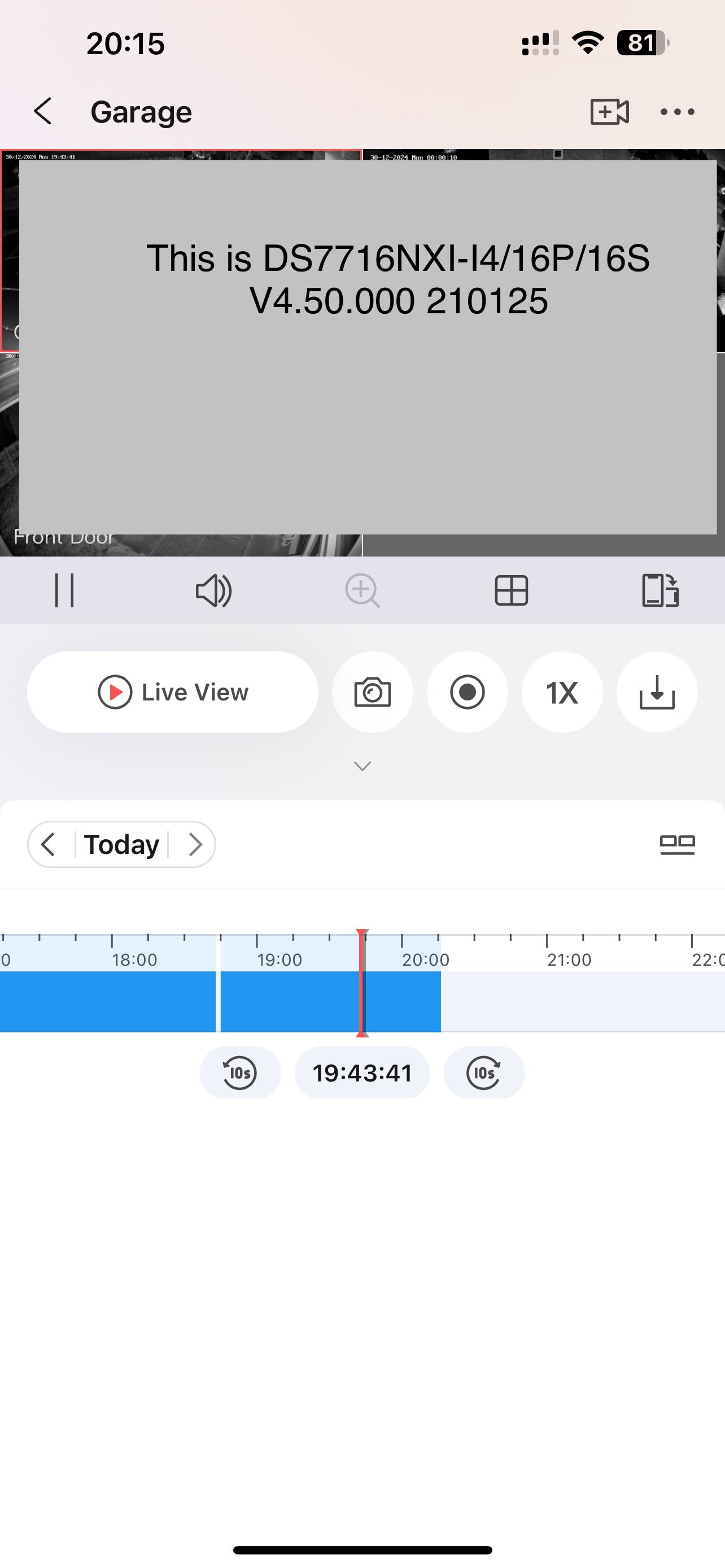

Separately I’ve never seen HikConnect searching, I’m possibly excited to see something everyone else has had for a long time, concerning searching events in Hikconnect ive noticed, I’ve played with a few units all with the same camera setup on the same network, and found.
The DS7716NXI-I4/16P/16S V4.50.000 210125 had no VCA set in the NVR, it was enabled and no change after a soak test, VCA events were not searchable in Hik-Connect
The DS7732NI-M4/16P V4.61.410 221020 had no VCA set in the NVR, it was enabled and no change after a soak test, VCA events were not searchable in Hik-Connect
The DS96128NI-M16/R V5.04.020 241106 had no VCA set in the NVR, and they were all showing in Hikconnect and searchable (is it only later software this works on? And I’m really behind the times?) It was enabled and no change after a soak test (I think) I would add my 4 line ANPR works fine on searches on HikConnect, my 7 line doesn’t bring anything up ANPR wise, either in the GUI or HikConnect (possible some more testing on this required)
Yes it can be confusing. Just select the default group in search then click through the options one at a time to see under what 'term' your events are named.

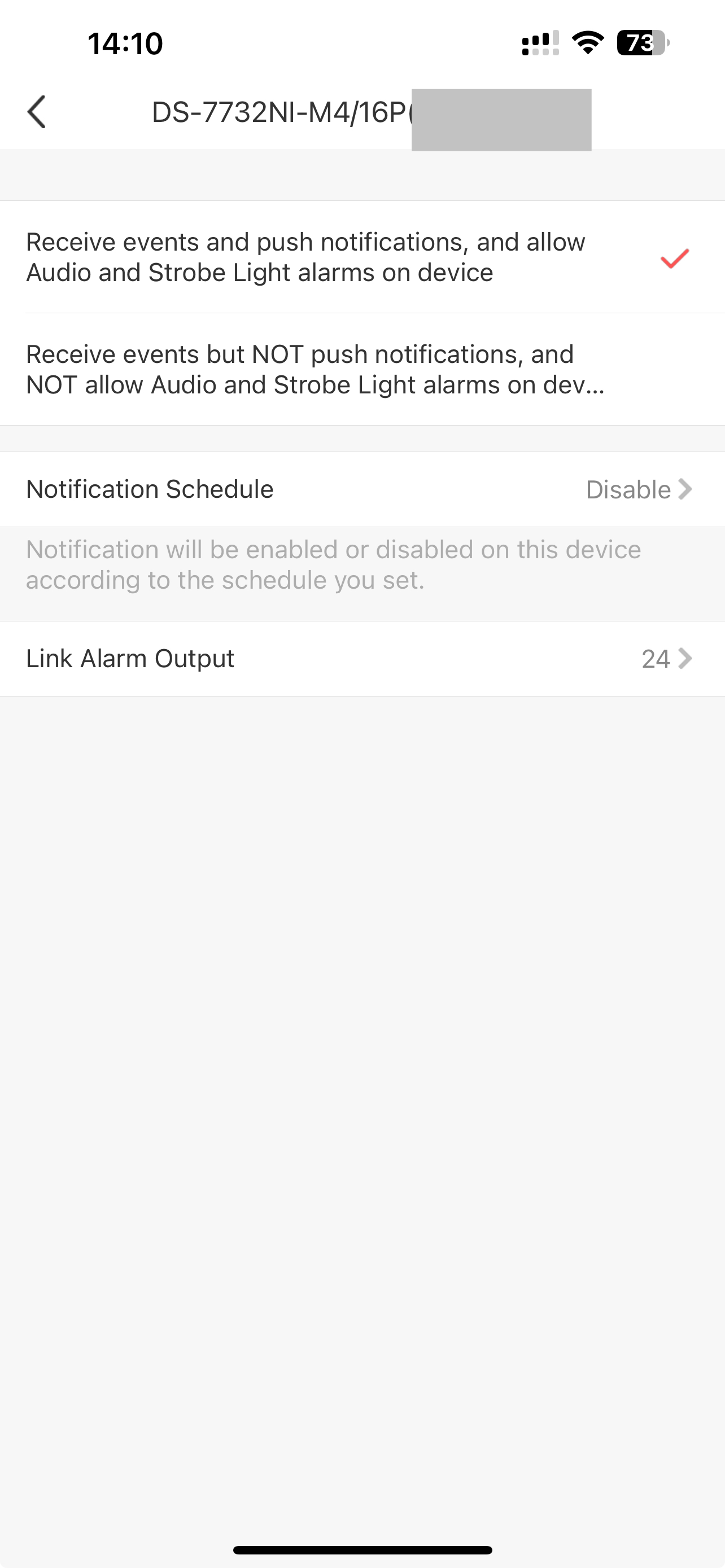

Problem 1 Hik-Connect disables notification no matter how I click and mess and save, anyone else have this or know a work around, all fine on my other unit.

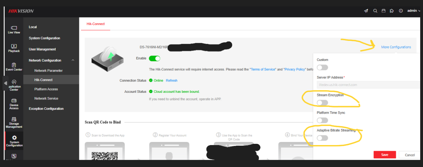

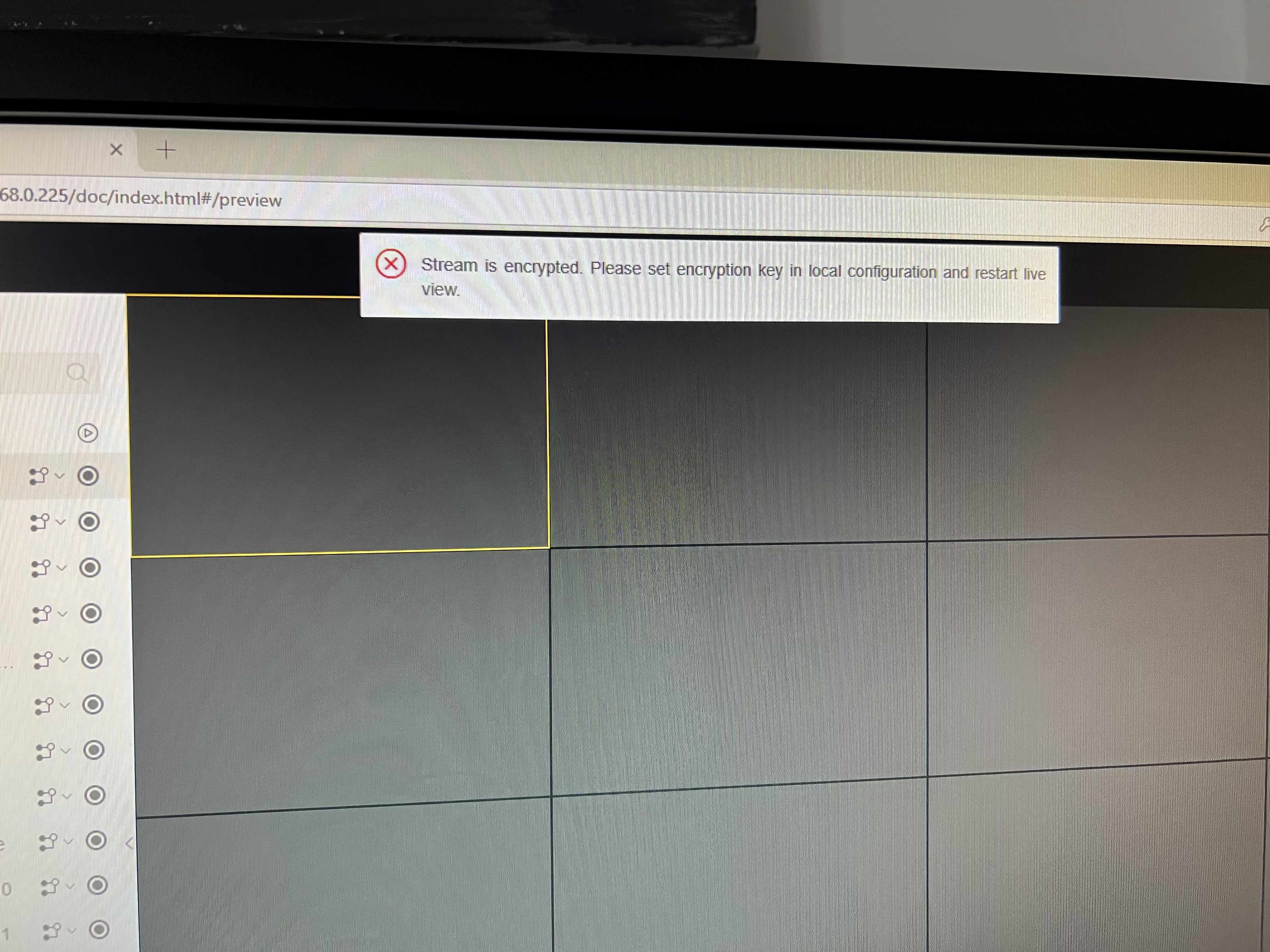

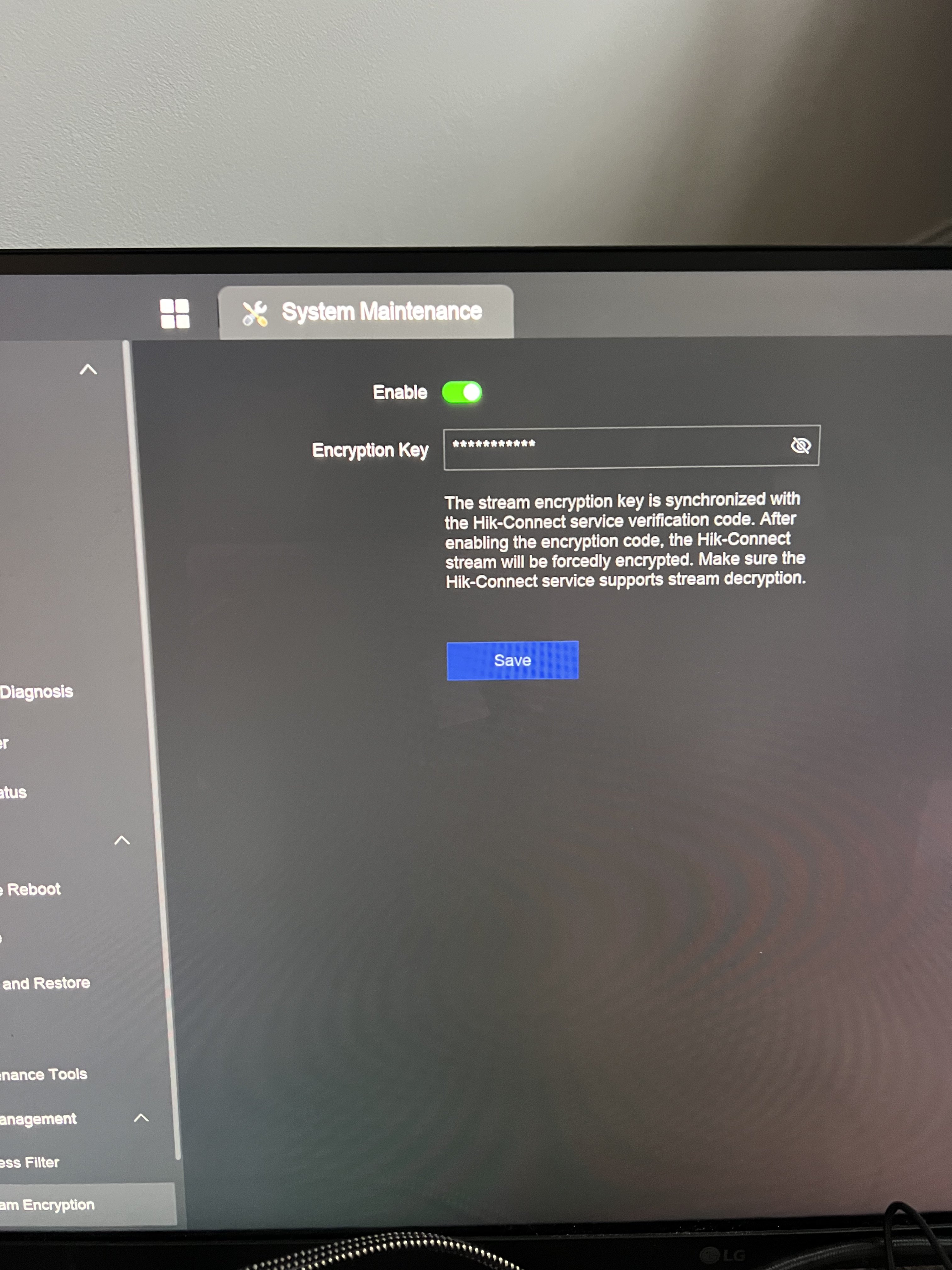

Problem 2 When on Chrome, or Edge, or IPad I get the stream is encrypted message, it’s setup in the NVR, what am I doing wrong??

This was also enabled and the same password as everything else and it’s not working

I had it turned on, I turned it off, it made no difference, I went onto the NVR and turned it off there also, it works, how bizarre.
Just need to work out why when I enable notifications and go back it immediately disables them.
Make sure that "Adaptive Bitrate Streaming" is turned off also... it changes your cameras sub-stream settings otherwise (unless you want that).

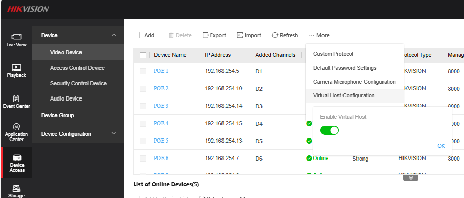

Did you find "Enable Virtual Host"... that took me a while when I upgraded to NVR5.0:

Have you tried again since disabling stream encryption?
Sorry I wasn’t clear in my first response, your idea got me where I needed to be, I turned it off like yours, and no change, I turned it off on the units itself as well in a seperate setting and it worked, thanks.

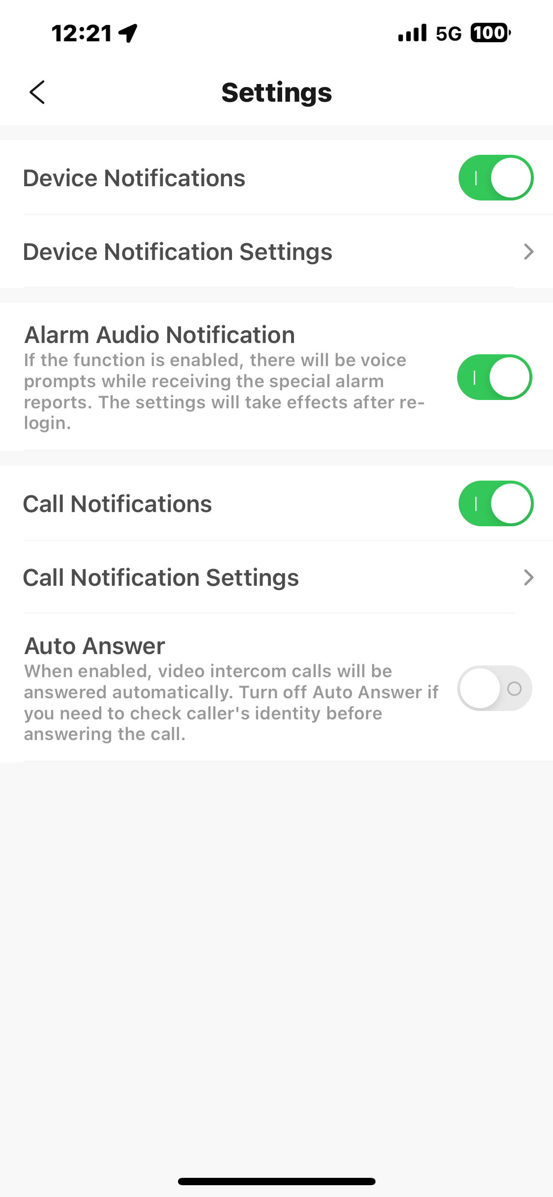

Just getting no notifications as it keeps turning them off in HikConnect

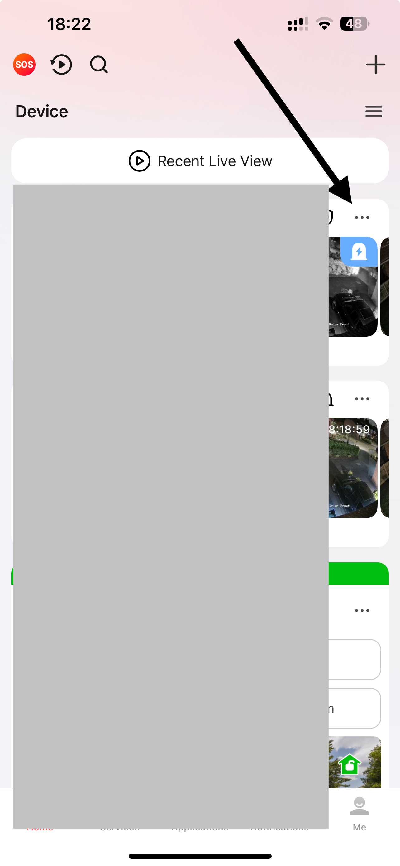

I think I see... don't go to Home/NVR Settings "the three dots"/Notification... instead go to Notifications/"the three dots in the upper right corner"/Settings and you will see "Device Notifications" on/off box.
If that's not clear let me know...
Appreciate the help.
I think I understood what you were saying however I’ve 3 options, I’ve put an arrow on each, I turned any combination or all on, and you go to the next and they’ve turned off again
