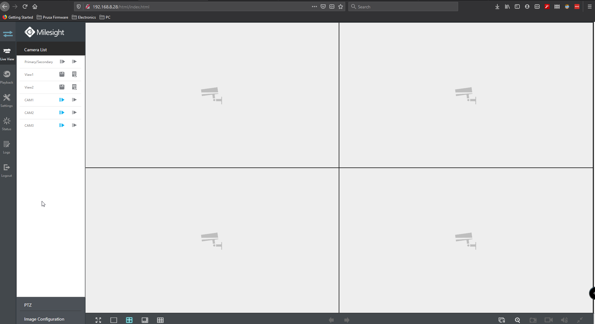

I have the following issue which am trying to pin point where the problem is, the setup is as follows:
NVR and Cameras have all the latest firmware updated 2 days ago.
LAN setup - DHCP via router 192.168.8.1 gateway
Milesight NVR - assigned by DHCP 192.168.8.28
Milesight Poe Nic 192.168.5.1

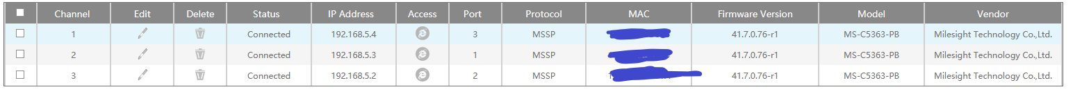

3 Poe Milesight cameras assigned by Milesight NVR 192.168.5.2 / .3 / .4
I can access the cameras perfectly well by m-sight pro android app either in LAN or P2P
I can access and view the videos on the TV via HDMI
I can access the NVR by DHCP assigned IP address using any browser am using specifically firefox latest release.
I can access the cameras individually via the web browser milesight GUI based on the assigned ip address by the Poe Nic 192.168.5.1.
When I load the browser via the 192.168.8.1 login and password app live view wont load the cameras on the main screen reference the screenshot.
I have setup the about:config for firefox, 2 java flags set to true as mentioned on milesight and clear data and cache restarted the computer but still no go.
I am missing something here or something I overlooked.
Any input would be appreciated.
Thank you

Okay rebooted the cameras reset the ip's now its working hoooray!!!
