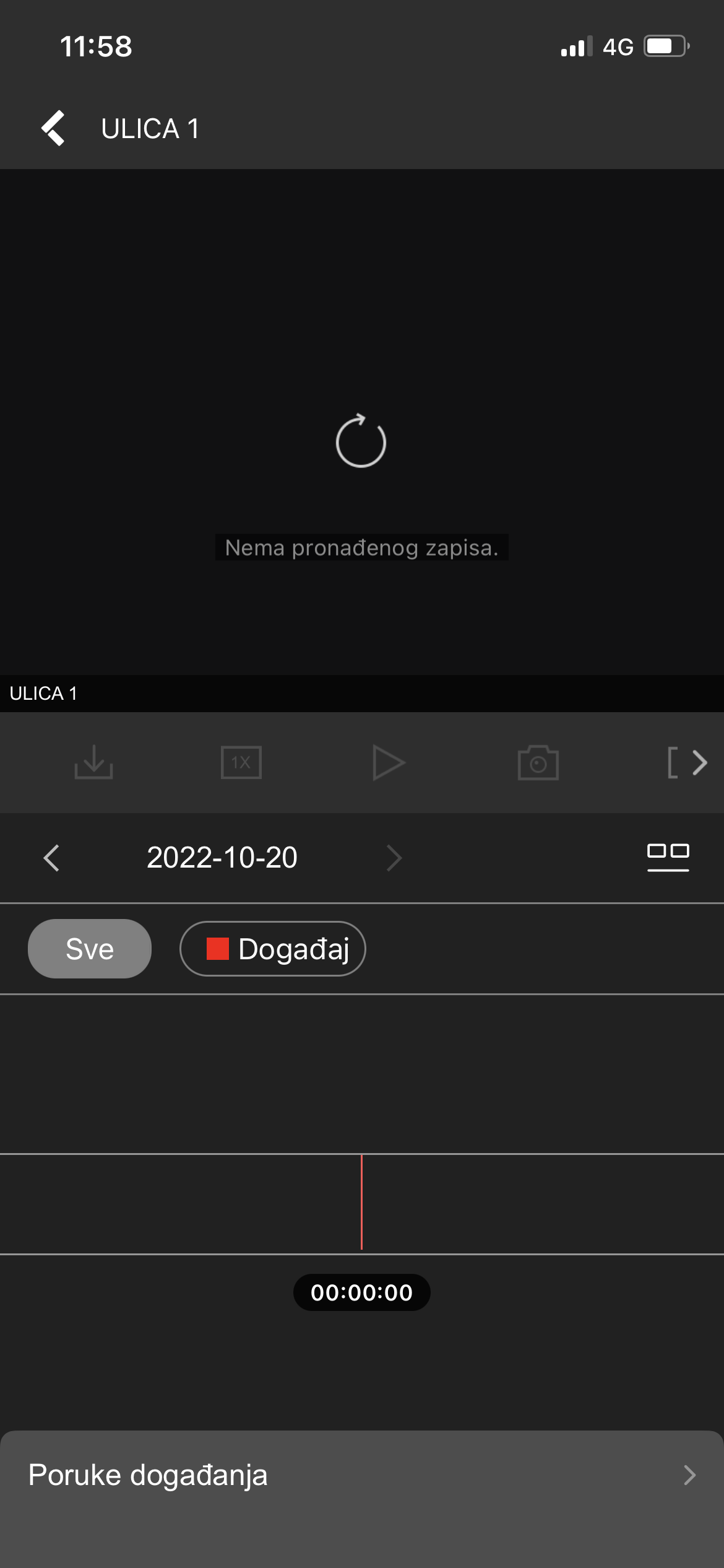

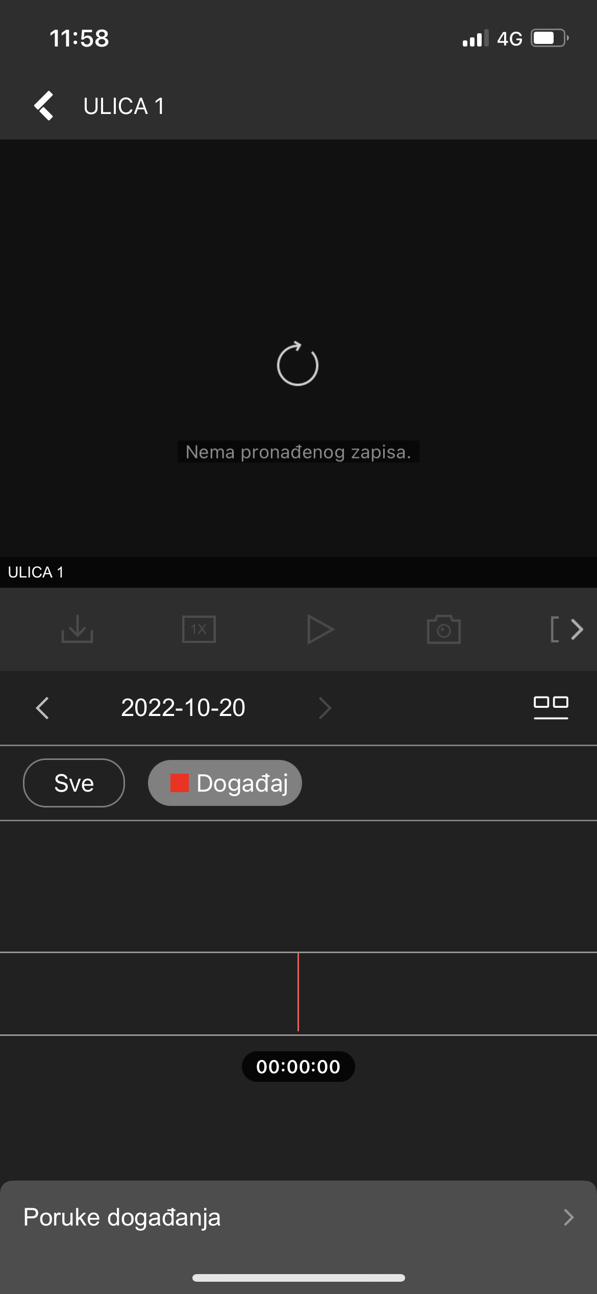

There is a big bug, I can no longer see anything recorded under playback, although the dvr records properly and I can view it when I connect directly via the ip address.
Hi @tomycrosound
Can you share a screenshot of what you are seeing when trying to access Playback?
I have just updated our app and am not having any issues accessing playback
That's it.. There is nothing recorded anywhere, not even on previous dates.
DVR records properly. Everything was working until the application update.
Interesting, when we are viewing playback it does not look like this.
What NVR/DVR model are you trying to playback? What firmware version is that recorder running?
Can you please translate what those 2 buttons say? (we don't get them in our app)
Iphone 12, iOS 16.0.3, version app 4.27.0.
DVR is 7204HUHI-K1, firmware 4.25.001
This button are new from this update, left: "All", red square : "Event" (cannot change event to somtnhing else)

@tomycrosound maybe try asking the user in the above thread if they are also seeing similar playback issues, it looks like they are running a newer version of iOS so it could be a compatibility issue with the new version of Hik-Connect not working on older versions of iOS.
thanks @tomycrosound
sorry, I misread your message. Thought you were running iOS 12 but you have iPhone 12 running iOS 16.
Looks like it is either going to be an overall iOS/iPhone issue or possibly a specific issue with the compatibility of this new Hik-Connect version with your DVR firmware.
I had initially thought it was a cloud/local storage issue because the new update allows you to switch between cloud and local storage, but if you have no cloud storage configured it will display no recordings.
But from your screenshots, I can't see any way to switch between cloud & local recording on the iOS version of the app.
Fix in 4.27.2!

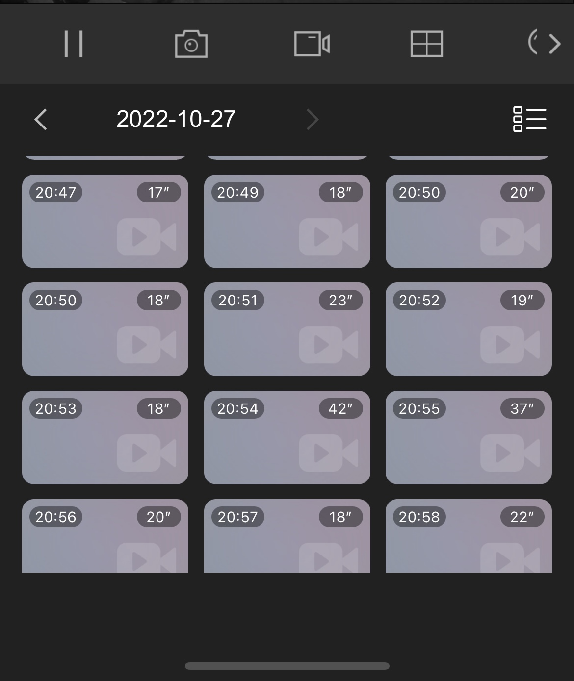

Do you have a snapshoot of motion on these shots, or is it gray as well? It would be great if it showed thumbnails!
