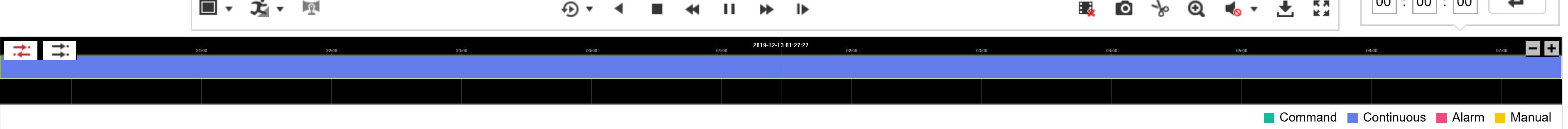

Thanks @Dan good news they are lookign into it. I am actually away at the moment without access to a 4K display. Hopefully @fullboogie could post an example - It's when playing back an NVR recording (in my case on an I series NVR) via the web interface running on a 4K display - the timeline at the bottom where the motion alarms appears etc is tiny.

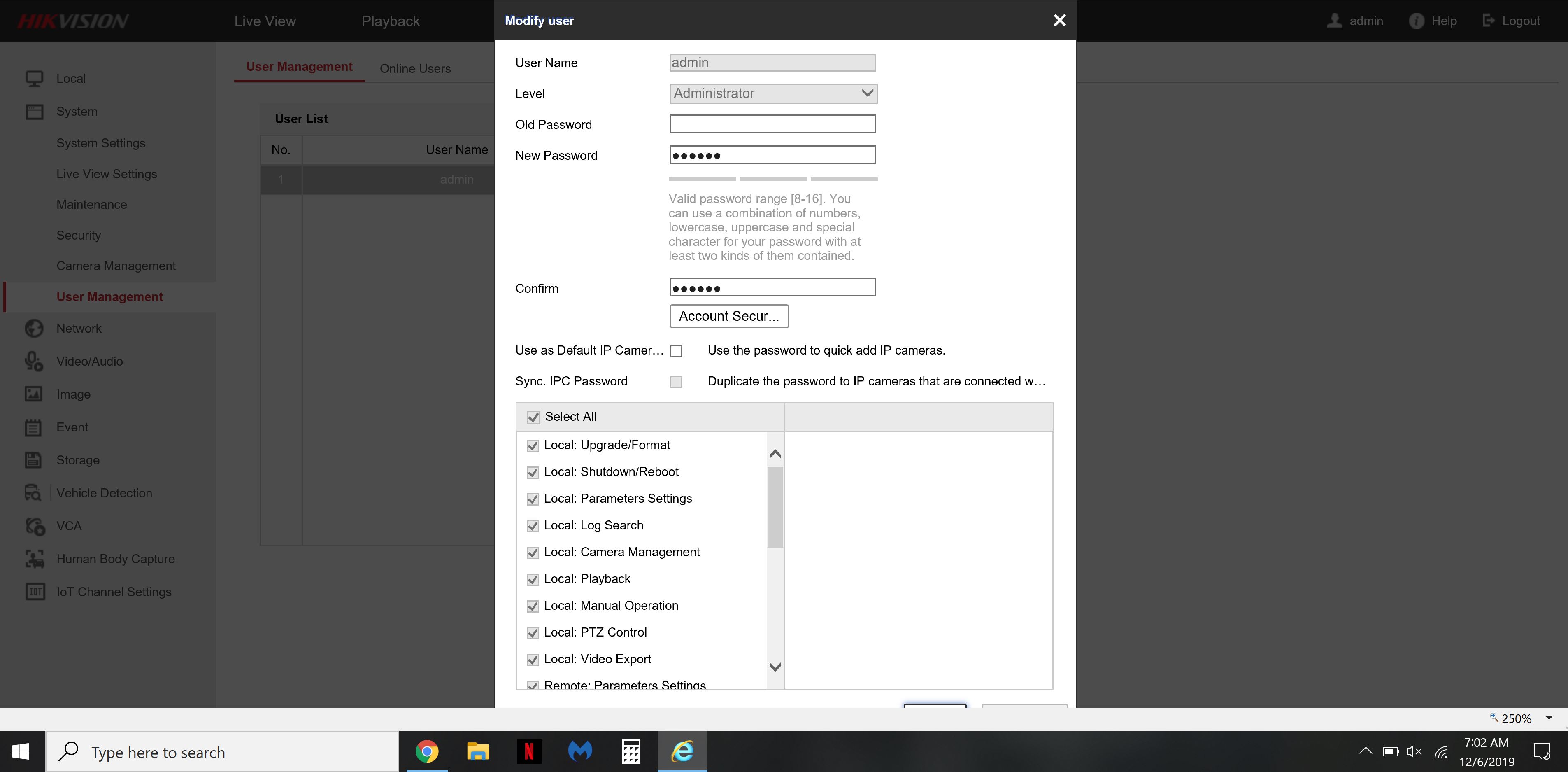

Here is an example of what happens when attempting to modify a user account. The "OK" and "Cancel" buttons are off the bottom of the screen so it's impossible to confirm any changes. I can only hit "X" and back out. No scroll bar on the side either.

Clive, that screen is not affected on my system. For whatever reason, that one appears in full.
Interesting - does the timeline text at the bottom appear in tiny almost unreadable characters?

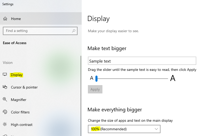

If you have any Windows font adjustments, in accessibility or display customization it will play a factor:

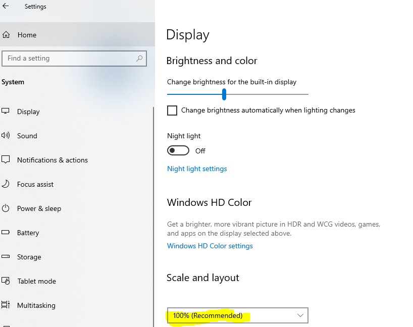

Or in Scale and Layout:
These settings often impact desktop apps ability to display fonts correctly.

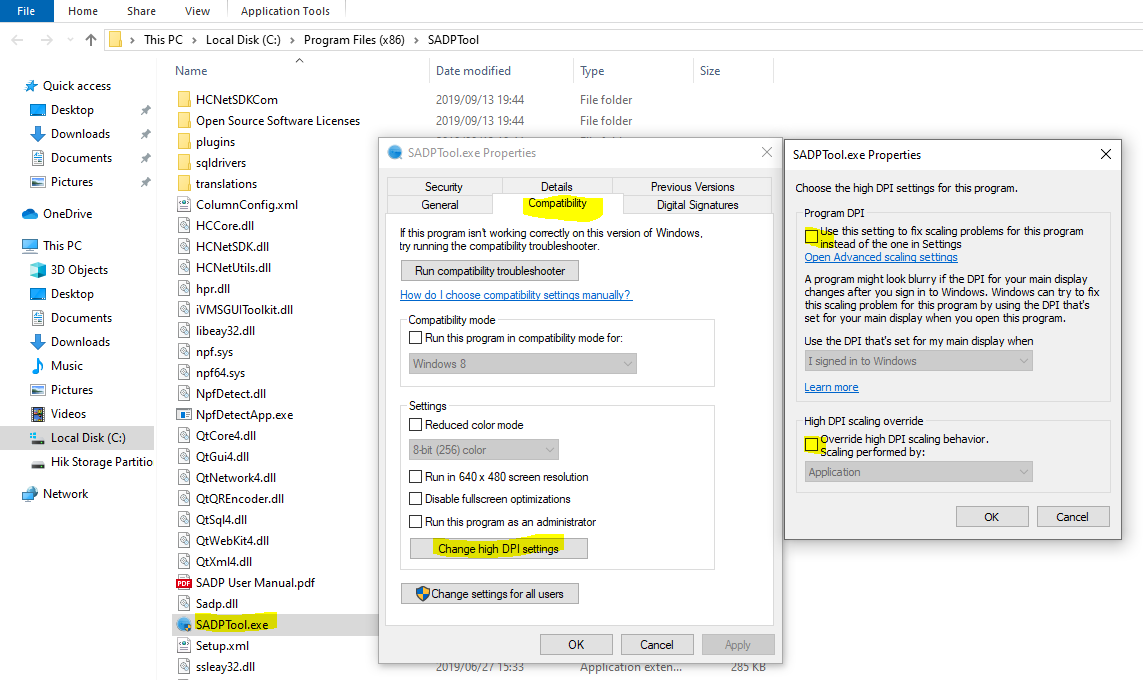

A possible workaround for SADP - Locate the executable file, right click it and select the compatibility tab. I've never tried this as I don't own a 4K screen but I'm keen to hear your feedback.

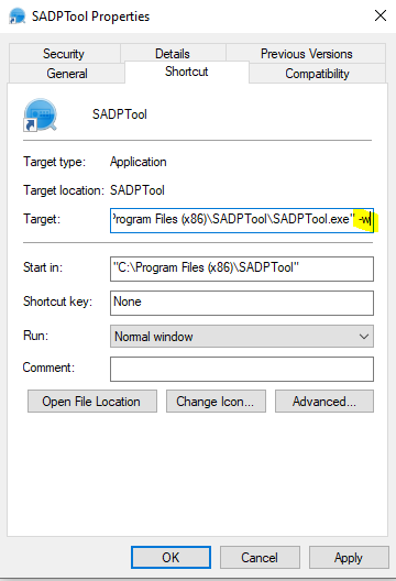

Failing that, you could run the app in windowed mode. Edit the SADP shortcut and add '-w' at the end of the Target field which will force it to run in its native resolution (hopefully).

The playable timeline you refer too is rendered in a canvas element of HTML5. Not sure how you could set this to auto adjust unless you are willing to edit the code yourself. Keep us posted.
Stewart - I spent some time on this tonight. Nothing under the compatibility tab worked, and I tried all the options. And the "-w" did not work either. Thanks for all the suggestions.

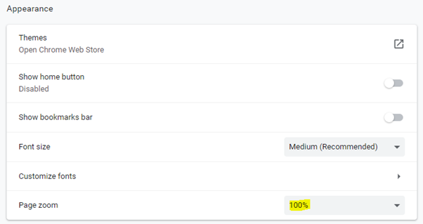

In Chrome under settings/appearance, check your Font size and Page Zoom are set to default.

All of my problems are on an HP laptop with a 4K screen. Page zoom is, in fact, set to 100%. I don't have any problems in Chrome - my problem is being unable to read anything in the SADP tool and other issues in the web interface per the picture above.

Another edit - now I see what Clive has discussed. In the playback timeline it is impossible to see the fonts/numbers above the timeline. Seems I have the same problem.
