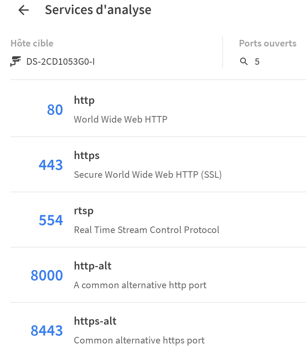

The camera is visible on the network and I can discover the 5 open ports. All seems OK.

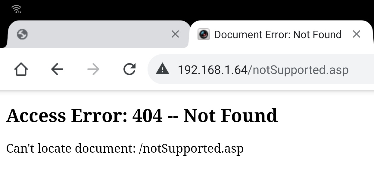

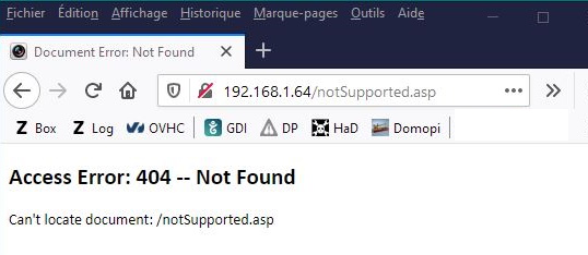

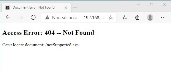

However when I connect to 192.168.1.64 I have no functionnal access.
A 192.168.1.64/notSupported.asp page is displayed
after a quick display of 192.168.1.64/doc/page/login.asp9_[a variable number] which is visible in the history of my browser.
I've tried either with Firefox, Edge or Chrome.
I fully disppointed. Has anyboby an idea of the problem and it's solution?

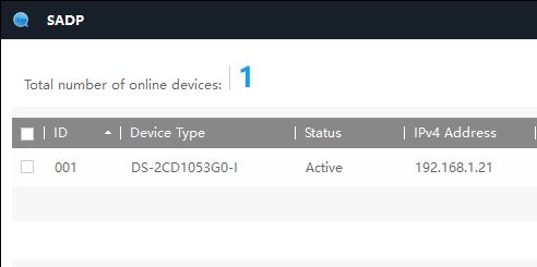

I've installed SADP and discovered that the camera was inactive.
I made it active and set DHCP in order to suppress the conflict with my Netgear relay.
Fine the camera is now at 192.168.1.21
