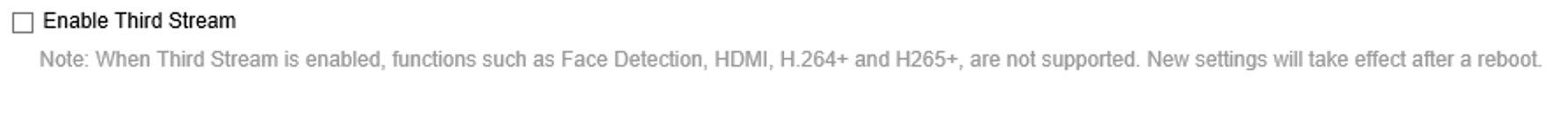

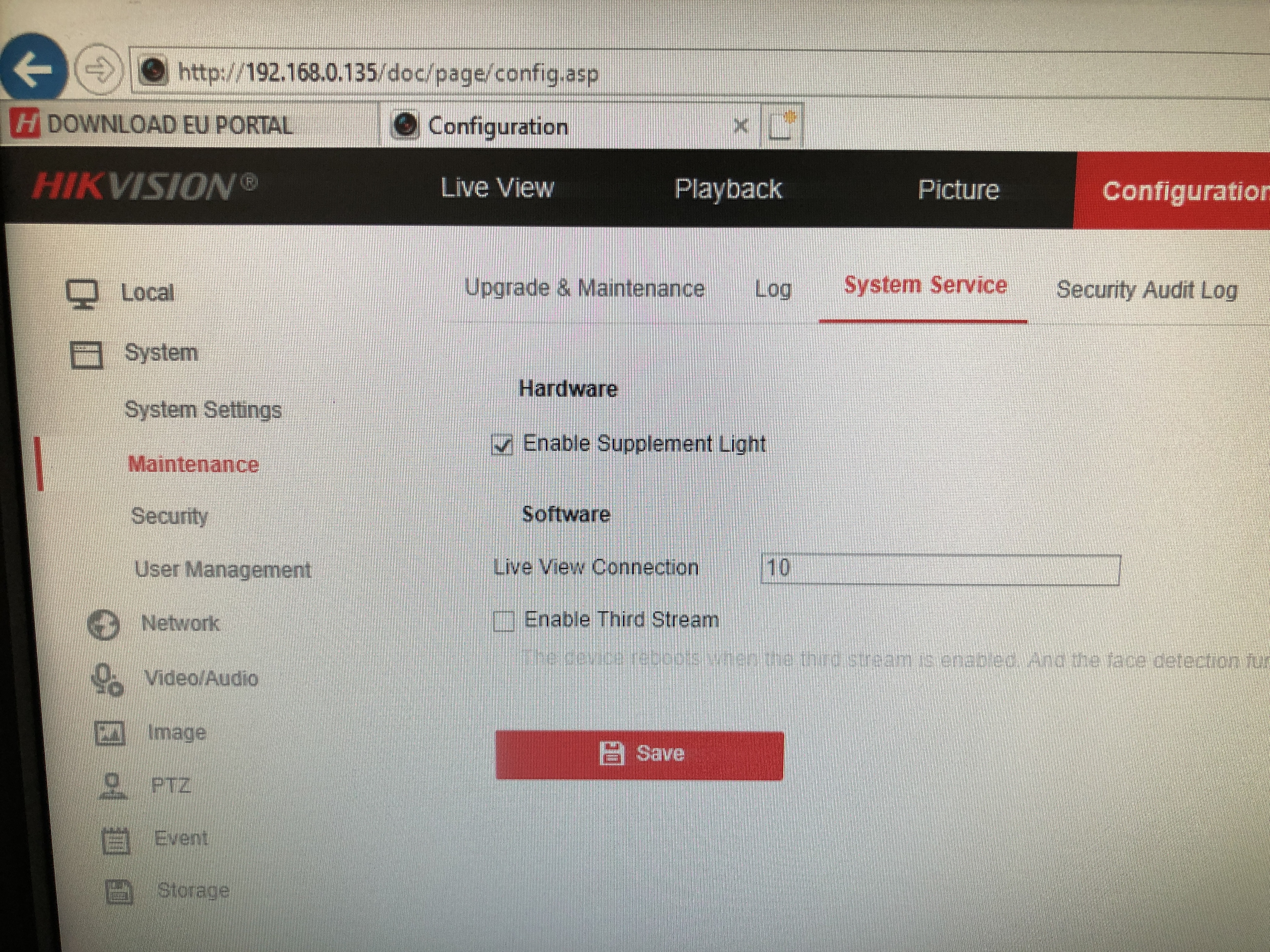

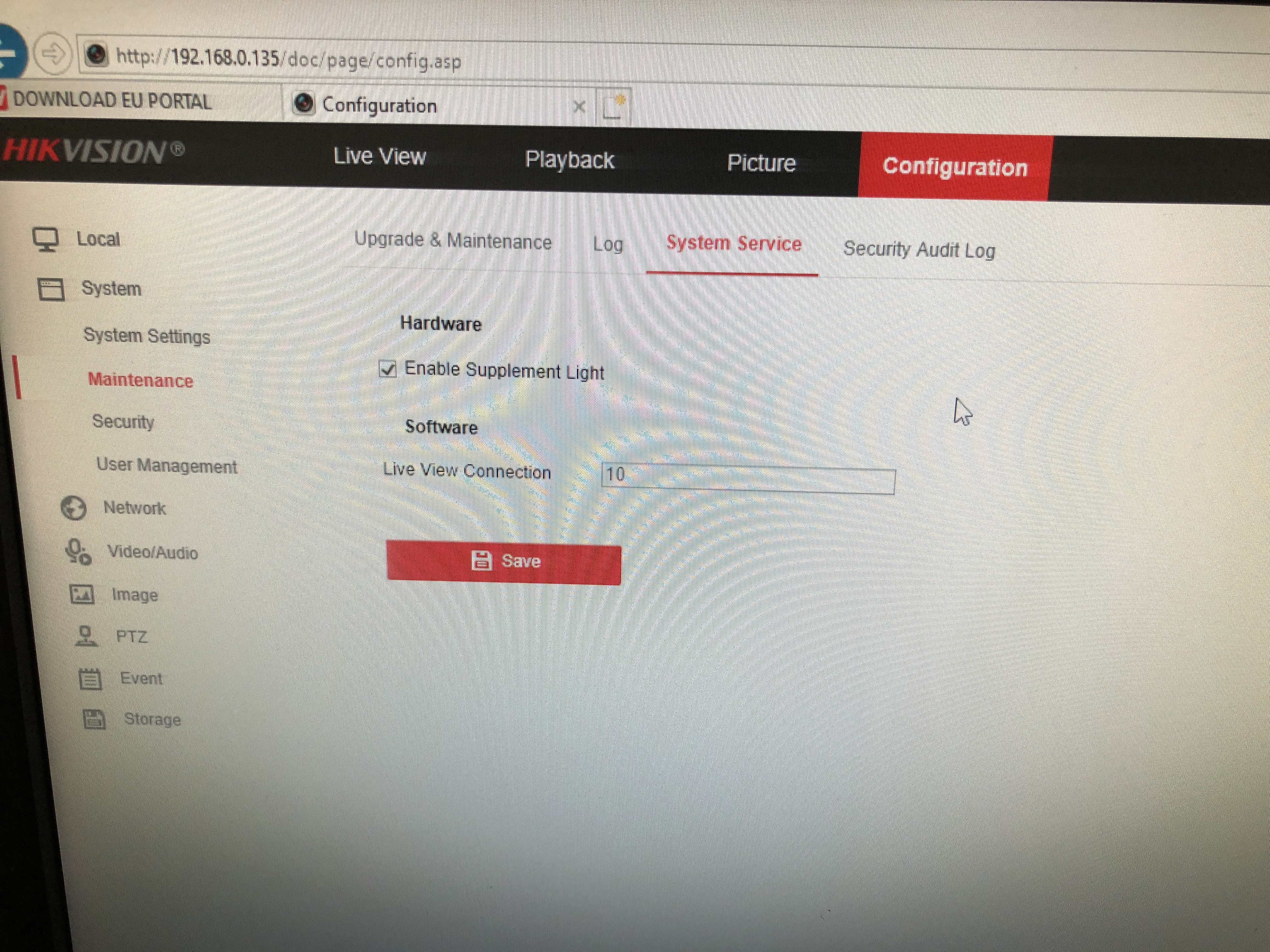

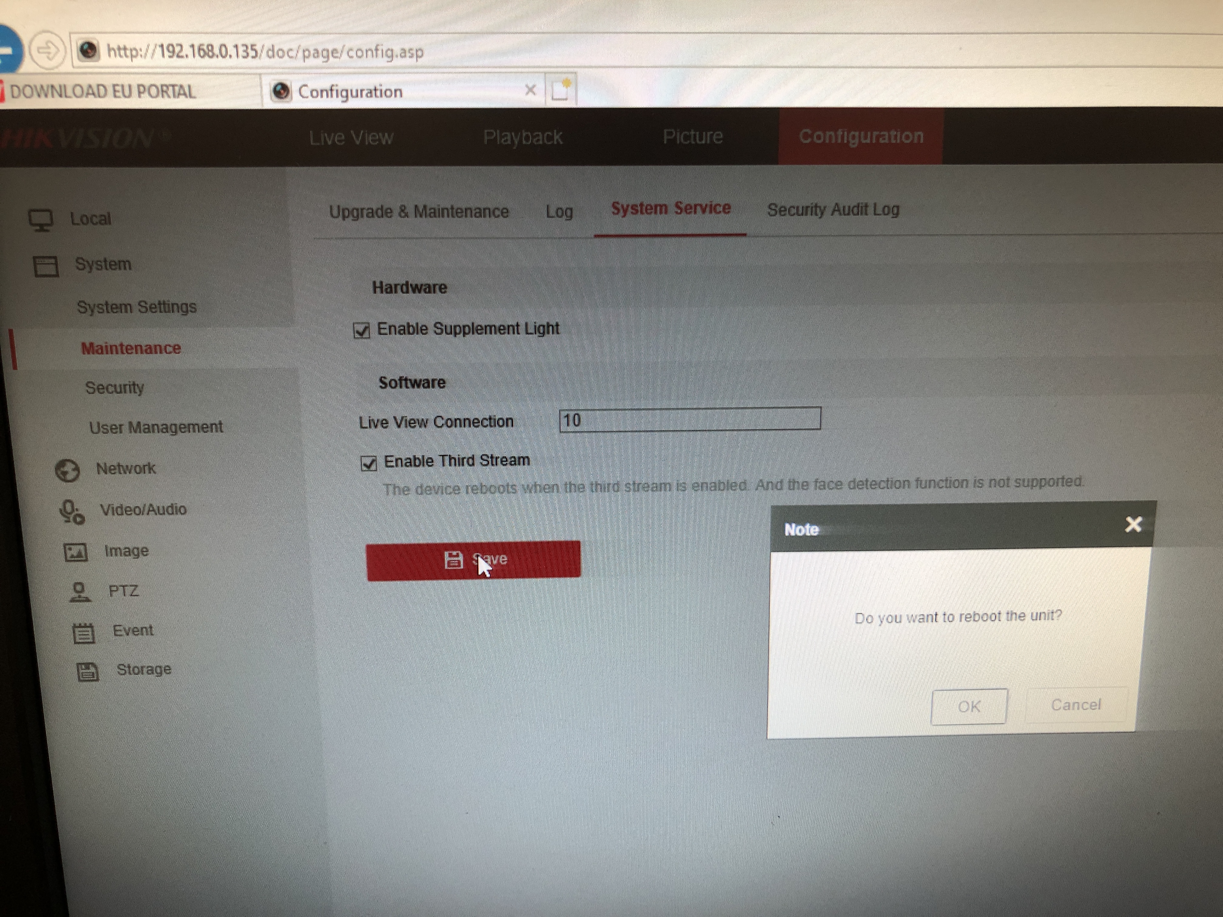

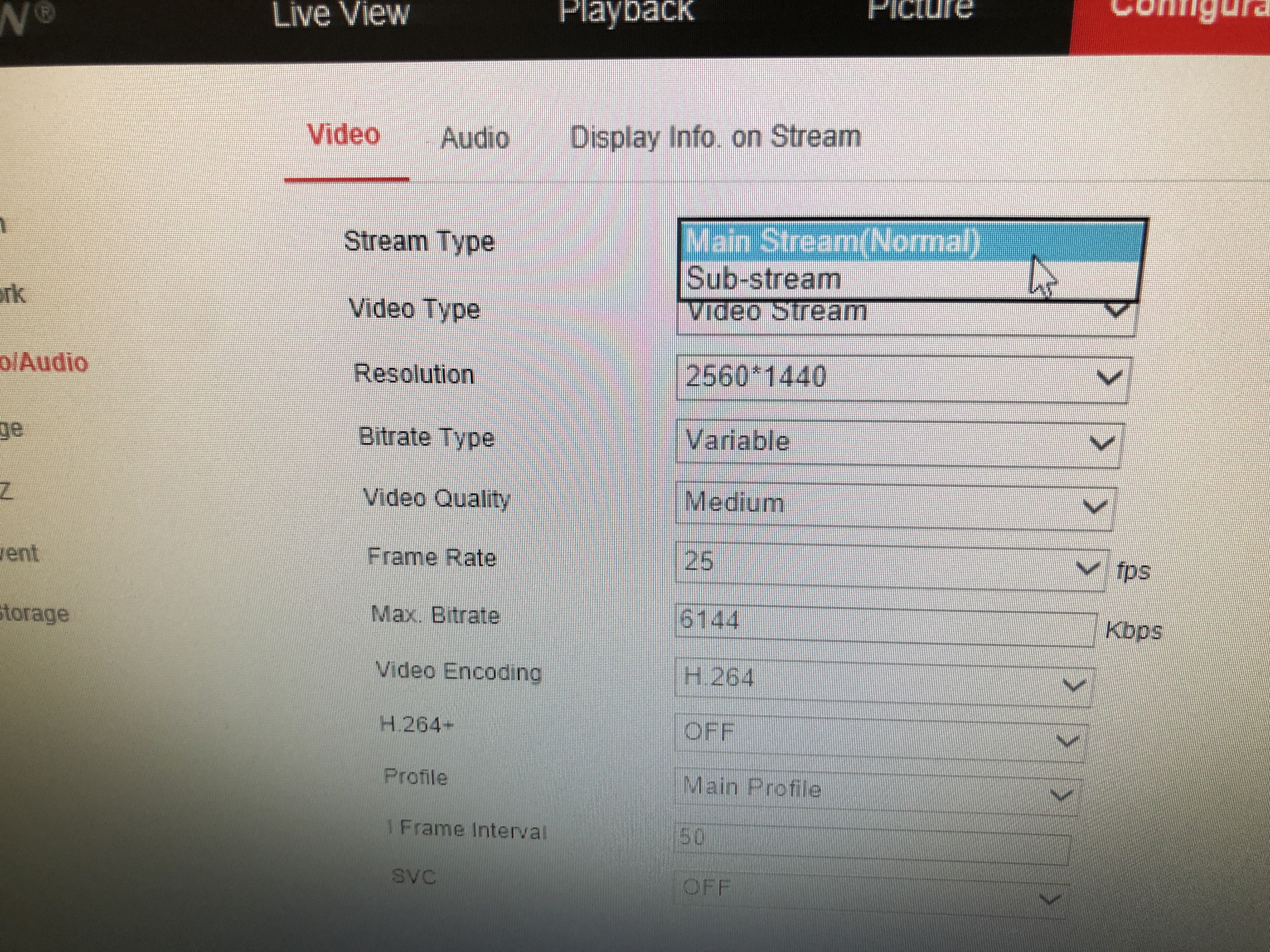

I've recently purchased a Hikvision DS-2De2A4040IW-DE3 PTZ for use in my 'Owls in the tower' project - as I liked the idea of being able to zoom in when the owls are in residence. I also liked it because it had the option of a third stream - which I could use at H264 for the RTSP feed - but still use the primary stream for recording to the NVR at H265. From factory fresh when I log in to the IP based portal through Internet explorer - the option to 'tick' for a third stream is there, and on doing so, it tells me that it needs to reboot. On rebooting however, the third stream doesn't appear in the drop-down of video parameters, only main and sub are there, and the option to tick for the third stream has mysteriously disappeared. When I set the camera back to default, the third stream tick box appears again, and then when it's rebooted, disappears again.

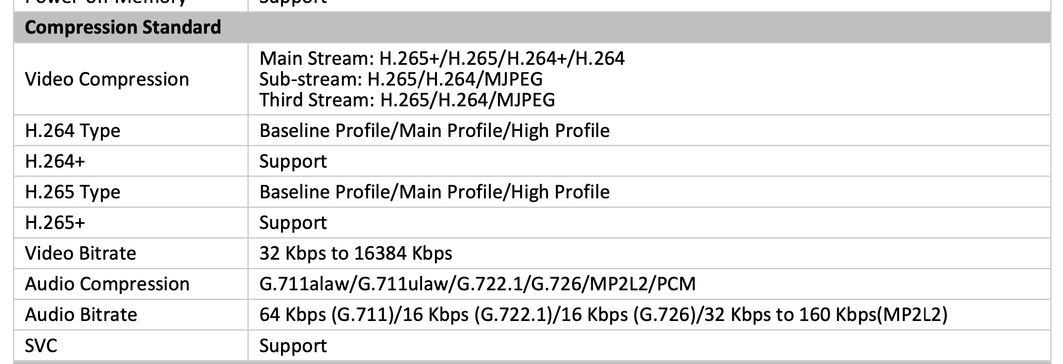

This is from the camera data sheet:
