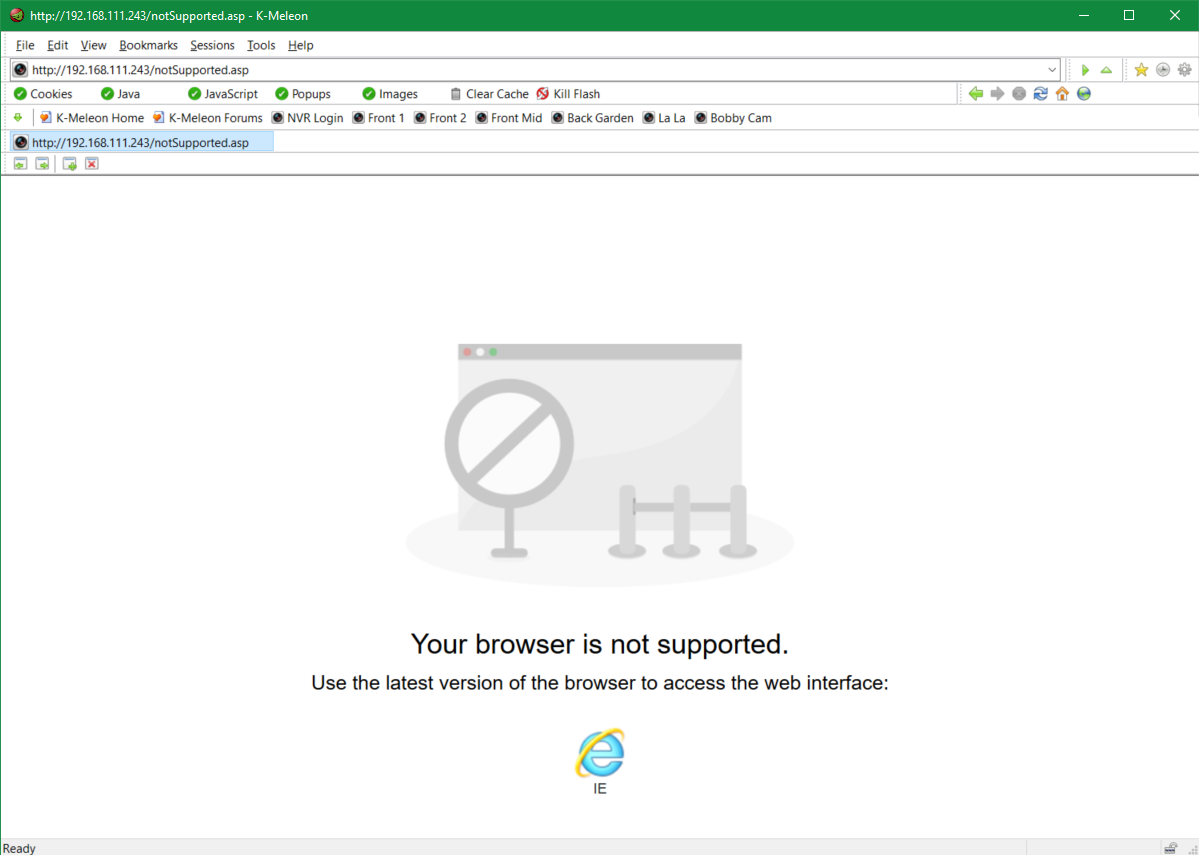

OK, upgrades finished, but #2 and #6 are now displaying an error message when I try and login with Firefox, K-Meleon, etc...
Your browser is not supported.
Use the latest version of the browser to access the web interface: Internet Explorer
#5 didn't like the firmware
#3 will still not go into full screen mode on the NVR

Modern browsers like Firefox and Chrome no longer support the plug-in used by older Hikvision models like your K-series NVR, so to access with a browser you will need to Internet Explorer (or Edge in IE mode).
Alternatively, you can use Hikvision desktop software - iVMS-4200 - to access the NVR and cameras.
Many browsers have not supported the plugins for many years, K-Meleon does support them, but it is the firmware not the browser that is displaying this message.

Can you please try installing the LocalServiceComponents plug-in?
Where exactly are you seeing that browser error message? Is it when trying to view the live views in the NVR or when accessing/logging into the cameras directly?
Already installed.
I've checked the returned page source code and it's coming from the camera:
Thanks @HorizonIT
We've never seen this error message before, we think it is actually specific to K-Meleon which we've never used before.
Have you actually tried accessing the NVR/cameras with any other browser? Do you get the same or similar messages in any other browser?
Are you using a Windows 10/11 PC to access the NVR/cameras?
Okay,
Do you have access to Internet Explorer? Are you using a Windows or Linux device?
