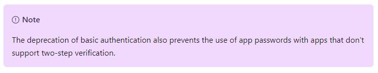

I've just spotted this in the Microsoft item I posted the link to above:
I guess that kills the idea of "app passwords" being a solution.
