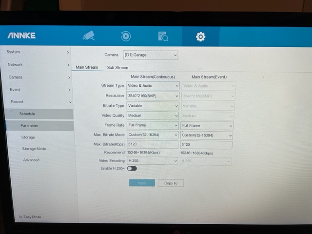

The cameras all have the same settings:

Thankfully for me, before I got up on ladders and dismantled all our hard work, I needed to contact Annke as after I'd factory reset the NVR and set my password to the exact same one as before it wasn't recognising the password when trying to log in to the NVR via the browser. I was explaining my frustrations to the guy who answered the phone and he suggested changing the 'Max birate mode' from 'custom' to 'general' and selecting the max bitrate of 1792. The system now works perefctly on live view, playback and viewing notifications via the NVR and via the app.
