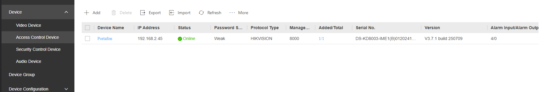

Okay, i dont have serie 6 now to test but modular on 3.7.1 works well. But my firmware is lower on NVR V5.04.060 build 250523
