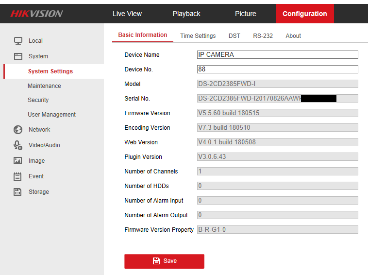

Update 25th February 2020 - Superseded by V5.6.4: Latest HikVision Firmware for G1 Series cameras - version V5.6.4
Hikvision have released V5.5.60 for their G1 series IP CCTV cameras
You can download the firmware from here.
It's not available from their European portal yet, but should appear here in due course.
In the absence of full release notes, please check our post here to confirm whether your camera uses Hikvision's G1 firmware.
