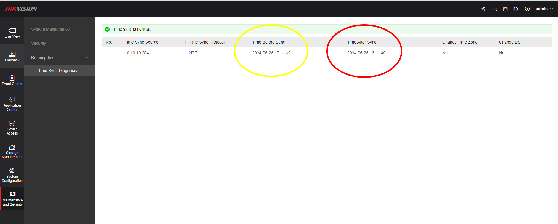

Dear HIK Developers (if you're still following this thread).... FWIW, the time shown on the Time Sync Diagnosis web page is erroneous.
The "time before sync" is accurate or at least reasonably close to real time.... but the "time after sync" fails to correctly account for the DST Bias of 60 minutes.
Included below is a pic of that web page..... and a copy of the LOG record for that same time sync period.

1 2024-6-26 17:11:40
Major Type: Information
Minor Type: Time Synchronization
Local User: N/A
Host IP Address: N/A
Parameter Type: N/A
Camera No.: N/A
Time Server IP Address: 10.10.10.254
Time sync source: NTP
System current time: 2024-06-26 17:11:40
Time before modification: 2024-06-26 17:11:38
********************** LOG END*************************
