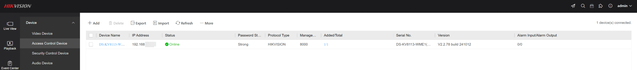

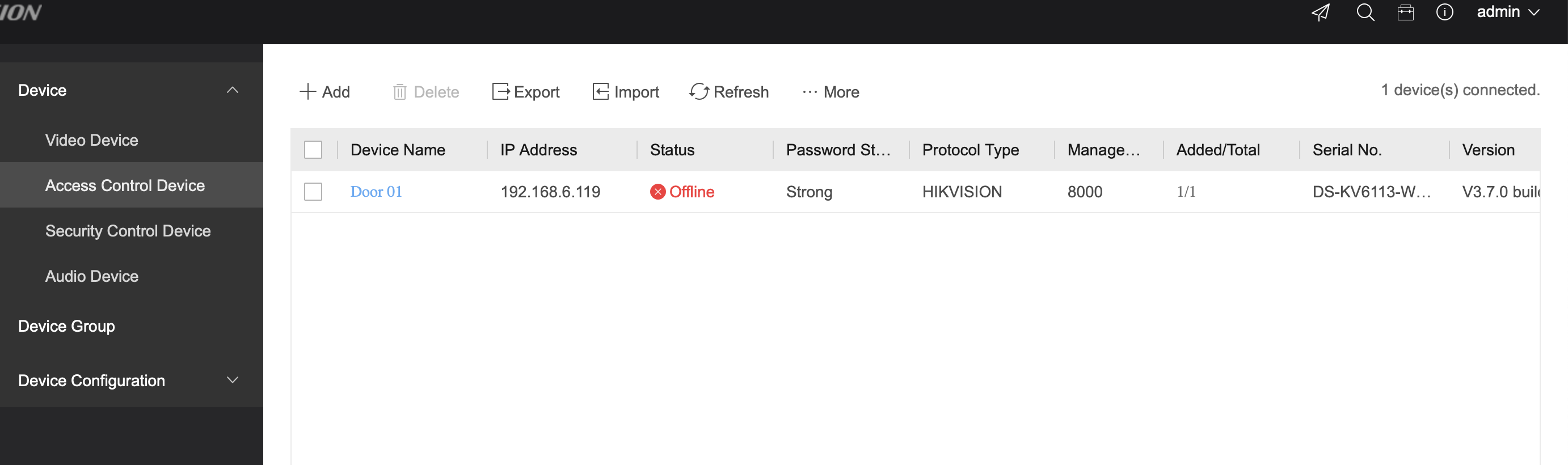

Just an update to say that the intercom device compatibility has been fixed on V5.04.050 build 250124.Update on this issue - Hikvision have told me that this fix has been postponed until the next M-Series firmware update.
Here's their reply to me:
I'll test and confirm when the new version is released.
You now need to add the doorbell as an Access Control Device rather than a Video Device and use the 'HIKVISION' protocol type, which should allow you to set motion detection and motion-based recording on the doorbell's camera:
If you have any feedback about this firmware, please feel free to post in this dedicated thread:
