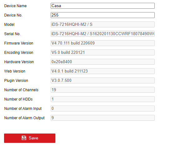

Recently ive moved to my new DVR iDS-7216HQHI-M2/S and new cameras, everything is fine and up to date on the dvr according attached picture its up to date, and ive got 13 ahd FHD cameras connected and 3 ip cameras.

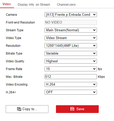

Recently ive ordered a ds-2ce12hft-f28 from aliexpress and saddly i couldnt get it working properly. When i attached it to the DVR i was getting a strange 1280x1440p lite resolution and i couldnt change it, the camera was connecting using TVI mode, ive tried several times to change the mode through the button mode, and tried to keep AHD mode, but the image was very bad, plus i couldnt switch to 5mp resolution. So ive kept the AHD mode and tried the PTZ menu resolution, changing it to 5mp manually, after that the camera went offline as you can see in the attached picture, ive tried a lot of things to get it back on, bit rate and etc but i wasn't lucky. Any help?
Already tried another power supply, short cable directly on the DVR, pushed the button mode several times and nothing happens. Already tested the DVR channel with another colorvu FHD camera and its all fine.
