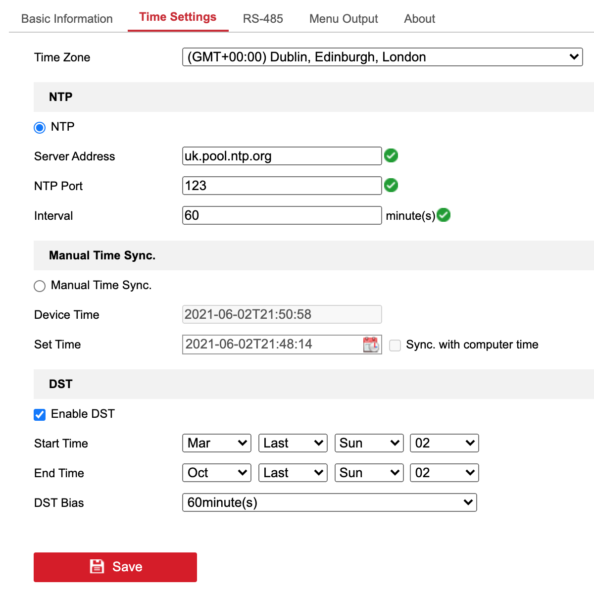

I have copied the same settings from the browser in the NVR GUI but the time is still 1 hour behind. Any suggestions?

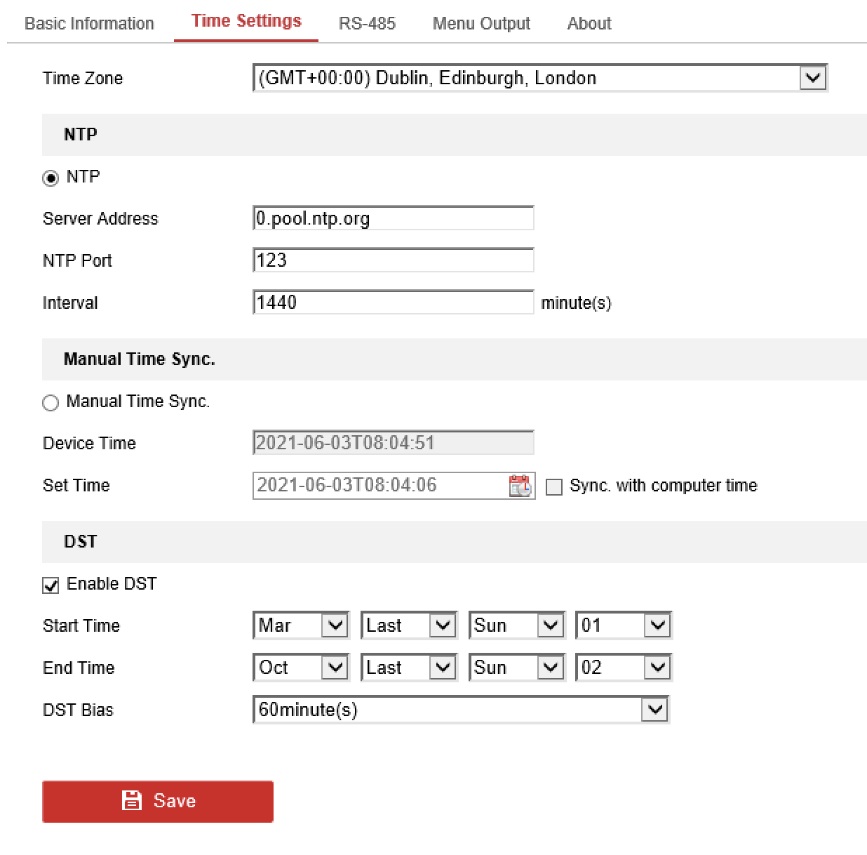

see below, check your cameras as well

It's not clear where you are seeing an incorrect time, do you mean on the camera feeds themselves? If so I believe the time shown on the camera on-screen display comes from the camera and not necessarily the NVR. However, I have found what works for me in the UK is:
1) Setting the NVR to use NTP and DST (exactly as David's second screenshot shows - the original screenshot DST settings I don't think are quite right).
and
2) Setting all cameras to the correct (GMT +0) timezone and use NTP. I do NOT set or enable DST on the cameras themselves.
This way the cameras seem to change DST correctly based on the NVR DST settings.
