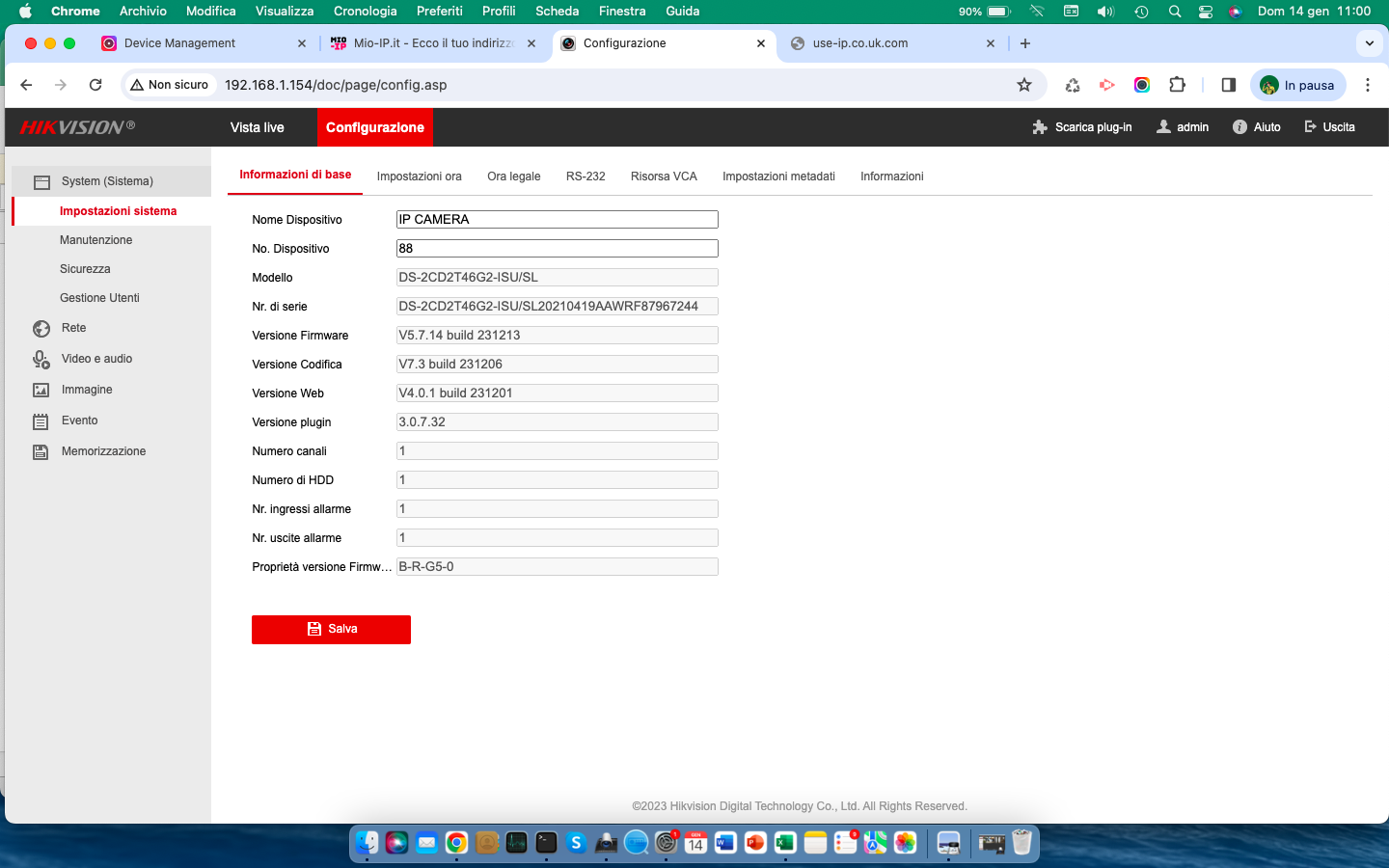

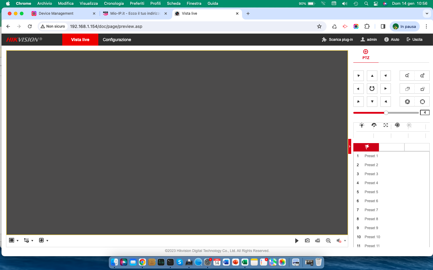

I did the update on my DS-2CD2T46G2-ISU-SL C camera and it happens that:
  • live View from browser is a gray page (I use PC Mac Air and Chrome browser)
  • on hik-Connect App live view OK
  • on ivms4200, live view OK
What happened?

Before the update I had the firmware V5.5.113_210317 and live view worked perfectly from the browser. I tried but I can't reload the previous firmware version. Can we go back to the previous firmware version and how?

The plugin is used for NVR viewing as well as viewing cameras directly in Edge/Chrome etc. I suggest you at least try it, clicking on the top right where it says "Download plugin". If I do not have it installed then I find viewing unusable in the browsers.
Once downloaded, you then just need to install it. It installs as LocalServiceControl.
I used an old notebook with windows 7, and live view works fine. So I fall into the ranks of losers who use Apple.

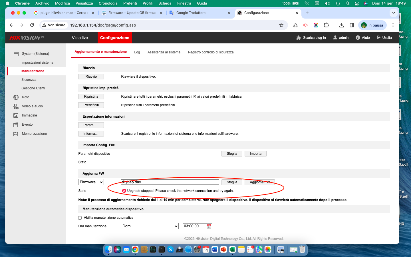

I tried to restore the previous firmware V5.5.113_210317 from notebook: it asks for the configuration password.
Can anyone tell me what it is?

Try installing the plugin(top right Scarica plug-in) as Juiceof2limes suggests twice.
Download, close browser and iVMS, install and then run browser again.
Some times you can just run and not download, but I think that it depends on your OS and browser if allowed to close all open window and restart.

I downloaded the LocalServiceComponents.exe plugin. It's a Windows file that I don't know how to get to work on my Mac Air.
It will be possible?
You can't, it's a windows file. There is no Mac equivalent and there's poor compatibility with Mac. That won't change.
In fact, I had read it in other threads. Now I would like to make sure that I cannot restore the previous firmware.
Do you know what the "configuration password" required during the firmware update could be?
Show a screenshot of where you're being asked for a 'configuration password'. The only password needed to access the cameras web interface is the admin password and that is something you or your installer created?
