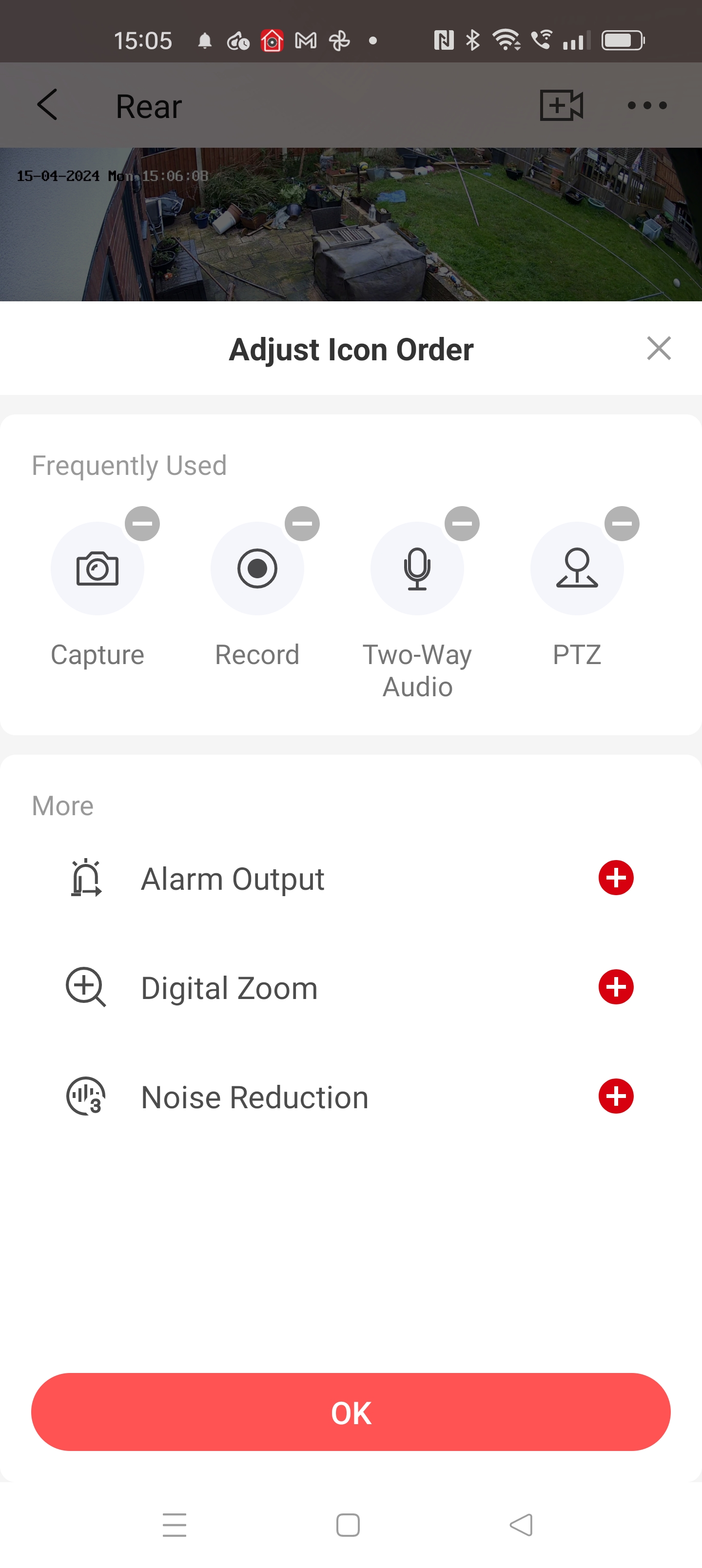

Hello, I have approximately 4 2387G2 Hikvision models which I am in the process of installing. Unfortunately, it appears as if the two way audio functionality is no longer working on my LSU variants. I'm attempting to figure out why, and was hoping I could get some help in troubleshooting this.
I'll specifically be focusing on two cameras out of my 4. They are each running the following firmware:
Camera 1: V5.7.13 build 230706
Camera 2: V5.7.3 build 220112

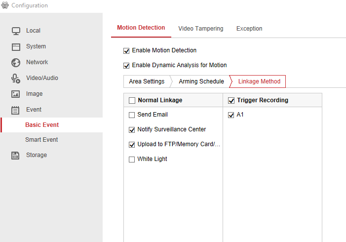

Camera 1 is an older camera in which I had experimented a fair bit with firmware options in a hope to get the LED lights to activate upon motion detection (the external white two). It has been a while since I last touched it due to frustration and downgrading lockouts with certain firmwares.
Camera 2 is a camera that I just unboxed today, with the factory firmware.
Both interfaces look the same to me, and I see absolutely no settings relating to 2 way audio anywhere in the web interfaces. I remember having 2 way audio briefly working with Camera 1, but I can't remember the exact cause as to why it stopped working for me.
- Is there anything I can do to try to test 2 way audio via the web interface? When I attempt to load the camera via https, the live view will fail on me - this doesn't happen over http.
- Is there a specific firmware that I should be on for these cameras? Any way to keep the white LED activation upon an event (motion, person detection, line cross detection, those things) while also having 2 way audio? I remember specific firmwares working and specific ones removing this functionality.
- I will eventually be using 2 way audio via ISAPI for these cameras - will that be over port 80? Is there any way to configure this port? I don't see any setting/configuration references to ISAPI within the web interfaces. I don't mind it being on port 80, but I'd just like to confirm that it is *actually* working for debugging purposes.
