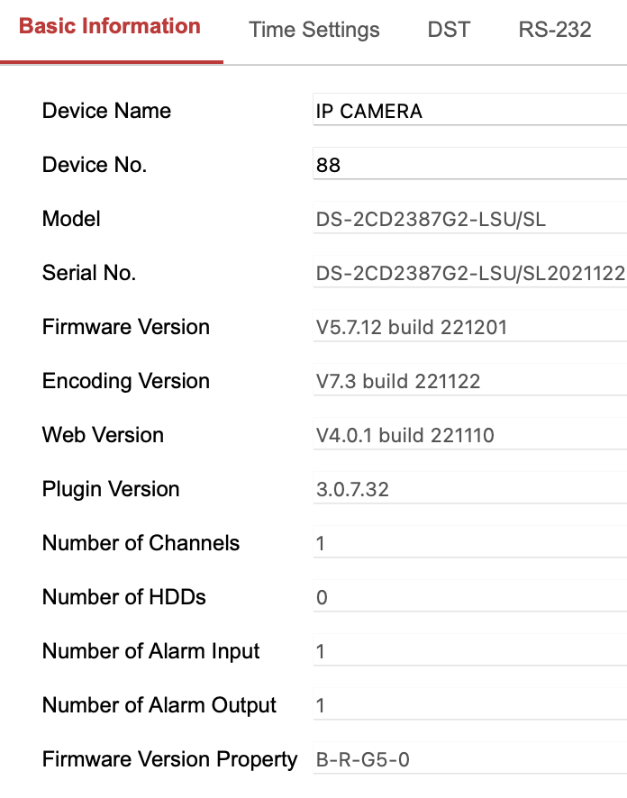

G2 cameras use G3 firmware for older non c cameras and G5 for the newer c cameras. The easiest way to check is to go into system settings of the cameras webpage menu and check the firmware version property at the bottom there. Below is a G5:

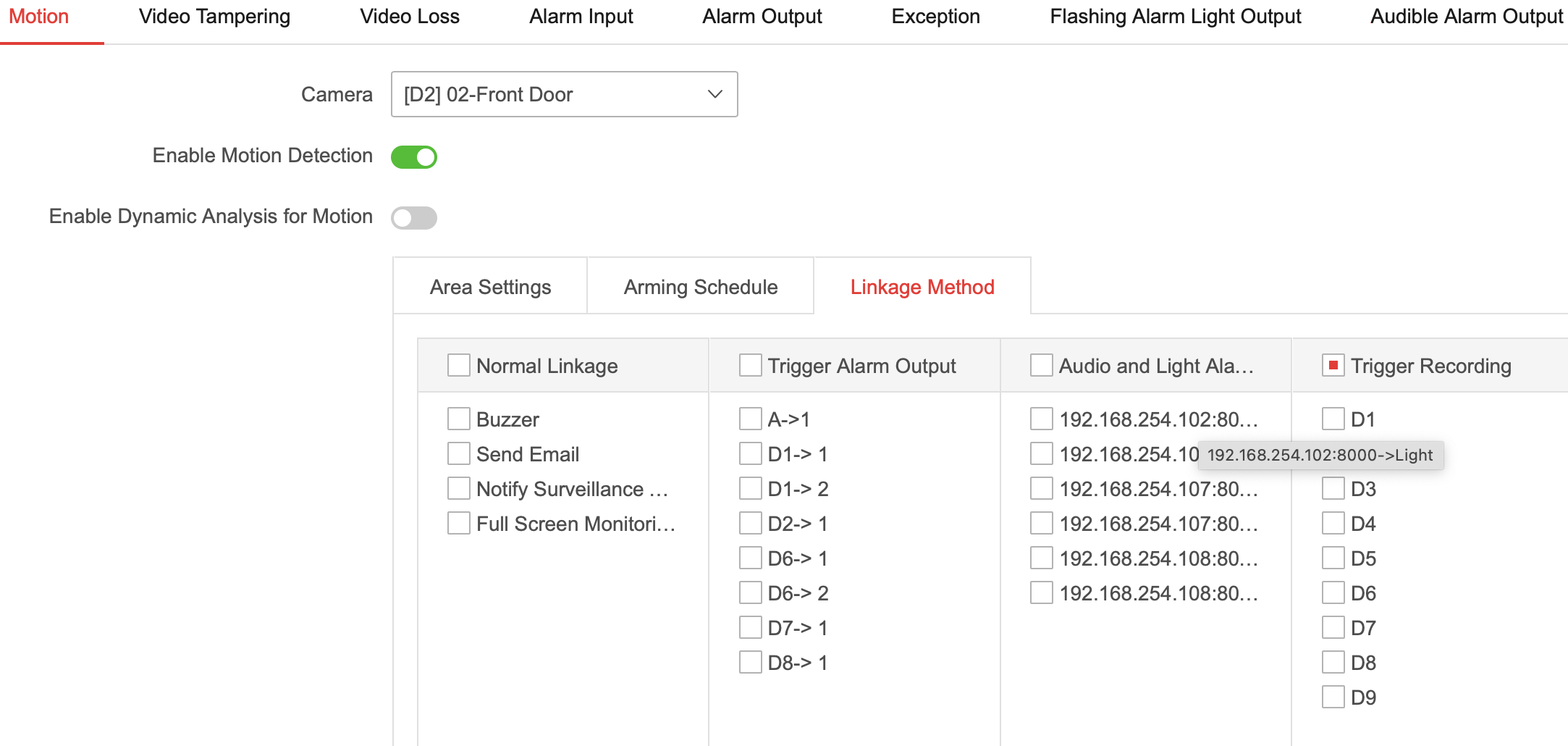

Yes I think you might be missing something. Each individual event (line crossing, motion, intrusion) on each individual camera has specific linkage actions. Whatever actions you want to link for an event on camera 1 are selected in that camera 1 event linkage actions only. You can set up an event to trigger audio and/or strobe on the camera where the event is set, or you can tick the boxes to trigger the alert on a different camera instead or as well as.
I don't use the audio and light alarm but as an example see the image below for my front door:
There are 6 entries for Audio and Light Alarm, one entry for light and one entry for audio on the three cameras of my system that have the speaker/strobe. I don't tick the top box as that would enable all and I'd get Strobe and Siren on all three cameras. I can select to have Audio and/or light only on this front door camera (.102), or I can select any combination from the available cameras. Whatever I select will occur when motion is detected on the front door camera. I can also schedule that motion detection event in the arming schedule or I can individually schedule when the strobe/siren is able to be activated (those can be scheduled per camera in the 'Flashing Alarm Light Output' and 'Audible Alarm Output' at the top.
