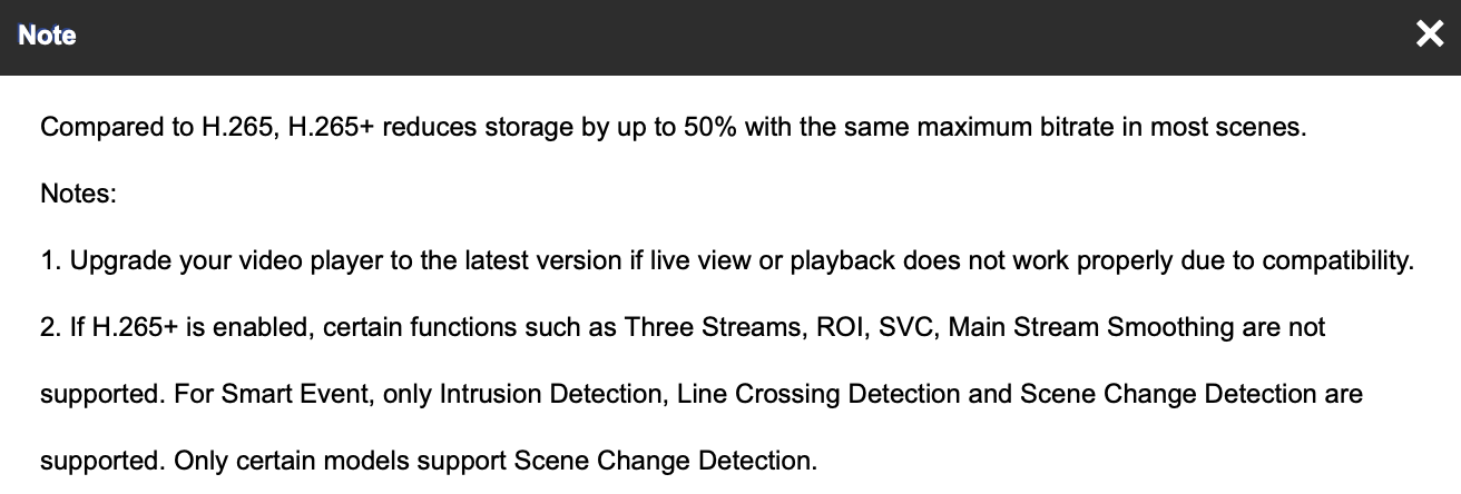

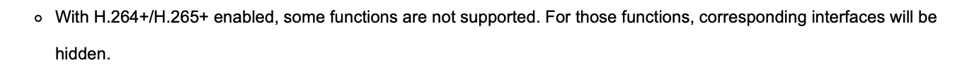

It looks as though ROI is not supported with H265+. This pop up appears when switching to H265+ on a G1 model:Hi Dan, thanks for reply
These are ColorVU DS-2CD2047G2-L and DS-2CD2047G2-H LIU both G5 Platform
Firmware is same for both of them and it is V5.7.14build 231028
Had not used H265+ encoding before.
Could this be because of the automatic I Frame Interval and/or wrong setting for Max. Average Bitrate?
