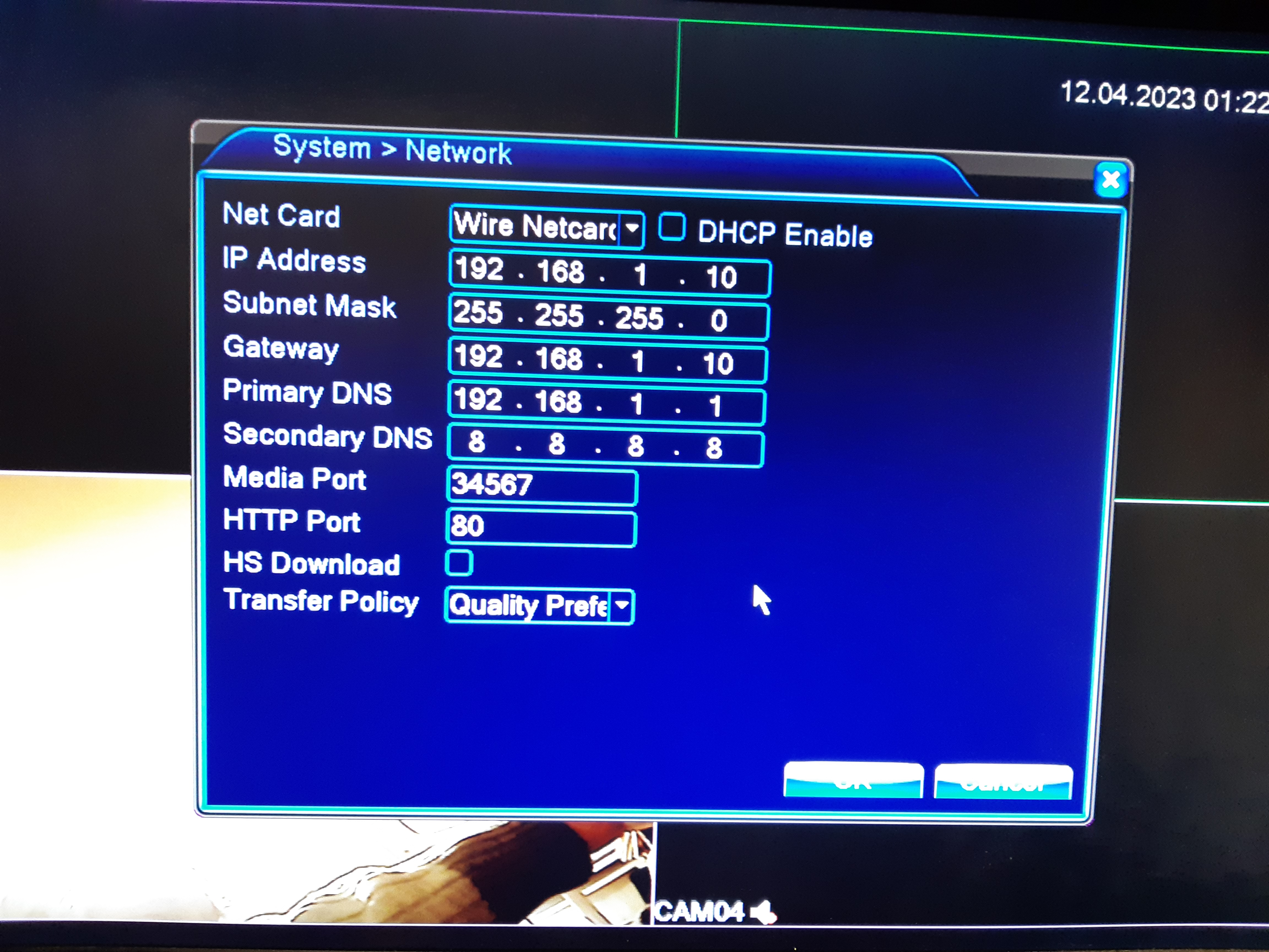

I have a flouren dvr that has 4 cameras connected to it. I have connected it to my router and can see the green led on and yellow led flashing on the socket on the dvr. I assume it is connected to the router.
The guide in the dvr software says it is using an ip address of 192.168.1.10 but when I use the test on the dvr it says there is a gateway error the gateway test failed.
The gateway says it is on 192.168.1.0. I changed it to 192.168.1.10 after it failed but retesting failed again.
I can see the camera pictures locally on a monitor connected to the dvr but when I go to 192.168.1.10 in chrome it just fails saying it has tried for too long. Does anyone know what else I can try or what I might do to get it to connect to the router?
I have a network extender near my computer and dvr that they are both connected into and the computer sees the internet so I know the connections are good.
All help would be appreciated.

The virgin hub default IP address is 192.168.100.1 so your DVR needs to join that network. Your software guide says the DVR IP address is 192.168.1.10 so is isolated from your current network.
From the monitor connected to the DVR goto network setup, send a screenshot of what that screen shows.

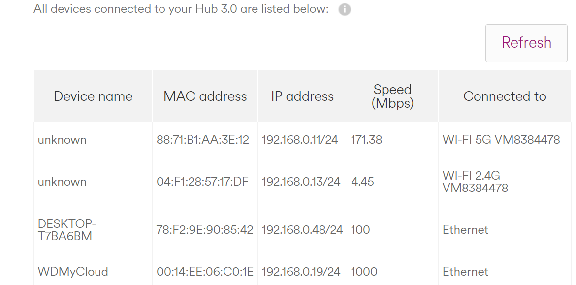

To get the Virgin hub details I enter 192.168.0.1, enter my password and get the virgin pages one of which is
Even with the DVR on or off?
It shows the desktop which is my other computer but that is also off (though I have seen motherboards with a light on when switched off but still connected to the network).
I have been altering the ip addresses in the following shot so they may not be defaults.
This is the shot you asked for
I did try altering the ip address in the second line above to 192.168.100.1 but my opera browser (the one I am using to send this) says it can't connect to that.

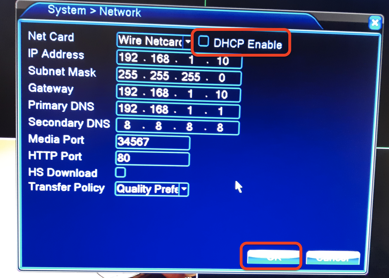

Hi Bob,
see my attached image and enable DHCP, click ok. You may have to restart the DVR. post another screenshot of the network page.
David

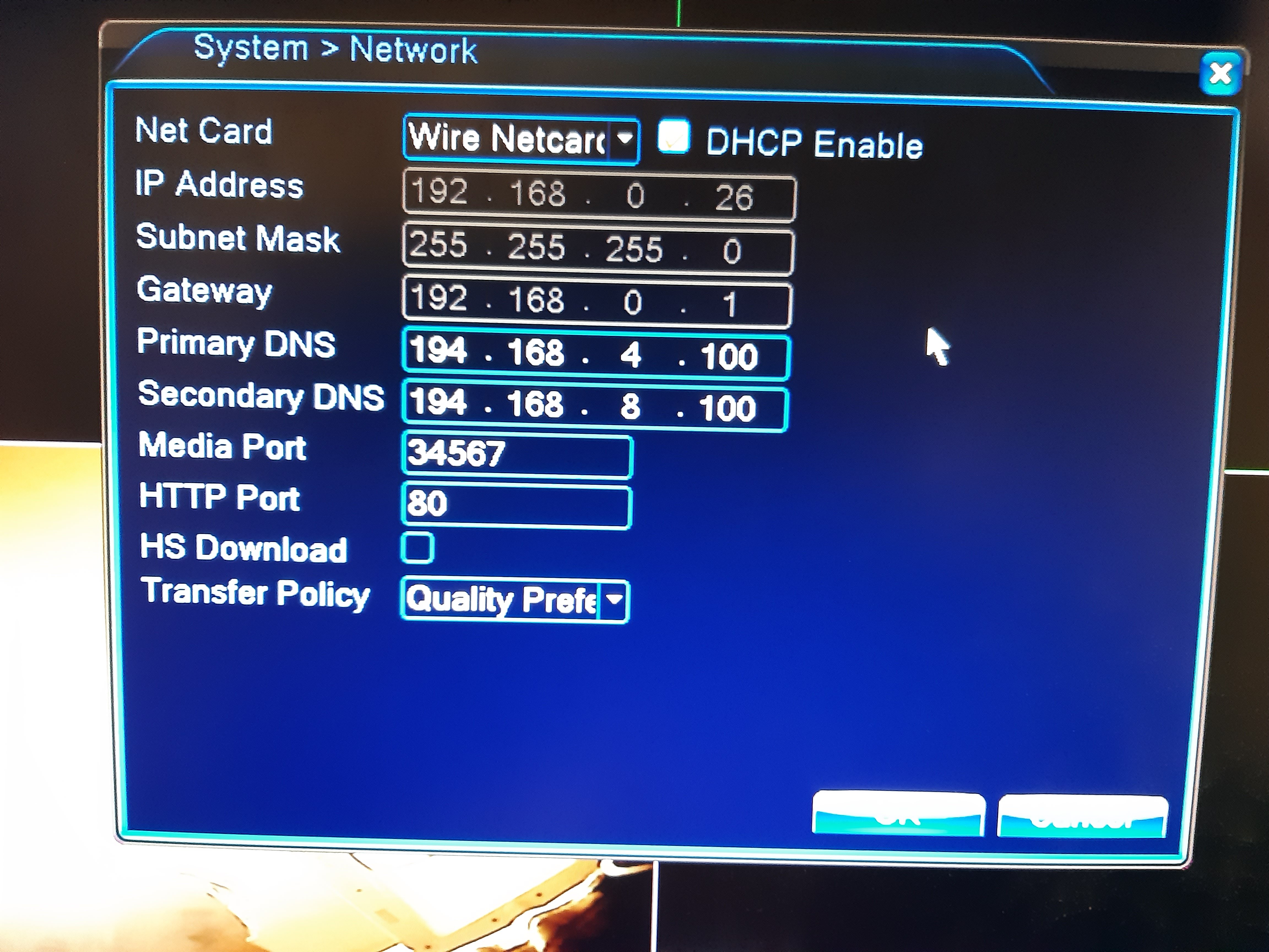

Is this the shot you want? I notice the DNS box numbers changed when I restarted the unit.
Bob

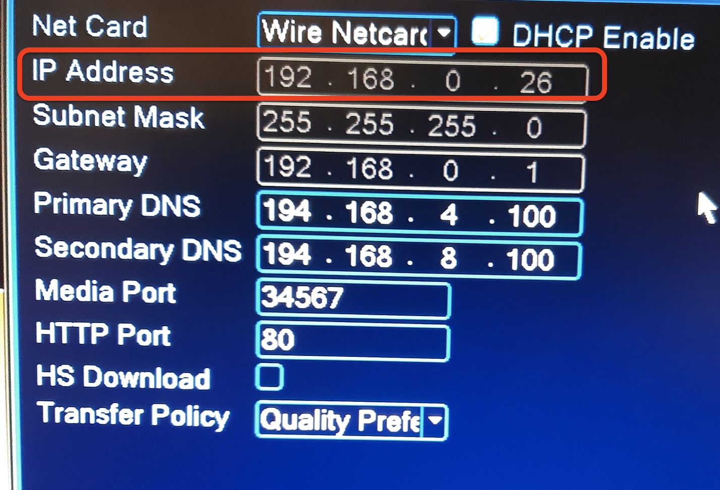

perfect.
From your computer browser you should be able to access the DVR web page via 19.168.0.26.
The DNS addresses are probably coming from your ISP.
David
